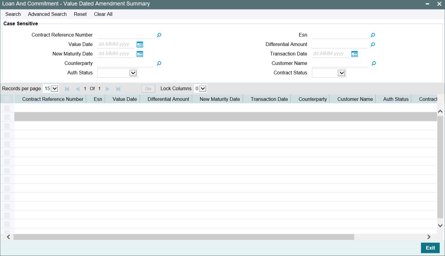

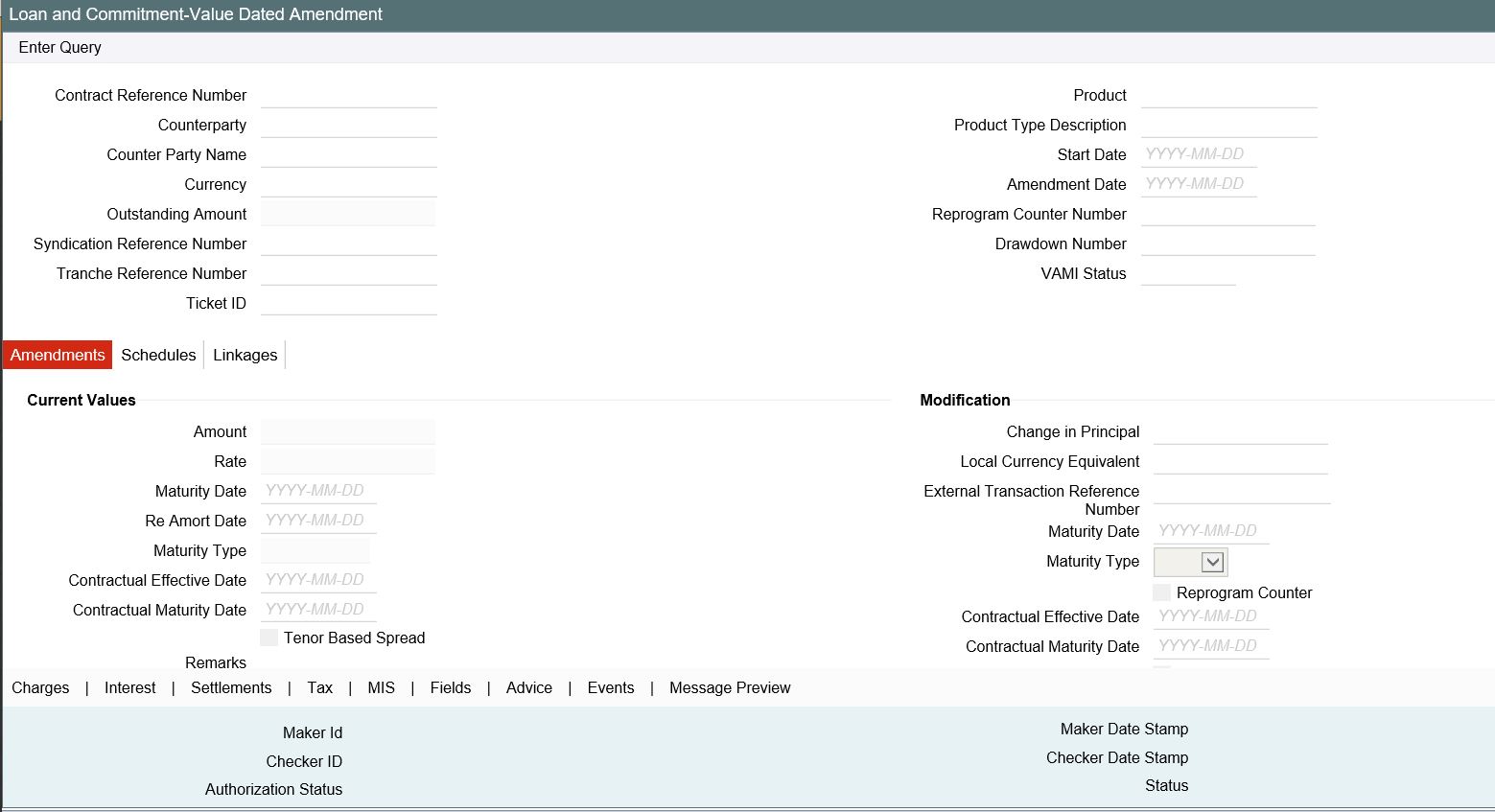

You can invoke the ‘Loan and Commitment - Value Dated Amendment’ screen by typing ‘OLDVAMND’ in the field at the top right corner of the Application tool bar and clicking the adjoining arrow button.
Enter the reference number of the loan to which you want to make amendments. The main details of the loan is displayed in the screen.

The ‘Ticket Id’ field is displayed only when the individual SLT trades get handed off to LS and then to OL (Origination). If the setup is to consolidate all the trades across the tickets for a CUSIP, the ticket Id is not displayed for any trade.

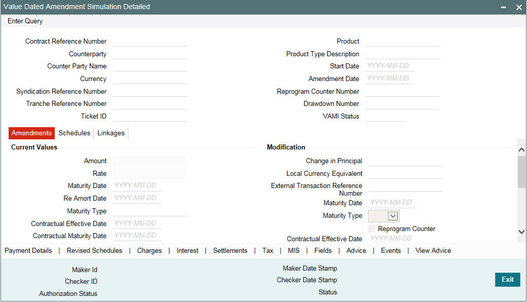

You can make an additional disbursement through the Value Dated Amendment function.
If you increase the principal amount, the increased amount is put into the last principal payment schedule. You, then, have to authorize the schedule, which the system has redefined to maturity. Only then you can define new schedules, as per your requirement, through the Contract Schedules screen.
For a loan, you can increase the principal through the Value Dated Amendment function. If you want to decrease the principal, you have to treat it as a repayment.

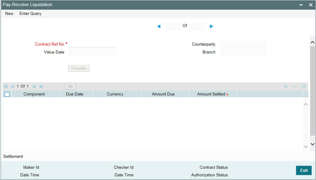

You can make payment on the value date and amendment can be done on the value date of the contract.

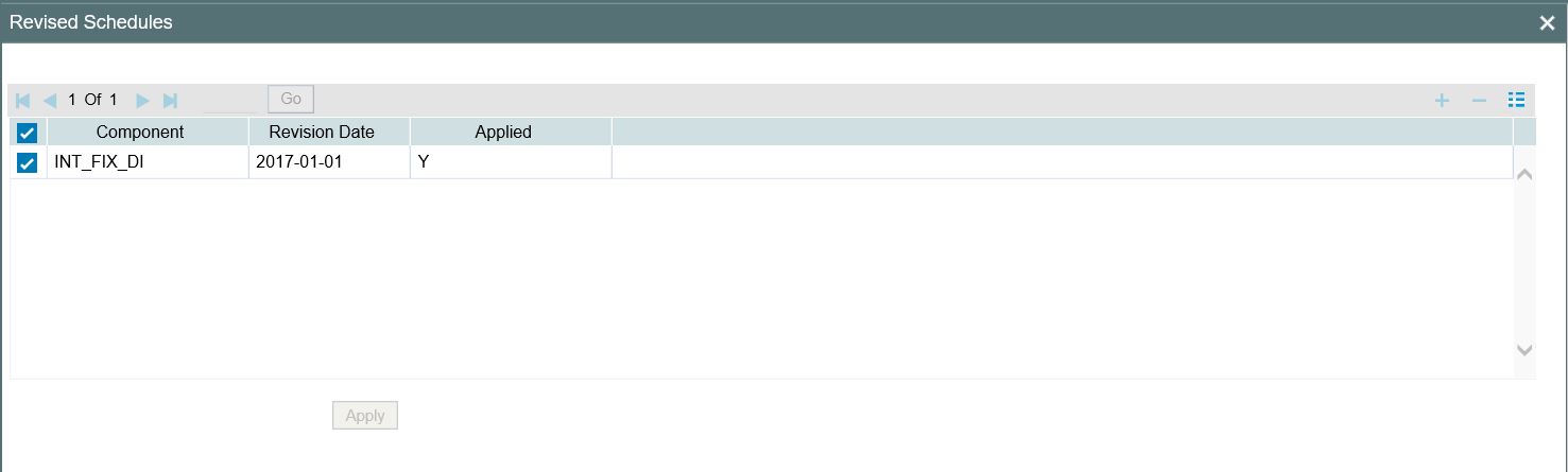

The schedule changes, which have come about as a result of value-dated changes, can be done through the Value Dated Amendments screen. For example, if the schedule change has come about following a change in the maturity date, you have to do this through this screen. Click on ‘Schedules’ in this screen.

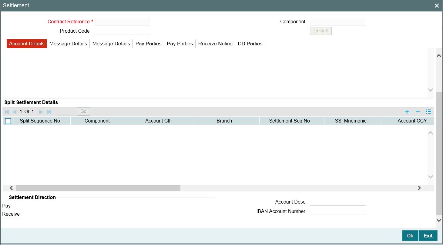

If you want to make changes to the settlement accounts and the currency conversion rates, you have to invoke the ‘Loans and Commitment - Contract Input’ screen and go to the ‘Settlements’ screen by clicking the ‘Settlements’.
For more information, refer to the Settlements User Manual.
The system amends the settlement instructions which are defaulted as a part of maintenance and the settlement accounts which are defaulted component (Amount Tag) wise.

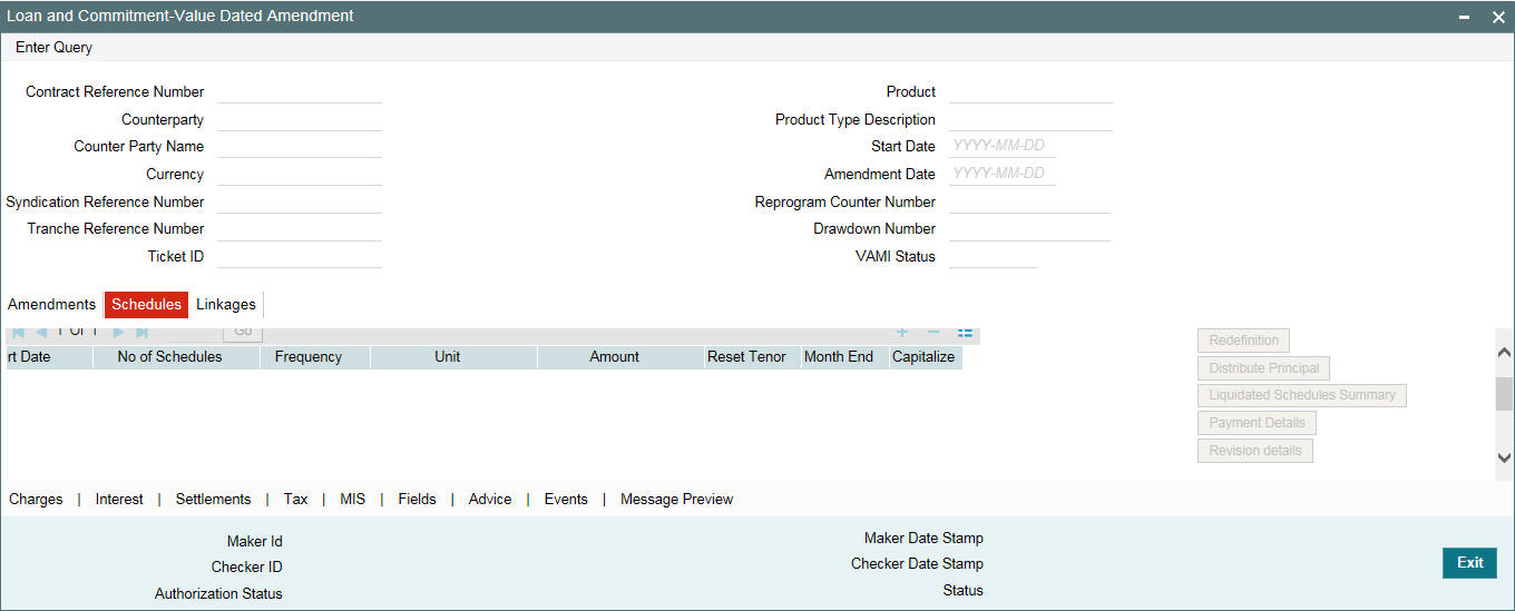

If there is any principal amount increase or maturity date change in the contract, you can distribute the amount equally among all the schedules and redefine the schedules from the amendment date till maturity date. You can do this using 'Distribute Principal' and 'Redefinition' button in 'Schedules' tab of 'Loan and Commitment Value Dated' screen.
In addition, you can use 'Default' button to default back to the original schedules as in contract and 'Liquidate Summary Schedule' button to view the overdue or liquidated schedules.

In case of Value Dated Amendment (VAMI), you can modify the schedules by selecting or clearing ‘Capitalize’ check box and then perform CAMD to increase ‘Interest Reserve Amount’. The system validates whether the interest reserve amount entered is not a negative value before saving the contract.
Capitalize due to Insufficient Funds
You can select the schedules and mark the 'Capitalize due to Insufficient Funds' check box which needs to be auto capitalized.
When you click ‘Payment Details’ button in this screen, you can see the ‘Payment Schedule Details screen’ similar to ’Loan and Commitment - Contract Input’ screen. Here you can view the details of the schedules for a particular contract. For more information, refer to ‘Revision and Repayment Schedules’ sub-section in Processing Repayments section.
When you click ‘Revision Details’, the changes made in the ’Loan and Commitment - Contract Input’ screen are displayed. For more information, refer to ‘Revision and Repayment Schedules’ sub-section in Processing Repayments section.

In Oracle Lending, you can authorize the value-dated amendments made on Loan contracts through the ‘Loans and Commitment - Value Dated Amendment Summary’ screen.
You can invoke the ‘Loans and Commitment - Value Dated Amendment Summary’ screen by typing ‘’OLSVAMND’ in the field at the top right corner of the Application tool bar and clicking the adjoining arrow button.
The authorization status of all unauthorized contracts is marked as ‘U’. The following stages of the contracts might be unauthorized:
To authorize the unauthorized contracts, double-click on the contract in the ‘Loans and Deposits Contract Summary’ screen. The screen that is displayed depends on the stage of the contract that is unauthorized.
In the screen that is displayed (based on the unauthorized stage)
click ‘Authorize’ to authorize
the contract.
If you double click on a contract for which the authorization status is marked as ‘A’, the ‘Contract Online’ screen is displayed.
The system reduces HFI balances on a pro-rata basis during VAMI event due to HFS transfer, if the box ‘HFS Transfer’ in the ‘Value Dated Amendment’ screen is checked. It computes pro-rata reduction of the following balances for individual loans based on the VAMI amount:
CoC balances are not applicable for LC loans. The box ‘HFS Transfer’ is not applicable for commitment VAMI.
You need to manually reduce FAS 114 unfunded reserve on a prorate basis during HFI to HFS transfer as part of internal HFI Sell trade processing.
The value dated amendment simulation screen is similar to ‘Loan and Commitment - Value Dated Amendment’ screen. Once the VAMI is saved in this screen, you can view the revised schedules and view the advice.
Value Dated Amendment simulation is used to view the impact on repayment schedules, tenor and maturity date after the VAMI.
You can invoke the ‘Value Dated Amendment Simulation Detailed’ screen by typing ‘OLDVAMSI’ in the field at the top right corner of the Application tool bar and clicking the adjoining arrow button.
You can track and liquidate the differences in the settled amount using ‘Pay – Receive Liquidation’ screen.
You can invoke the ‘Pay - Receive Liquidation’ screen by typing ‘OLDPRLIQ’ in the field at the top right corner of the Application tool bar and clicking the adjoining arrow button.
Note
In case of any Pro Rata VAMI beyond any Payment, it may result in the change in the settlement amount for the settled schedules. These differences in the settled schedules (both positive and negative) you can track under the payable and receivables and can settle the differences to the Pay-Receive Liquidation option.
Contract Reference Number
Specify the contract reference number whose list of components you want to display in this screen.
The following fields are displayed
Value Date
Specify the value date of the payment for the selected component. The value date of the payment can be either backdated or current dated.
Amount Settled
Specify the amount to be liquidated for the selected component.
