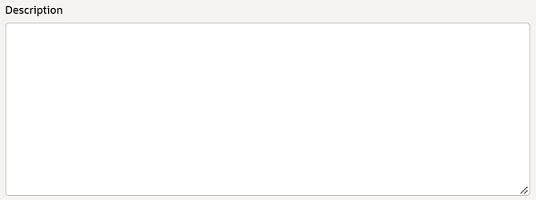

- Multi-line text
Use this element for multiple text lines for entries up to 4000 characters long, such as descriptions or remarks. You must also set the Data Size—the maximum number of characters.

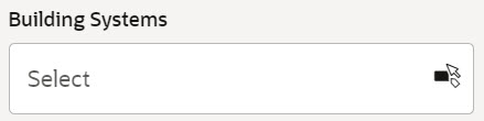

- Multi-select input
Allows the user to make multiple selections from a list. This input method automatically uses a comma as a separator between selections. The values for this definition are specified in Primavera Unifier when the business process, form, manager, or other component is set up.

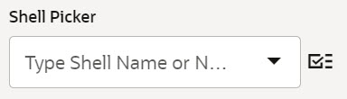

- Picker
Allows users to choose from lists of items. uDesigner and Primavera Unifier are shipped with a number of predefined pickers.

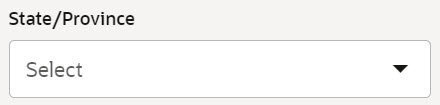

- Pull-down menu
Provides a list of items the user can choose from but cannot change. The values for the pull-down menu choices can be up to 128 characters long and are specified in Primavera Unifier when the business process, form, manager, or other component is set up.

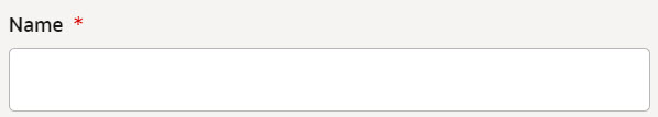

- Text box
Use a text box for a one-line alphanumeric text entry field, such as name or address. You must also set the Data Size—the maximum number of characters. A text box is usually used for smaller text (1 to 64 characters), but could be longer.
