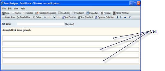

- In the Upper Form (or Detail Form) Design window, select an empty cell; then do one of the following:
- To add a custom data element, click the Add Custom button.
- To add a standard data element, click the Add Standard button.
- To add a linked data element, click Linked. See Adding Link Elements to a Form.

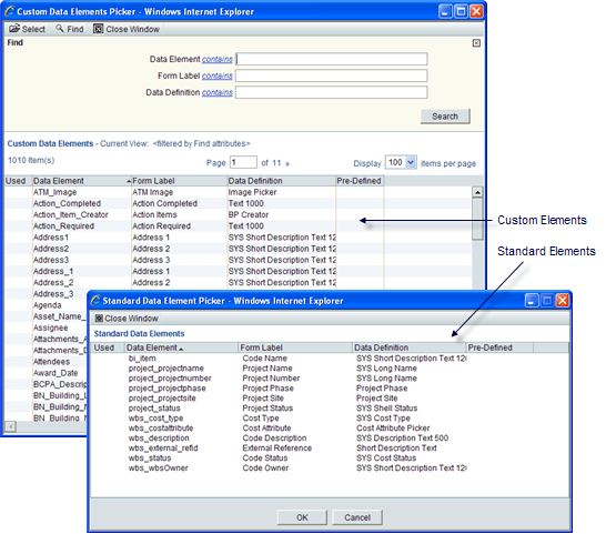

One of the following windows opens:
- Highlight a data element from the list and click the Select button on the toolbar. uDesigner adds the data element to the selected cell on the form and enters a check mark on the picker window in the Used column beside the data element.
To add multiple data elements at once, press the Ctrl key and click the element names.
Tip: Be sure there are enough empty cells to accommodate all the elements you have chosen. If you are short on cells, click the Insert Row button on the Designer window toolbar to add cells to the form. Then select the data elements.
The Data Element Picker window remains open, but uDesigner brings the Form Designer window to the front.

To find a specific data element
The list of data elements designed for your company can be large. To quickly display the element you want to use, you can use the Find feature at the top of the window. You can search for a data element by the element name, its form label, or its data definition. You can narrow each of these search options by using operators on the fields, such as "contains" or "is empty."
Note: Only the Custom Data Elements window includes a Find feature; the Standard Data Elements window does not.
- In any of the search fields—Data Element, Form Label, or Data Definition—click the underlined operator and choose the operator you want to use to narrow the search.
- If you have chosen any operator except "is empty" or "is not empty," enter the text the operator should look for.
- Click Search (or press the Enter key on your keyboard). uDesigner will list all the elements that meet the search criteria you entered.
How this Find Window Works
When you open the Custom Data Elements window, uDesigner assumes you will want to search for elements and displays the Find feature at the top of the window. You can close the Find area of the window at any time by clicking the x in the upper-right corner, and reopen it by clicking the Find button.
When you use the Find feature, uDesigner displays the elements it finds. If you close the Find area thereafter, the list will return to normal, showing all data elements. If you open the Find feature again, it will clear the list, assuming that you are going to enter more search criteria.
