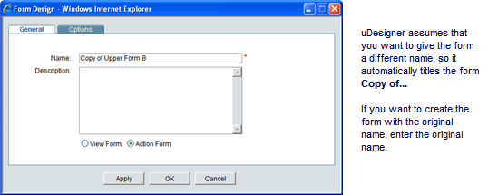

To create a new upper form from a snapshot
- Open the business process you want to work with.
- In the navigator, double-click Upper Form.
- Select New > From Snapshot. The Snapshot Log opens.
- Highlight the name of the snapshot containing the upper form you want to use and click Open.
uDesigner opens the form's Properties window.
- On the General tab, enter a name and description for the new form.
If this is to be a read-only form, click View Form, then click OK.
If you want the reader to be able to edit the fields on this form and include attachments or line items, click Action Form, then click Apply.
- Click the Options tab.
This tab displays different options, depending on the BP type you are creating. To complete the Options tab, use the instructions in the topic "Designing an Upper Form."
- Click OK.
uDesigner creates the new upper form and displays the name on the upper form log.

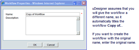

To create a new workflow from a snapshot:
- Open the business process into which you want to insert a new workflow.
- In the navigator, click Workflows. In the right pane, uDesigner displays a list of the workflows that have been created for this BP.
- Highlight the name of the snapshot containing the workflow you want to insert and click Open.
uDesigner opens the workflow's properties window.
- Enter a name and description for the new workflow and click OK.
uDesigner inserts the new workflow and displays the name on the workflow log.
