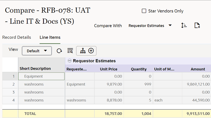

For the Request for Bid (RFB) business process, Primavera Unifier includes an bid tabulation feature. This feature provides a default comparison sheet with which Primavera Unifier users can compare the bids they receive from vendors.
The default bid comparison sheet (shown above) shows only the bid dollar amounts for each line item for which the vendor submitted a bid.
