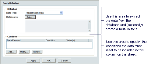

  2. In the Entry Method field, choose Query and click the Define button. The Query Definition window opens.
    Use this area to extract the data from the database and (optionally) create a formula for it. Use this area to specify the conditions the data must meet to be included in this column on the sheet.
  3. In the Data Type field, select the functional area of Unifier the data should come from.
    This field is the first step in describing where the data resides in the database. For example, the data type could be a Cost BP, a fund allocation request, or a cash flow.
  4. In the Datasource field, click the Select button. The Formula Creation window opens, showing a list of the fields from the data type you selected.
    You can drill down into the data type for other data sources if you wish by clicking the arrow beside this field and selecting other data source areas.
  5. (Optional) Create a formula using the field values in this data source, or field values and numeric operators, such as add, subtract, or multiply. Click OK to return to the Query Definition window.
  6. Specify the query condition as follows:
