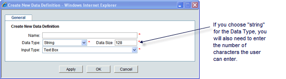

  5. In the Data Type field, specify whether the definition will be a string or integer data type.
    When you specify the data type, uDesigner displays an additional field, Input Type.
    If you choose string for the data type, you will also need to enter the number of characters the user can enter.
  6. In the Input Type field, select the method the user will use to enter the data.
