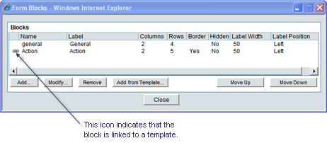

  7. On the Form Designer window, click the Blocks button. The Form Blocks window opens.
    The link icon indicates that the block is linked to a template.
