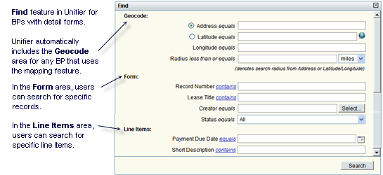

Specifying Search Criteria for the Find Feature
Primavera Unifier users will sometimes need to locate particular line items in a business process, often for the purpose of task management or milestone tracking. To make it easier for users to locate a line item, use the Find tab to specify field names on the form that they can use in their search. The user can also narrow a search by using operators on the fields, such as "contains" or "equals."
This image depicts the find window.
To specify search criteria
  1. Click the Find tab, then click Add. The Find Properties window opens.
  2. In the Data Element Label field, select a field (data element) users can use to find a line item.
    When you select a data element label, uDesigner automatically displays the database label of the element in the Find Label field. This field is editable.
  3. If you want to change the name of the element to something more meaningful to the user, enter the name in the Find Label field.
  4. Click Apply.
  5. To add another element for searching, repeat steps 2 through 4. Then click OK.
  6. On the Line Items window, click OK.
