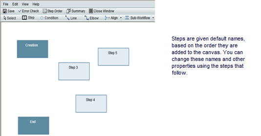

  2. To add a workflow step, click anywhere in the canvas area of the window.
    Steps are given default names, based on the order they are added to the canvas. You can change these names and other properties using the steps that follow.
  3. Continue to add as many steps as necessary by clicking the canvas again.
  4. When you have added all the steps, click the S Step button again.
