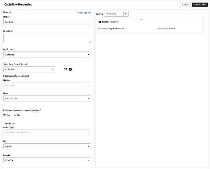

The Cash Flow Properties window is divided into two panes. The left pane shows the General block and the right pane shows the Curves block, as shown below.
This image displays the Cash Flow Properties window.
The following explains the components of each pane in detail.
