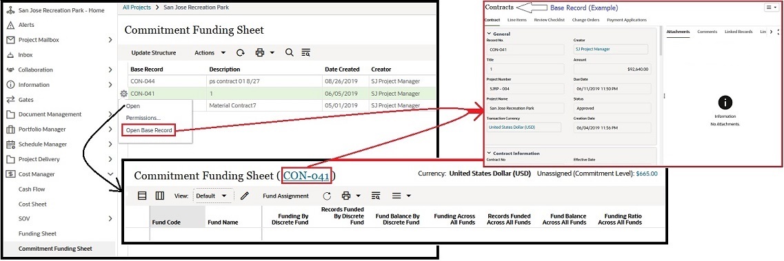

Opening a Base Record Business Process from Commitment Funding Sheet Log
You can open a base record BP by one of the following methods:
  1. Opening the commitment funding sheet and then clicking the BP link (<Base Record Name BP>) in title.
  2. Clicking on, or hovering over, a row (base record) to activate the gear menu and clicking Open Base Record.
This image displays a base record being opened from the commitment funding sheet log.

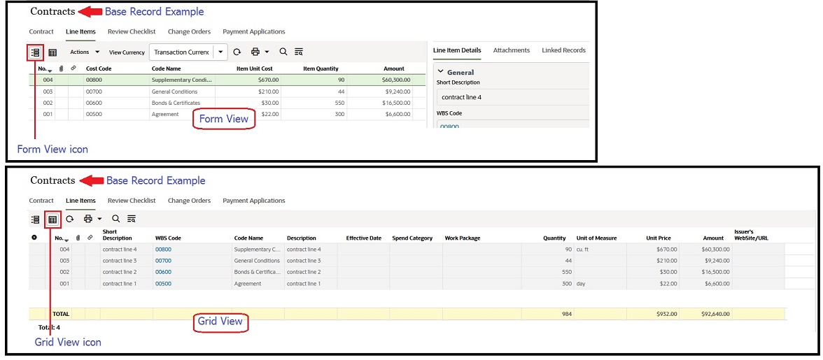

Line Items tab
  • Form View (Default view and read-only. See the image below for example.)
  • Grid View (See the image below for example. You can click on a WBS Code cell which has the code as a link and open the WBS Code window.)
  • View Currency drop-down (Your options are: Transaction Currency, Project Currency, or <currency>)
  • Refresh
  • Print
  • Search
  • Find on Page
Line Item Details tab
  • Attachments tab
  • Linked Records
This image displays the difference between the form view and grid view of line items within a record.
