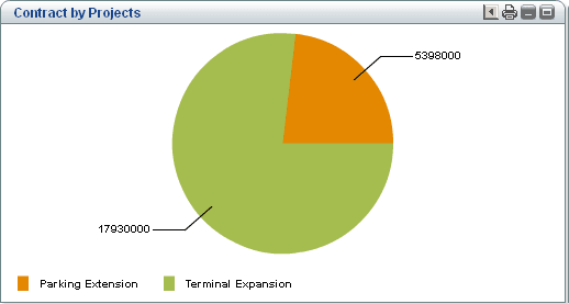

The pie chart below shows data for the following two projects (Contract by Projects):
- Parking Extension
- Terminal Expansion

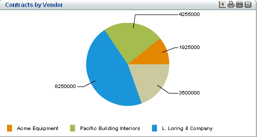

If you double-click on the pie chart for the Terminal Expansion project, then the amount associated vendors pie chart will display (greater levels of data detail), as shown (Contract by Vendor):
- Acme Equipment
- Pacific Building Interiors
- L. Loring & Company
