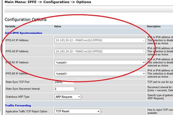

The alarm raises if IPFE IP addresses is configured incorrectly. img/5002.png

  1. To correct configuration errors:
    • Read and understand the alarm text. This should have sufficient information to diagnose the configuration error. As a last resort.
    • Navigate to IPFE, and then Configuration, and then Options.
    • Check the IPFE-A1 and IPFE-A2 IP address. You also need to check IPFE-B1 and IPFE-B2 IP addresses, if you have full 4 IPFE servers. You should select INTERNALIMI IP address here. All servers have to be the same IP type.
    • Check the State Sync TCP Port. We suggest you always use the default 19041, if possible.
