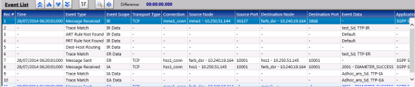

TTR Events Panel
The TTR Event Panel displays a list of all TTR events associated with the selected transaction (TDR). Whenever the user selects a TDR in the TDR Panel, the TTR Event Panel is refreshed with the corresponding TTR events. The Event table has a number of columns:
Figure 4-8 Event List Panel
img/event_list_panel.png
The user can also click Toggle Ladder Diagram to view events in an Event Diagram.

  • Transport Type (TCP or SCTP for payload events only)
  • Connection Id (The name of the connection defined in DSR)
  • Source Node (<Node name> - <IP address> for payload events; IP is translated and node name is displayed if there is a record in Local Node or Peer Node reference data at DSR for the given IP address)
  • Source Port (TCP/STCP IP port number for payload events)
  • Destination Node (<Node name> - <IP address> for payload events; IP is translated and node name is displayed if there is a record in Local Node or Peer Node reference data at DSR for the given IP address)
  • Destination Port (TCP/STCP IP port number for payload events)
  • Event Data (Event data from TTR event; Event Data for Answer payload events contains the result code from ResultCode AVP (code 268) or ExperimentalResultCode AVP (code 298) in the form of <Error Code> - <Error description>)
  • Application (Diameter Application for payload events, empty for the rest)
  • Command Code (Message command code in form of <Short name> - <Long name> for payload events)
  • Message Priority (The numeric priority value from the priority services field in the diameter message)
  • DSR-DSR (If the message transpired between two DSR nodes, then the column shows a YES value. If the message transpired between one DSR node and either a client (such as MME) or server (such as HSS), then the column shows a NO value. This value is required for N-IDIH to create a correct ladder diagram from the event list)
