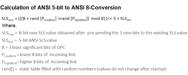

    If the above conditions are fulfilled, then only the new SLS value is calculated as per the following figure:
    Figure 2-12 ANSI 5-bit to ANSI 8-bit SLS Conversion
