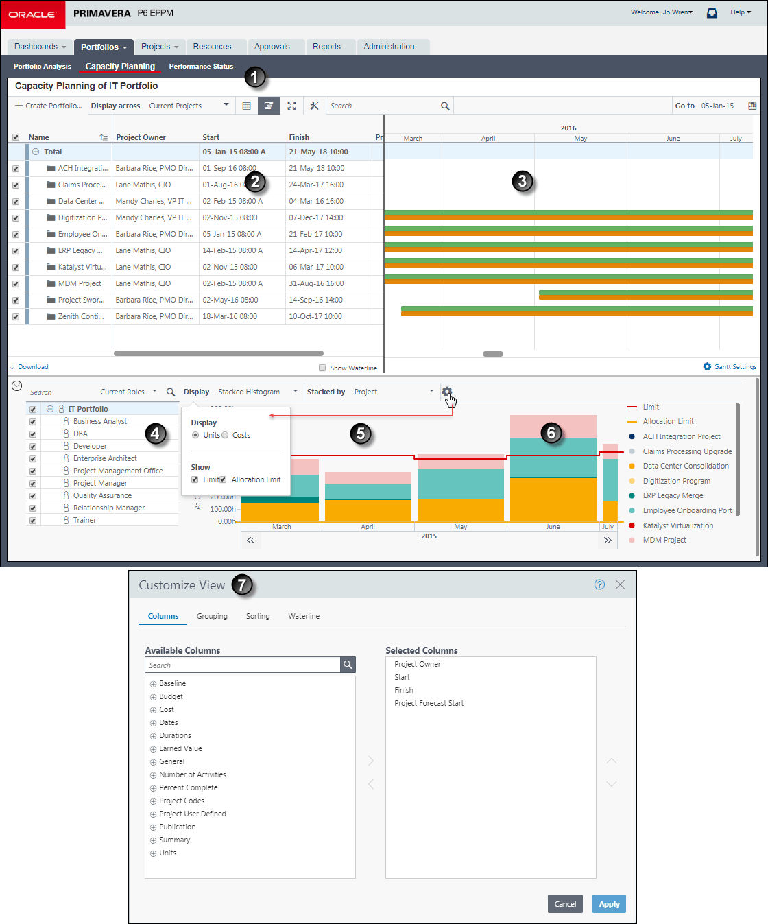

This illustration is a graphical representation of the text in the following table.
Table of Key Capacity Planning Page Elements
Item
Description
item one
Navigation: Before you begin, first open the portfolio you want to work with, then select Capacity Planning.
item  two
Scorecard: Use this table to analyze, sort, and select projects. Only the projects you select in the option column appear in the Capacity Planning chart.
Note: The scorecard on this page is not related to the set of defined portfolio view scorecards.
item  three
Gantt chart: View current and forecast schedules. Drag the bars to adjust the Capacity Planning chart data.
item  four
Role Selection Area: Select the options for the roles you want to include in the Capacity Planning chart.
item five
Capacity Planning Chart (Under Allocated): View role allocation as a stacked histogram, area chart, net availability chart, or spreadsheet.
item six
Capacity Planning Chart (Over Allocated): Customize the chart to show a limit line representing the maximum capacity of the currently selected roles by timescale period.
item seven
Customize Capacity Planning Chart: Customize the columns, grouping, waterline, or chart options.
Note: The net availability charts are often the best place to begin a resource capacity or demand analysis since they represent a streamlined birds-eye view. These charts include all related projects and roles in a single view allowing you to expand or drill down into only the roles with perceived problems.
