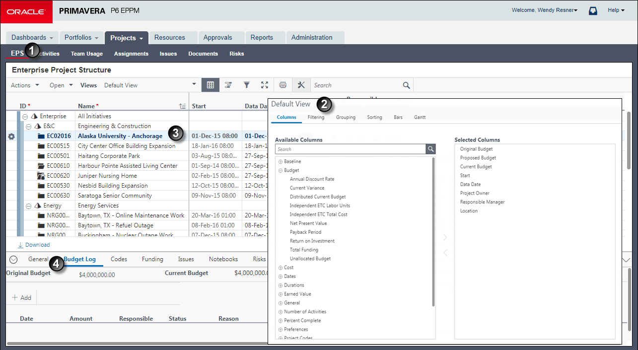

P6 facilitates a top-down budgeting approach to cost management. The resource/cost manager or other person responsible for making decisions about project launches generally establishes high-level budget estimates. These estimates are set for each EPS element. Project managers distribute the budgets to the projects for which they are responsible in each EPS element, as shown in the following example.
Once budget estimates are set at the EPS level, you can establish a monthly spending plan to keep track of cash flow for each node and project.

item one
EPS Page: Navigate to the EPS page in the Projects section.
item  two
Budget fields: Customize the EPS table by selecting the columns available under the Budget category. You can also configure an EPS view with these settings for easy retrieval when needed in the future.
item  three
Select a project: Select a project or EPS element and then click the Budget Log detail window.
item  four
Budget Log detail window: In this detail window, set the Original Budget. As the project life cycle continues, track budget changes within this same detail window.
