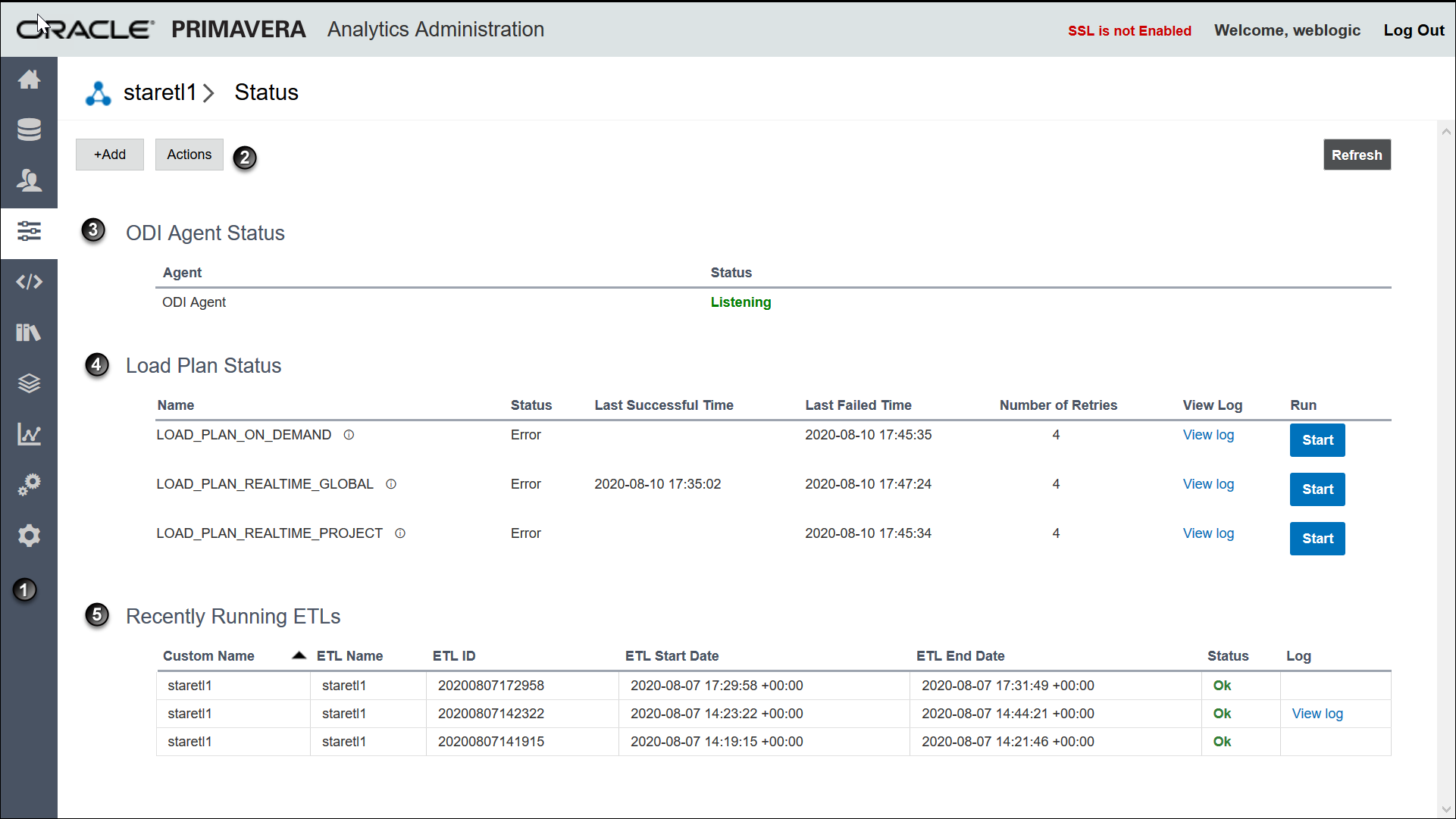

To bring data from P6 EPPM to CIC Advisor, you must run ETLs or ODI load plans from the Status page of the CIC Advisor Administration application.
To access the Status page for any data source:
- Sign in to the CIC Advisor Administration application.
http://<host>:<port>/p6rdb
- From the
Home
menu, select a data source.
Item | Description |
1 | Navigation menu: Select the following icons in the sidebar to use the interface:
2 | Add menu: Select this menu to select codes from an available list. Actions menu: Select this menu to schedule or run ETLs for the selected data source. Refresh: Select this button to renew the current view of the page. |
3 | ODI Agent Status: Displays the current status or mode of the ODI agent. |
4 | Load Plan Status: Displays the recent runs of ODI load plans that were run for this data source. Use this section to Start or Restart ODI load runs. |
5 | Recently Running ETLs: Displays the recent ETL runs for this data source. Select View log to review the log file for each ETL run. |
