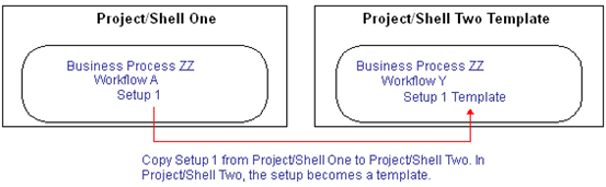

In this copy action, you copy a workflow setup from a business process in a project or shell and make it a template in the BP you copy the setup into.
Copy setup 1 from project/shell one to project/shell two. In project/shell two, the setup becomes a template.
