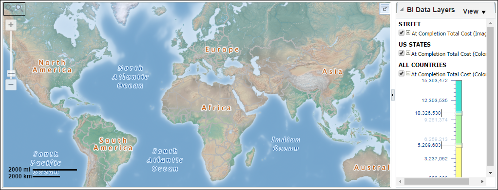

At Completion Total Cost By Location section map.
Purpose
The map shows At Completion Total Cost for all projects by country. White areas of the map indicate that no project is located in that area.
Switch off the At Completion Total Cost (Color Fill) option below ALL COUNTRIES to remove the shading when zoomed out to Country level. Switch off the At Completion Total Cost (Image) option below ALL CITIES to remove the shading when zoomed in to state level. Zoom in and out with the control on the left. Hover over a country, state, or province to see specific information or click on a country, state, or province to bring up a call out with specific information.
Location
  1. On the Home page, click Dashboards.
  2. Under Primavera, select Project Health.
  3. On the Project Health dashboard, click the Location page.
  4. On the Location page, expand the At Completion Total Cost by Location section.
