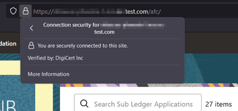

Download the Application Certificate
The Application Certificate is required for verification purposes when you use cURL commands. You may choose not to download the certificate if you plan to turn off the cURL Certificate Verification and use an insecure connection (if you add the --insecure Flag to the cURL command).
To download the Application Certificate, do as follows:
1.     Log in to the AFCS Application.
2.     Click the View site information/Verified by Icon in the Browser URL Address Bar.
3.     Select More information.
Figure: Certificates - More Information
4.     Click View Certificate and then click PEM(cert) to download the certificate.
Figure: Download PEM (cert)

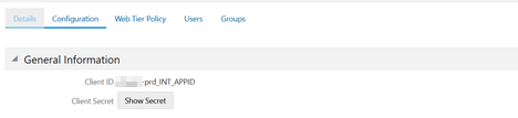

Get the OAuth Client ID and Client Secret
To get the OAuth Client ID and Client Secret, follow these steps:
1.     Enter the IDCS URL in the Browser's URL Address Bar.
The Oracle Cloud Account Sign In Window appears.
2.     Log in to Oracle Identity Cloud Service (IDCS).
3.     Select the Navigation Icon to view a list of available functions.
4.     Select Oracle Cloud Services.
For more information, see Access Service Consoles from Administering Oracle Identity Cloud Service.
5.     From the Oracle Cloud Services Window, select the required AFCS Internal Application Service (in AFCS <tenant-id> INTERNAL Format) from the list.
Figure: AFCS <tenant_id> INTERNAL
NOTE:
If the AFCS <tenant-id>INTERNAL Applications are not available, select AFCS <tenant-id>.
6.     Click the Configuration Tab.
The Client ID and Client Secret Details are displayed in the General Information Section.
Figure: Client ID and Client Secret
7.     Copy the Client ID and Client Secret.
