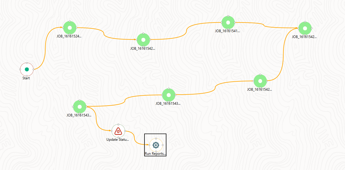

A Run Process is used to create a Run Definition in Rule Run Framework (RRF) using Process Orchestration Process. Visual representation of the Run is enabled through Process Orchestration by the construction of a Run Pipeline. Various Widgets that enable the construction of a Run Pipeline are available in the Component Toolbar.
Figure: Run Pipeline Example
1. Click the Add Button in the Process Modeller Summary Window.
2. Enter a Process Name and Process Description. The Process ID is a system-generated unique value.
3. Select the appropriate package from the App Package ID drop-down.
4. Select Run Pipeline from the Type drop-down list.

The Process Flow Canvas is displayed.
7. By default, the START Activity from the Toolbar appears, which indicates the beginning of the Process.
You can construct a Run Pipeline using only Widgets.
