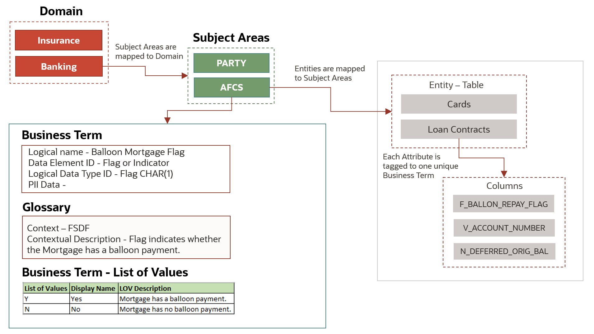

Domain
A Domain represents the category of the Business in the Finance Industry.
Data Catalog consists of the Data Catalog Framework and Seeded with Contents related to a specific Line of Business or Industry, which is referred to as a Domain.
In OFSAA, you can select the required Domain. For example, Banking, Insurance, and so on.
By selecting the Domain Name, you can restrict viewing the Catalog Components only to the intended Domains and deploy the Data Model also selectively.
Subject Area
A Subject Area represents a high-level data organization, which belongs to a group of related areas within a specific functional area of a Finance Organization.
Entities are grouped together into distinct Subject Areas based on the business functions or processing supported for a better identification and usage.
The relationship type between Domain and Subject Area is Many-to-Many.

Entities
Each Business Term is related to an Entity of the Data Catalog. The Entities consist of Attributes. The Data Quality Rules are built for the Entities, so that the System Input Data can be verified and validated.
The Entities support data movements to ensure that when the Input Data is staged, standardized, and processed, there is a mechanism to move that data into the Cells for analytical consumption.
Properties
Entity consists of a set of Attributes. Each Attribute is mapped to a unique Business Term. Each Attribute derives its characteristics such as Data Type, Constraints, and so on from the Business Definitions.

Business Term
A Business Term is a Functional Keyword that represents a unique functional aspect of the Financial Artefacts (Entities and Attributes). There is a business meaning to each Financial Artefact, and therefore, a business name is created in the form of a Business Term. Then the Business Term is used to find and fit into a purpose of different contexts. Therefore, Business Terms are expressions of the Participants/Actors, their Activities, and requirements conveyed in common business.
The approach to arrive at the Logical View of the Physical Model has inverted in the Data Catalog. Contrary to the previous practices, first the Functional Keyword or Artefacts are identified, collated, and then expressed in common business language, and then the corresponding Physical Model is developed.
Multiple Business Terms are a part of each Subject Area. A Business Term is a singular term irrespective of multiple places it appears in and the Business Term will have a recognizable naming pattern.
Metadata is attached to the Business Terms.

For each Business Term, there is a corresponding Glossary. The Glossary explains the meaning and purpose of each Business Term, which is the context. The Glossary consists of the information such as description, usage, sample values, and usage examples of the Business Terms.
Business Term List of Values
Data Catalog defines and seeds the List of Values for all the Business Terms that are Flags. The List of Values help you with data sourcing and creating Data Quality Checks.
Table: Example of Business Term List of Values
List of Values
Display Name
List of Values Description
Y
Yes
Mortgae has a balloon payment.
N
No
Mortgae has no balloon payment.
