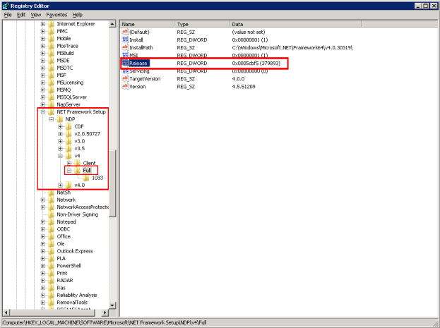

  1. To verify .Net 4.5.2, select Run from the Start Menu.
  1. Type regedt32. Click OK. The Registry Editor will open.
  1. Browse to HKEY_LOCAL_MACHINE - >SOFTWARE -> Microsoft ->.NET Framework -> Setup -> NDP ->v4 -> Full.
  1. The release number should read 379893. If the number is smaller or the Full folder is not present, .NET 4.5.2 has not been installed. Make sure to look at the v4 folder. DO NOT look at v4.0.
  1. If .NET 4.5.2 is installed, close out the registry and continue.
  1. If .NET 4.5.2 is not installed, you must install before you can continue. .NET 4.5.2 must be installed prior to running the Insbridge installation. .NET 4.5.2 requires .NET 3.5.1 features to be installed prior to installing .NET 4.5.2. Make sure .NET 3.5.1 is installed prior to installing .NET 4.5.2.
