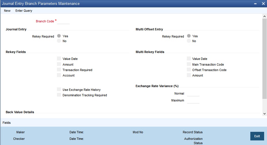

You can invoke the ‘Journal Entry Branch Parameters Maintenance’ screen by typing ‘DEDBRCON’ in the field at the top right corner of the Application tool bar and clicking the adjoining arrow button.
Click new icon. You can now maintain the branch conditions for your branch.
Branch Code
Select the branch for which you are maintaining the parameters.
Journal Entry and Multi Offset Entry
You can specify the values that the authorizer of a transaction has to rekey when authorizing it.
All operations on a transaction (input, modification, etc.,) have to be authorized:
l By a user other than the one who carried out the operation
l Before you can begin the end-of-day operations
When you invoke a transaction for authorization—as a cross-checking mechanism to ensure that you are calling the right transaction—you can specify that the values of certain fields should be entered before the other details are displayed. The complete details of the transaction will be displayed only after the values to these fields are entered. This is called the ‘re-key’ option. The fields for which the values have to be given are called the ‘re-key’ fields.
If no re-key fields have been defined, the details of the transaction will be displayed immediately when the authorizer calls the transaction for authorization. The re-key option also serves as a means of ensuring the accuracy of inputs.
You can specify the values of Journal and Multi-offset transactions that the authorizer should rekey in this screen.
Under Journal Entry (on the top left corner) and Multi-Offset Entry (top right corner), you will find the following option: Rekey Required Under this option you will see two buttons against ‘Yes’ and ‘No’ respectively.
Click on the button against Yes if you want the authorizer of journal transactions to rekey values. Similarly, click on the button against Yes if you want the authorizer of multi offset transactions to rekey important fields.
Click on the button against No, in these fields, if you do not want the authorizer to rekey values at the time of authorization.
Re-Key and Multi Rekey Fields
Under Journal Entry and Multi Offset Entry respectively, you will see a list of re- key fields. Check against the fields that you want to be re-keyed at the time of authorizing for Journal and Multi Offset entries.
The fields that can be re-keyed for journal entries are:
l Value Date
l Amount
l Transaction Required
l Account
The fields that can be re-keyed for multi offset entries are:
l Value Date
l Main Transaction Code
l Offset Transaction Code
l Amount
The advantages
The ‘Rekey at authorization’ facility is a cross-checking mechanism, which has been provided in Oracle FLEXCUBE. By rekeying the values of a transaction the authorizer can ensure that a transaction is error free.
For instance, you have debited a sum of $100 USD from a customer account. The account number of the customer is USDUS100003D. The Value Date of the transaction is 20/12/99.
The authorizer of the above transaction will have to rekey, for example, the Account Number of the customer; the Amount of the transaction; and the Value Date of the transaction if you have indicated that these values have to be rekeyed at the time of authorization.
By doing so the authorizer can ensure that the transaction is error free.
Exchange Rate Variance (%)
You can maintain exchange rate variation limits for Journal and Multi offset transactions. When you input a Journal transaction, the exchange rate (which you maintain at the beginning of day in the currency table) will be applied. This is referred to as the default exchange rate.
However, for a special customer or in special cases, you may want to use an exchange rate that is greater than the default exchange rate. In this field, you can specify the maximum and minimum percentage difference of the special rate from the default rate. In other words, you can specify the Maximum and normal Exchange Rate Variance.
Note
When you enter a transaction, the system will not seek an override if the Exchange Rate that you choose to apply is lower than the Minimum Exchange Rate Variance specified in the Minimum Exchange Rate Variance field. If the Exchange Rate is between the Minimum and the Maximum Exchange Rate Variance defined, the system will display an override message. The system will not store a transaction if you apply an Exchange Rate that is more than the Maximum Exchange Rate Variance defined.
Local Currency Equivalent Variable Limit
Another parameter that you can define for Teller and Journal type transactions, in this screen, is the LCY Equivalent Variance Limit.
When a teller enters a transaction (Teller/ Journal/ Multi offset) she can change the local currency equivalent for the transaction (if it is a foreign currency transaction). The input in this field determines the variance in number of units (note NOT percentage) between the default value and the value changed.
Use Exchange Rate History
Often you may enter back dated transactions. That is, you may enter a transaction date that is earlier than your current system date. On such a transaction a teller may want to apply the exchange rate that prevailed on the transaction date. This rate must be retrieved from history.
By clicking on the box adjacent to ‘Use Exchange Rate History’ you can indicate that you would like to apply the exchange rate from history on back dated transactions. If you do not choose this option, the Spot Rate (maintained for the day on which the transaction is entered in the system) will be used for the transaction.
For example, if the default equivalent of a FCY transaction is 120 units in the LCY and the allowed variance amount that you have specified is 10 units in the LCY, then the LCY equivalent if changed should be between 110 and 130 units.
Denomination Tracking Required
You can opt for tracking denominations for data entry transactions by checking the ‘Denomination Tracking Required’ checkbox.
Back Value Details
You can post back value dated transactions in Oracle FLEXCUBE. However, for the purpose of risk tracking, you can specify a limit beyond which users will be prevented from posting a back value dated transaction in the system.
Back Valuation Check Required
Check against the option ‘Back Valuation Check Required’ if you want enable back value dated transactions.
Back Value Days
You then need to specify the number of days to which a transaction posted by a user can be back-valued dated in Oracle FLEXCUBE. If a user specifies a date that does not fall within the back value days limit (measured in calendar days i.e. this period is inclusive of holidays) maintained here, the system will display the error message as “The value date is earlier than the Permitted value days.”
l If the message is configured as an ‘error’, you will not be able to proceed with the transaction, until you specify a date, which is within the limits maintained.
l  If the message is configured as an ‘override’, you will be able to proceed with entering the transaction, but an override is logged into the database, that the date specified does not fall within the limits maintained.
l If it is configured as a ‘ignore’ message, then no back-valuation check will be performed.
The same validations are carried out for transactions that are uploaded from external systems.
Note
You will be allowed to specify the ‘Back Value Days’ only if the ‘Back Valuation Check Required’ option is checked. If the option is not enabled, the system will allow you to post back-valued transactions upto any date in the past (no check will be done). Further, if the option is checked but you have not maintained the ‘Back Value Days’ (maintained as NULL), the system will interpret it to be ‘Zero’ days allowed (for back valued transactions).
This Functionality will be available for your branch only if the ‘Denomination Track­ing Required’ functionality is not enabled for your branch.

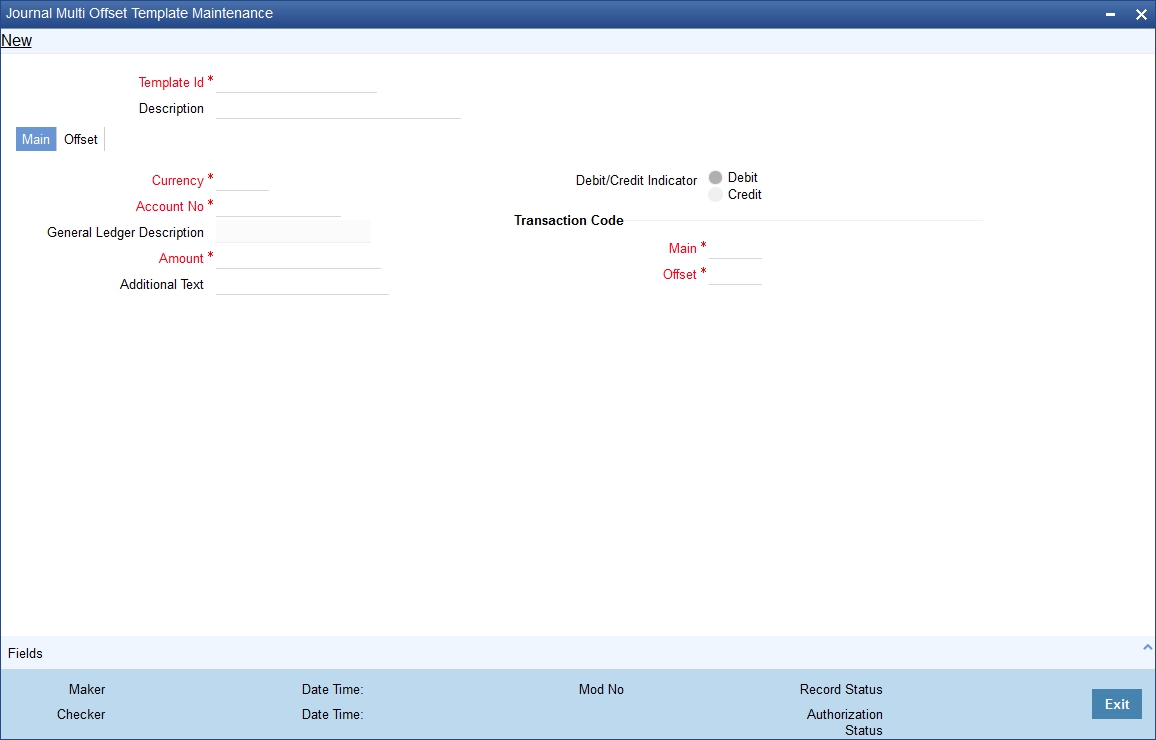

3.2.1 Maintaining Journal Multi Offset Template
If a transaction involves one debit entry and multiple credit entries (or one credit entry and multiple debit entries), it may be referred to as a multi-offset entry transaction. In other words, a multi-offset transaction is one in which multiple accounting entries are passed (to the offset accounts) to balance a single entry
You can maintain templates that can be used for processing multi-offset transactions. The attributes of the templates will be defaulted to the transaction thereby minimizing the time and effort required to process such transactions.
You can invoke the ‘Journal Multi Offset Template Maintenance’ screen by typing ‘DEDMJTMT’ in the field at the top right corner of the Application tool bar and clicking the adjoining arrow button.
Specify the following details:
Template Identification and Description
Specify a unique id to identify the template throughout the system. You can also capture a brief description of the template being maintained.
3.2.2 Main Tab
Account Number and Description
Select the account number and the description for the template. All the account numbers that are maintained in the branch are available in the option-list provided. The entry passed to this account will represent the main leg of the multi-offset transaction.
On selection of the account number, the associated description is displayed in the next field.
Currency
The currency of the account number that you have entered (in case of a customer account) is displayed here. However, you are allowed to maintain a different currency. All the valid currencies in the branch are available in the option-list provided. You can select the appropriate currency from the list.
Amount
In this field, enter the amount of the transaction. The amount that you enter here will be considered to be in the currency that you select in the previous field.
You must also indicate whether the amount is to be credited to the account or debited from the account. To do this, you must select either ‘Dr’ or ‘Cr’, depending on the nature of the entry.
Additional Text
You can capture any additional remarks regarding the template in this field. This is a free format text and is used only for information purposes.
Debit/Credit Indicator
Debit Credit Indicator defines if the template is being maintained for Debit or Credit. In the Main Tab you can give an Account, from that account if you mark as Debit, the amount will be debited. Under the Offset tab those are the accounts which you credit for this debit in main account.
Transaction Code
A transaction code is used to identify the nature of the entries that are passed. You can specify a transaction code for the main leg of the transaction as well as for the offset entry.
An option-list consisting of all the valid transactions maintained in your branch is provided for each field (Main and Offset). You can select the appropriate transaction codes from this list.

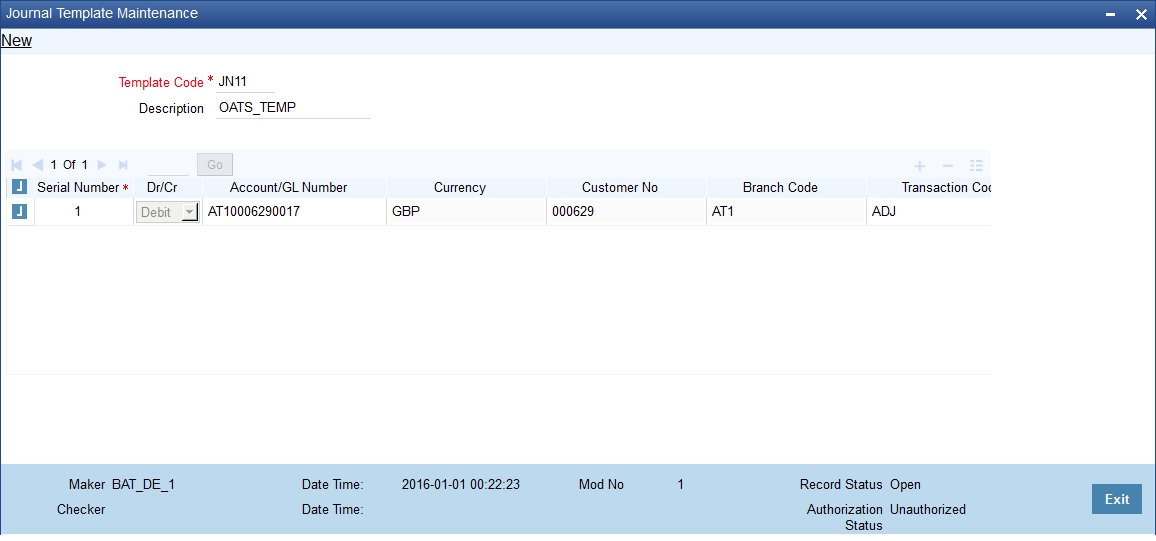

3.3.1 Maintaining Journal Template
The journal entry template for multiple debits to multiple credits can be maintained in the ‘Journal Entry Template Definition’ screen. You can invoke this screen by typing ‘DEDJNLPR’ in the field at the top right corner of the Application tool bar and clicking the adjoining arrow button.
In this screen, you can enter the following details:
Template Code
Enter a unique journal template code.
Description
Enter a brief description about journal template.
Sl No
By default the system generates the serial number, starting from 1.
Dr / Cr
You can indicate whether the amounts entered in the online screen is debited or credited by selecting one of the option given below:
l Debit
l Credit
Account/GL Number
Specify the account/GL number for which the template is defined. The adjoining option list displays all valid accounts and internal leaf GL codes available in the system. You can select the appropriate one.
Transaction code
Specify the transaction code for the entry. The adjoining option list displays all valid transaction codes available in the system. You can select the appropriate one.
Additional text
Specify the narration for the entire transaction.
