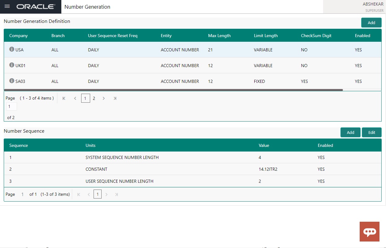

Number Generation sub menu link is available under Setup in LHS menu. Clicking on Number Generation link, the screen is as displayed:
The Number Generation screen consists of the following:

7.3.1 Add Number Generation Definition
  1. click ‘Add’ in Number Generation Definition section. System displays the following screen.
  2. Populate the required details in the following fields:

7.3.2 Number Sequence
This section displays the Number Sequence defined for an entity and facilitates to add and edit the number sequence for an existing number generation definition. Number Sequence is mandatory to be defined for a Number Generation Definition and based on this sequence only system executes the number generation logic and derives the number for specific entity.
  1. Click Add or Edit in the Number Sequence section. The following screen is displayed:
  2. Click ‘+’ icon next to Validate Sequence button.
  3. Populate the following field values
