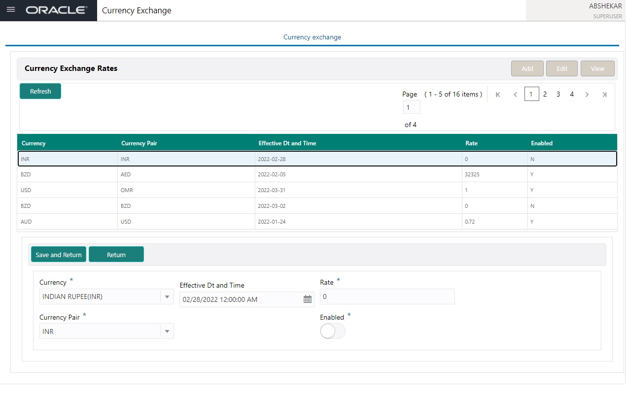

6.1 Currency Exchange
The Currency Exchange screen maintains currency exchange rates. You can define the currency exchange details and schedule a batch job (SET-IFP- ICEPRC_BJ_100_01 - CURRENCY EXCHANGE RATE FILE UPLOAD) which in-turn pulls the currency exchange rates from desired source at scheduled intervals through input file processing.
To set up the Currency Exchange
  1. In the LHS menu, click Setup > Products > Currency Exchange.
  2. In the Currency Exchange Rates section, you can Add, Edit and View the Currency Exchange Details maintained in the system.
A brief description of the fields is given below:
Field:
Do this:
Currency
Select the currency being exchanged from the drop-down list.
Currency Pair
Select the currency to be paired with from the drop-down list.
Effective Date and Time
Specify date and time of the exchange rate. You can even select the date from the adjoining Calendar icon.
Rate
Specify the exchange rate (required).
Enabled
Toggle the switch to activate the currency exchange rate.
  1. Click ‘Save and Return’ to update the record or click ‘Return’ to cancel the update.
