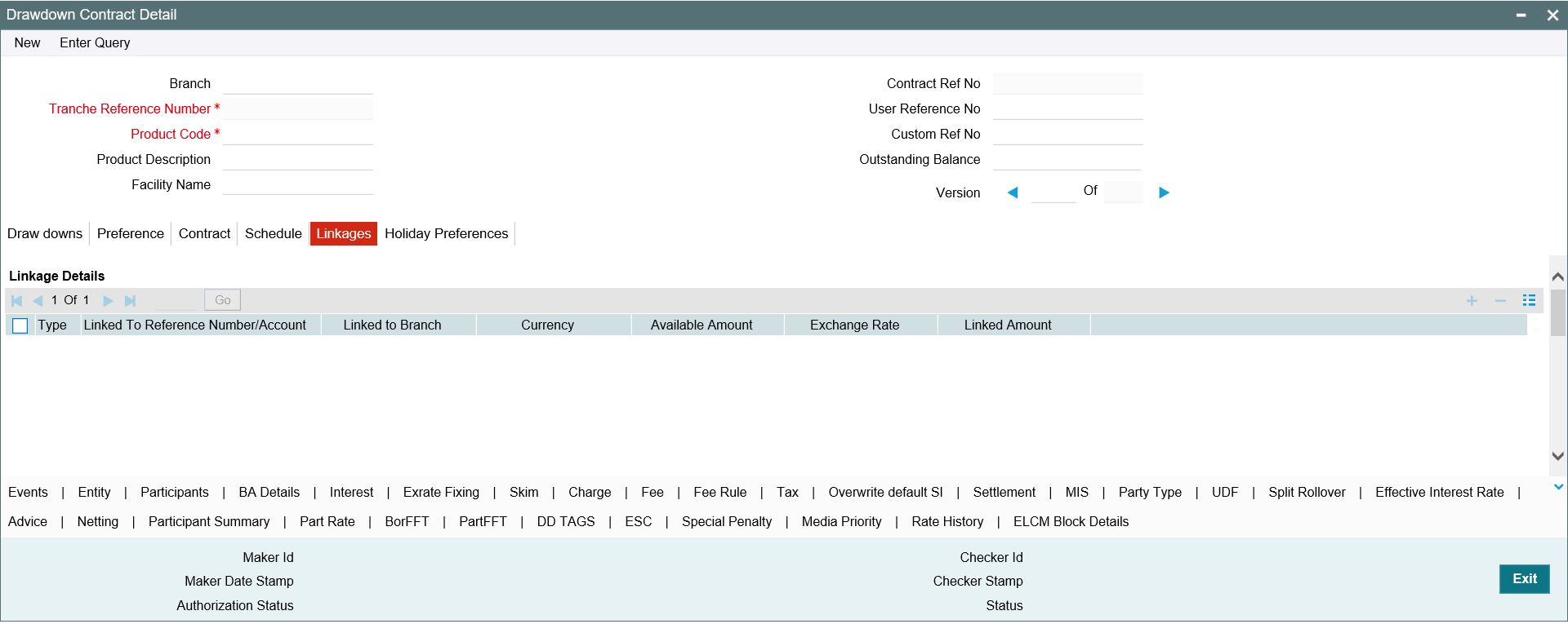

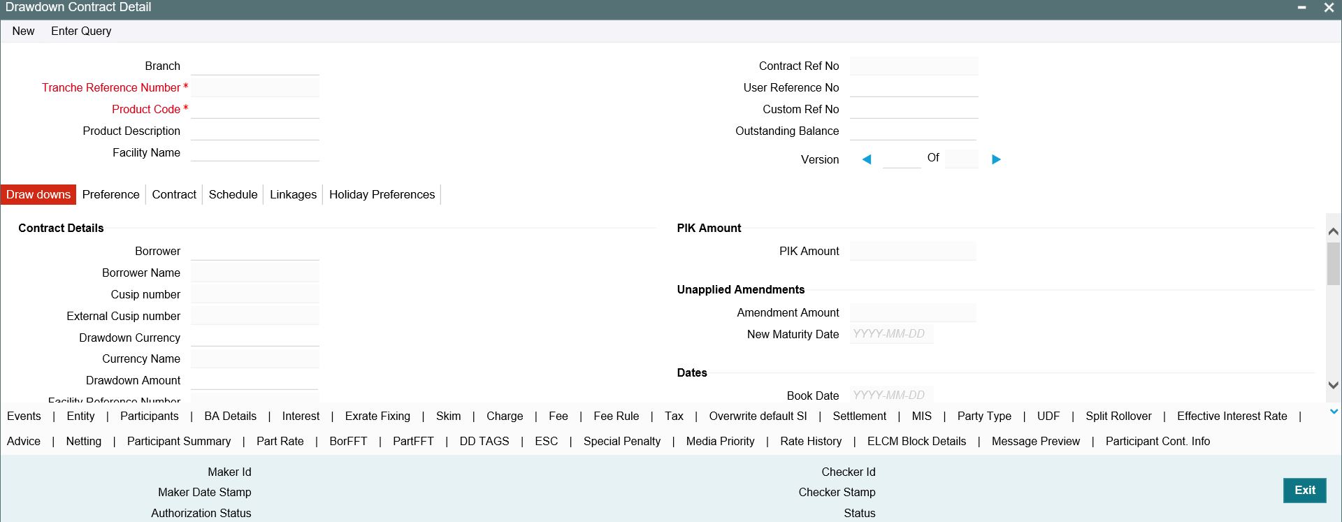

You can process a drawdown contract in the ‘Drawdown Contract Online’ screen. You can invoke the ‘DrawDown Online’ screen by typing ‘LBDDDONL’ in the field at the top right corner of the Application tool bar and clicking the adjoining arrow button.
The screen is displayed with details of an existing drawdown contract, as shown below.
When you are capturing a new drawdown, Oracle Banking Corporate Lending validates the following:
You can capture a drawdown contract either by:
For more details, refer the heading ‘Entering the facility details’ in this chapter.

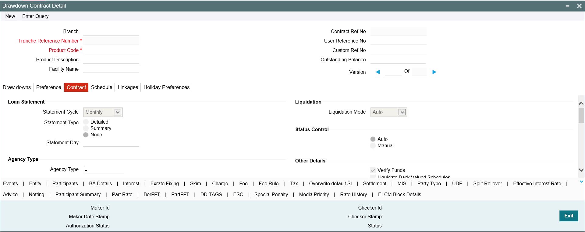

6.1.1 A description of the ‘Drawdown Contract Online’ Screen
You can capture the following in for a drawdown:
You capture information pertaining to the drawdown in the following tabs of the screen:
In addition, a vertical toolbar provided in the screen, may be used to invoke other sub-systems meant to capture important information for the drawdown.
These buttons are same as the ones available for the ‘LB Tranche Contract Online’ screen, except for the following:

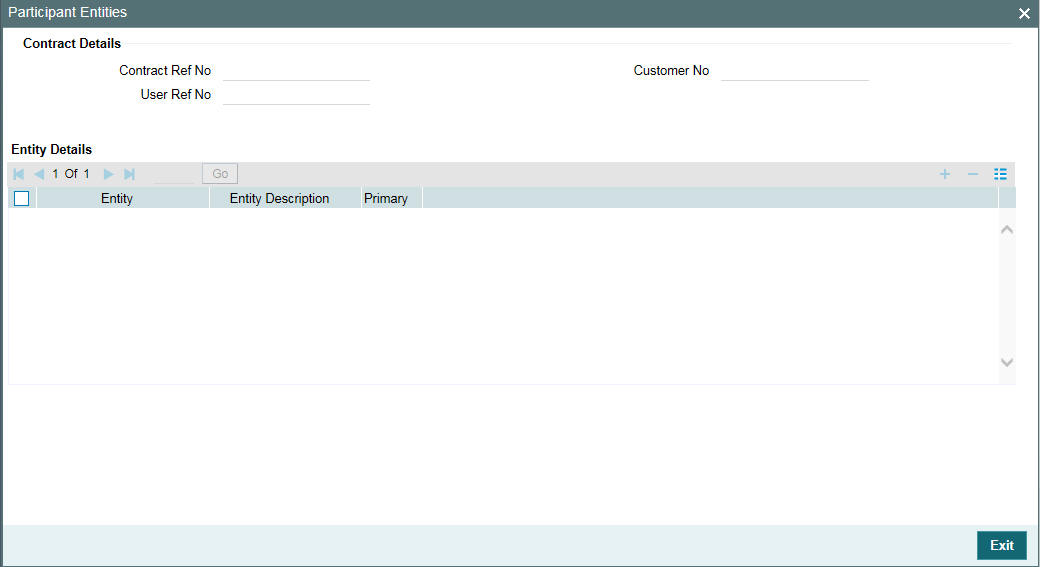

‘Entity’
Click this tab to view/modify the entity details for the drawdown

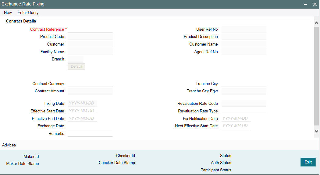

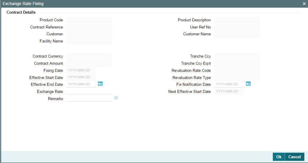

‘Exrate Fixing
Click this tab to fix the exchange rate for a cross currency drawdown

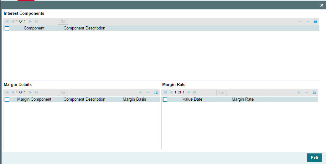

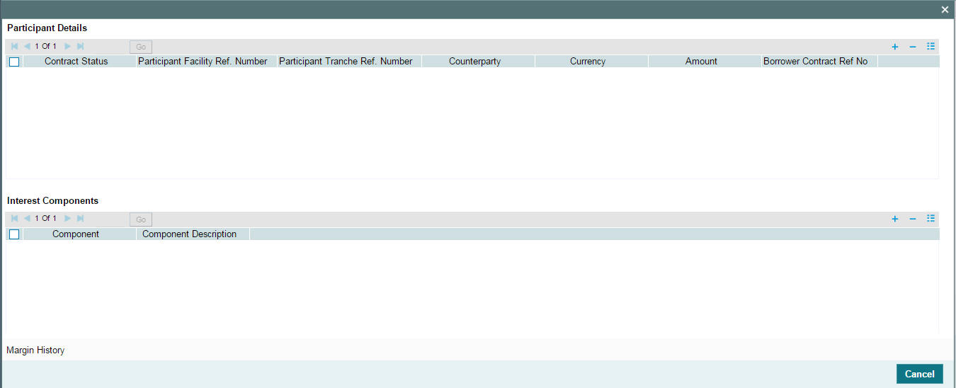

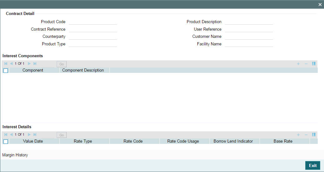

‘Interest’
Click this tab to view the interest and margin components

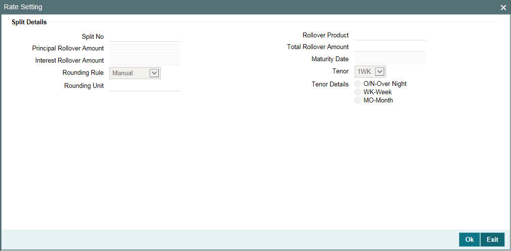

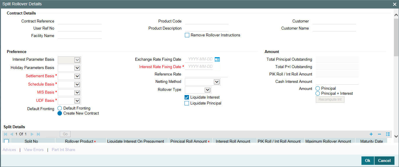

Split Rollover
Click this tab to specify the spilt rollover details if applicable for the draw­down

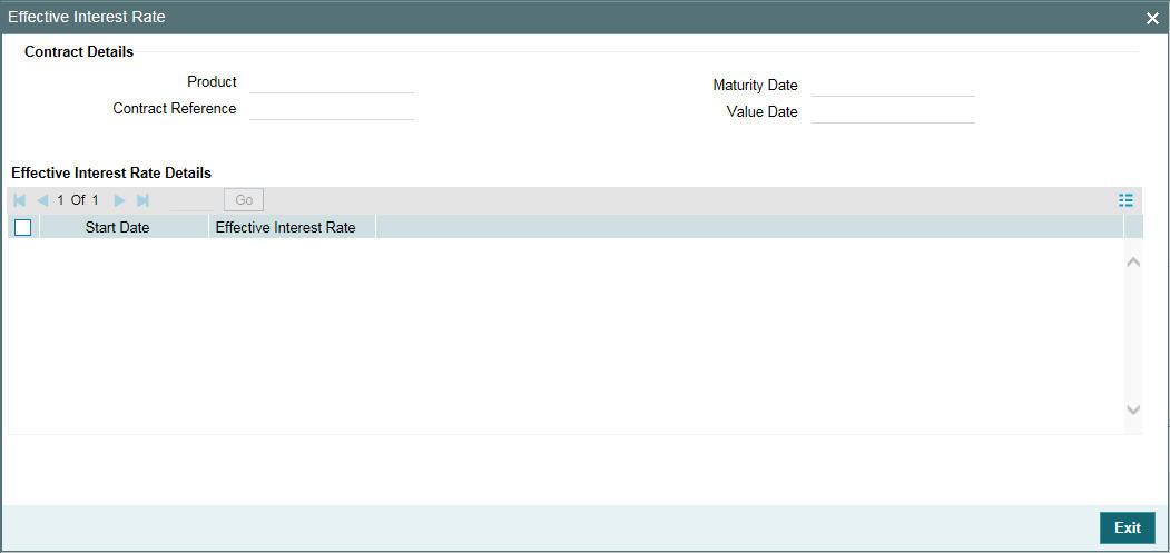

‘Effective Inter­est Rate’
Click this tab to view the Effective Interest (EI) rates for the drawdown

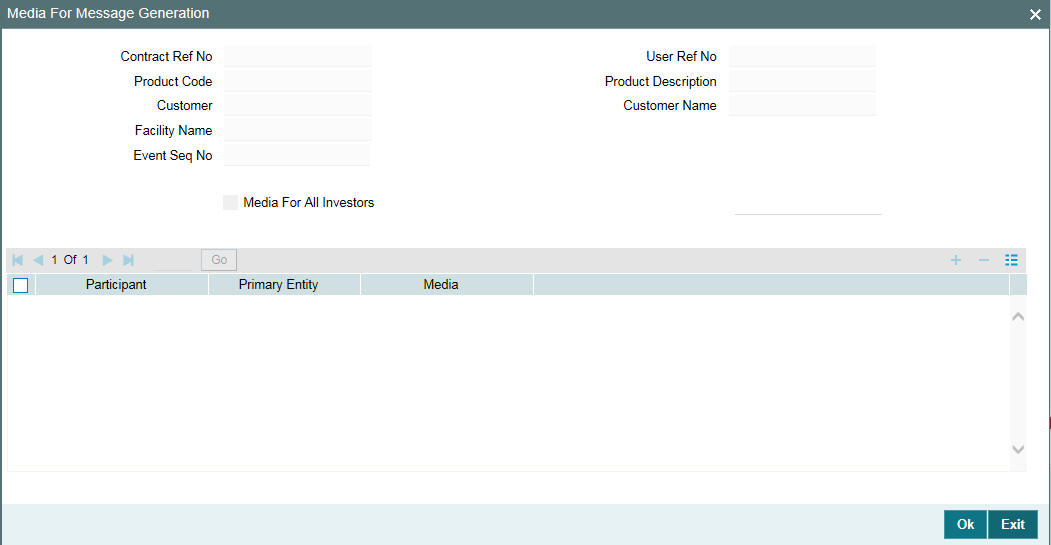

‘Media Priority’
Click this tab to specify the media for message generation

Exchange Rate needs to be fixed!
The ‘Exchange Rate Fixing Date’ displays the current system date (booking date of the drawdown).
Note
If the drawdown currency is different from the tranche currency and the ‘Exchange Rate Code’ that defaults from the product is not maintained for the currency pair (tranche and drawdown currencies), the system displays an error message.
For more details on exchange rate fixing, refer the heading ‘Fixing exchange rate for the DD currency’ in this chapter.

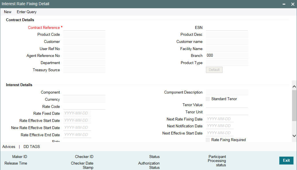

Int Rate Fixing Date
The interest fixing date for the DD currency is displayed based on the ‘Interest rate fixing days’ defined for the tranche and the list of holiday currencies maintained for each currency allowed for the tranche.
The interest rate fixing date is the date (prior to the drawdown date) as of which the interest rate is fixed for a new drawdown or for the new rate fix period. If you change the drawdown currency or the drawdown date, the system re-computes the interest rate fixing date and displays the same here.

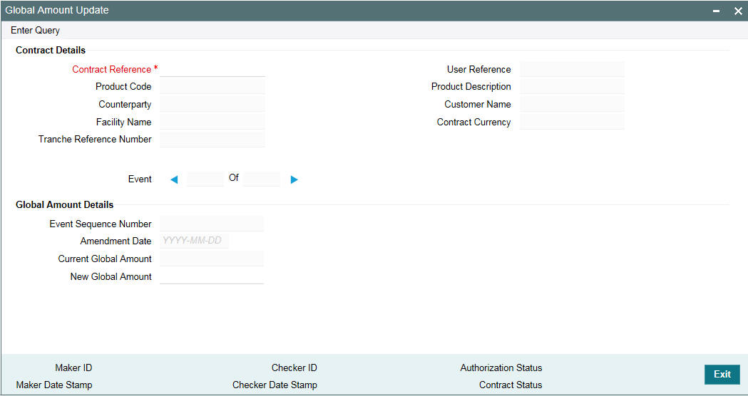

Global DD Amount
The Global Drawdown amount is computed and populated during new drawdown booking based on the Tranche, Global Tranche, and Drawdown amounts. The Global Drawdown Amount is computed as follows:
Global Drawdown Amount = (Global Tranche Amount / Tranche Amount) * Drawdown Amount.
You can amend this amount only for non-lead drawdowns and only if the corresponding Tranche has ‘Cascade Participation’ set to ‘No’. You cannot amend this amount if the underlying Tranche has ‘Cascade Participation’ set to ‘Yes’. The latest Global Amount as on the date of handoff is used for handoff of the Commitment Reduction to the Loans QT system.
However, only those Drawdown Global Amounts, with cascade participation set to N, can be amended using the new screen Global Amount Update/Amendment screen.
Note
The Global Drawdown amount cannot be updated during drawdown amendments.

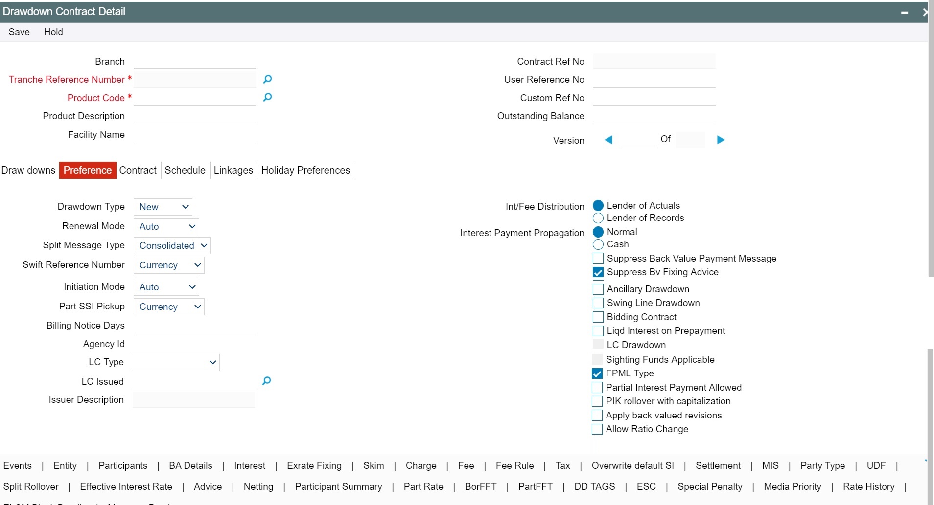

6.2.2 Capturing Details in the ‘Preferences’ Tab
Drawdown Type
This indicates whether you are defining a new drawdown or renewing an existing drawdown. For a new drawdown, ‘New’ is displayed and you cannot change it.
Renewal Type
The ‘Rollover Method’ you specify for the drawdown product will default here. You can change it at the drawdown level. Specify the manner in which the drawdown should be renewed/rolled over. The options available are:
Note
Irrespective of the type of renewal you select here, the system allows you to capture in­structions for any one of the renewal types mentioned above. Depending on the type of instructions you capture, the system automatically updates the ‘Renewal Type’ with the lat­est value when you save the instructions.
Split Message Type
You can select this message type only if the ‘Renewal Type’ is specified as ‘Split’. The message types available are:
INIT Mode
This specification defaults from the tranche. You can change it for the drawdown, if required. This will indicate the mode of initiating the drawdown in the system. The following options are available:
For more details on this screen, refer the heading ‘Specifying participant details for the tranche’ in this chapter.
Suppress B.V Fixing Advice
You can check this option to stop the generation of payment messages when back valued schedules for a back-dated drawdown (with initiation date before today’s date) is liquidated.
Ancillary Drawdown
Oracle Banking Corporate Lending allows you to process Ancillary drawdowns under a tranche. Check this option to indicate that you want to process an Ancillary Drawdown.
This check box is enabled under the following conditions:
A pro-rata tranche is converted to a ‘Non-Cascade’ type once you save the drawdown and it remains as Non-Cascade even on repayment of the drawdown. You can send out participant FFT messages to all the lenders in the syndicate in case of ancillary drawdowns and amendments of the same. You need to maintain a separate advice template for this which you can choose in the FFT screen.
Note
Swing Line Drawdown
You can check this option while booking the new drawdown to identify a swing line drawdown. You cannot make any changes to this during the amendments of the drawdown at the contract level.
For more information on swing line refer to Loan Syndication – An Overview chapter.
Note
If you process a swing line drawdown under a tranche for which the ‘Cascade Participa­tion’ option is checked, the system automatically converts the tranche into a non-cascade participation type.
Further, it triggers the event ‘CASC’ to indicate this conversion.
Bidding Contract
You can select this check box to specify whether the contract is of competitive bidding type.
Note
You can process a bidding contract under tranches for which the ‘Cascade Participation’ option is not checked.
Sighting Funds Applicable
The value for this field is defaulted from the corresponding tranche and you are not allowed to modify this value.
Note
Liqd Interest on Prepayment
Select this check box to indicate if interest should be liquidated as part of prepayment. This check box is enabled only for Prime contracts.
In other words, you can liquidate an interest component for a contract on prepayment, only if you have selected this check box and also the ‘Prime Loan’ check box for a product in the ‘Loan Syndication – Borrower Product Preferences’ screen.
If this check box is selected, Oracle Banking Corporate Lending allows you to define only a bullet interest schedule. Otherwise, you can define a frequency-based schedule.
Note
FpML Type
Select this check box to indicate that the FpML type is required for the DrawDown contract.
If you have selected this box, the system does the following:
If you have not selected this check box and the ‘Media Priority’ option is selected at the product level, then ‘Media Priority’ tab is enabled.
For more information, refer the section ‘Specifying Media for Message Generation’ in this chapter.
Partial Prepayment Allowed
Select this check box to indicate that for drawdown products, partial prepayment is allowed.
Note
Partial prepayment is allowed only for drawdown products where,

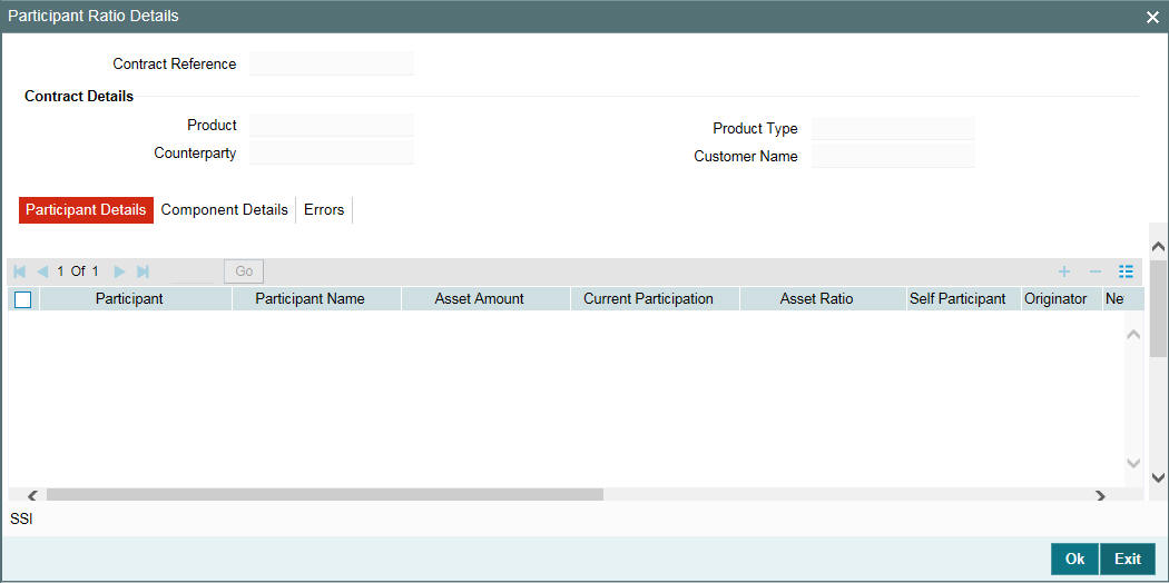

Allow Ratio Change
Select ‘Allow Ratio Change’ check box if you want specify the participant ratio change in ‘Loan Syndication - Contract Payment’ screen (LBDPYMNT).
LC Type
This specification defaults from the product. You may change it at the contract level, if required. The available types are:
Note
You can select the type of LC only if the ‘LC Drawdown’ option is checked for the draw­down.
If you check the ‘LC Drawdown’ option for the product, the same defaults to all drawdowns and you cannot amend it at the drawdown level.
LC Issuer
If the drawdown is an LC type of drawdown, you have to select the issuer of the LC as mandatory information. The option list displays the names of participants you have identified as issuers of LC. This is done at the tranche level.
The LC Issuance Fees is paid to the participant who is identified as the issuer of LC. This fee is computed on the outstanding amount of all the LC drawdowns for the selected issuer.
For more details on this, refer the heading titled ‘Identifying participants as issuers of LC’ in this chapter.
Int/Fee Distribution
System displays the method in which the interest and fee components are distributed among the participants when an assignment is executed before the liquidation date. The distribution type is classified into - ’Lender of Actuals’ type and ’Lender of Record’ type.
This is defaulted from the tranche level.

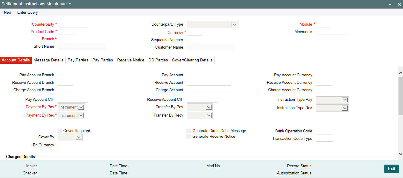

SSI Pickup At
This option defaults from the tranche. You can opt for a different value for the drawdown, if required. This indicates the basis for picking up the SSI (Standard Settlement Instructions) Mnemonic for the drawdown.
The available options are:
For more details on this screen, refer the heading ‘Specifying drawdown participant details’ in this chapter.
Billing Notice Days
This defaults from the drawdown product. You can change default value, if required.
This indicates the number of working days before the repayment due date when a billing notice should be generated, to be sent to a customer as a reminder of the payment.
PIK Rollover with capitalization
Select this check box to indicate that the PIK rollover with capitalization is allowed for the contract. You can amend this value after the Rollover is removed\reversed. You cannot amend the value if the interest component linked to Tranche PIK margin component is having non- zero rate.
Interest Payment Propagation
Select the interest payment for the drawdown from the below two options:
Cash payment can be processed as part of manual payment, split rollover and consolidated rollover processing. The field value for the child contract gets defaulted from parent contract during split rollover processing. During consol rollover processing, the value gets defaulted to child contract from the driver contract.
You cannot book drawdown booking with ‘Interest Payment Propagation’ as ‘Cash’ if below mentioned existing flags are checked for drawdown contract
You cannot book drawdown under lead tranche with ‘Interest Payment Propagation’ as ‘Cash’.

6.2.3 Capturing Details in the ‘Contract’ Tab
You can capture the other contract details in the ‘Contract’ tab of the screen.
The following contract details applicable for drawdowns are explained below:
6.2.3.1 Liquidation
Mode of liquidation of interest and fee components associated with the drawdown defaults from the drawdown product.
At the drawdown level, you can change the mode to any one of the following methods:
For more details on ‘Contract Payment’ screen, refer the heading ‘Processing Repayments Manually’ in the ‘Processing Repayments’ chapter of this User Manual.
For more details on ‘Fee Liquidation’ screen, refer the heading ‘Liquidating Fee Components’ in the ‘Processing Charges and Fees’ chapter of this User Manual.
For more details on this screen, refer the heading ‘Forward processing of events’ in this chapter.
6.2.3.2 Status Control
The statuses - for example, Active, Past Due Obligation, Non-Accrual Basis, and Write-Off , and so on. defined for the product in the ‘Status Maintenance’ screen is applicable for the drawdown. You have to indicate the mode of status change for a drawdown.
The options are:
For details on the ‘Status Maintenance’ screen, refer the heading titled ‘Maintaining status rules for a syndication product’ in the ‘Reference Information for Loan Syndication’ chapter of this User Manual.

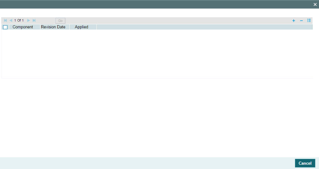

To view the rate revision schedules, click the ‘Revision Schedule’ button. The ‘Revision Schedule Details’ screen appears.
The following details are displayed in this screen:

6.2.6 Viewing Linkage Details for the Drawdown
In the ‘Linkage Details’ section of the screen, you can view the details of the tranche under which the drawdown is processed. The following details are displayed here:
Note
NoteFor each self participant you need to enter linkage details and the linkage percentage must be 100%.
For ELCM linkage, you can link the facility, collateral and collateral pool of counterparty and other additional borrowers as part of loan creation.
6.2.7 Capturing Details in the ‘Split Rollover’ Tab
You can rollover a drawdown only if you have checked the ‘Allow Rollover’ option for the drawdown product used to process the drawdown. If this option is not selected, the following message appears when you click ‘Rollover’ tab:
“Rollover not allowed”

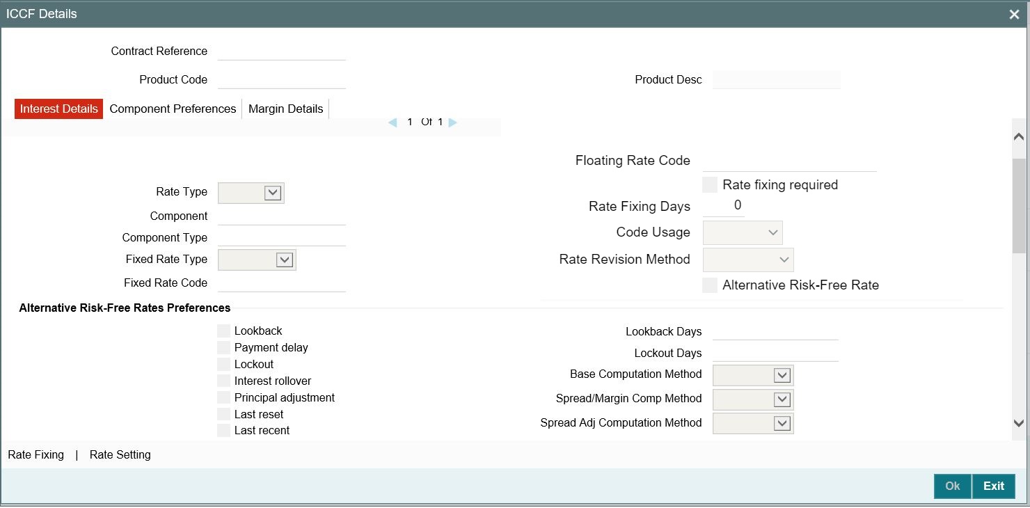

Click ‘Interest Details’ button to enter interest related details and also RFR (Risk Free Rate) details. For more information on RFR, refer to Interest User Guide.
On click of ‘Interest Details’ button, ‘Interest Rate Fixing Date’ gets defaulted as parent contract maturity date.
For details on rollover and information on the ‘Rollover’ tab, refer the ‘Rolling-over a drawdown’ chapter of this User Manual.

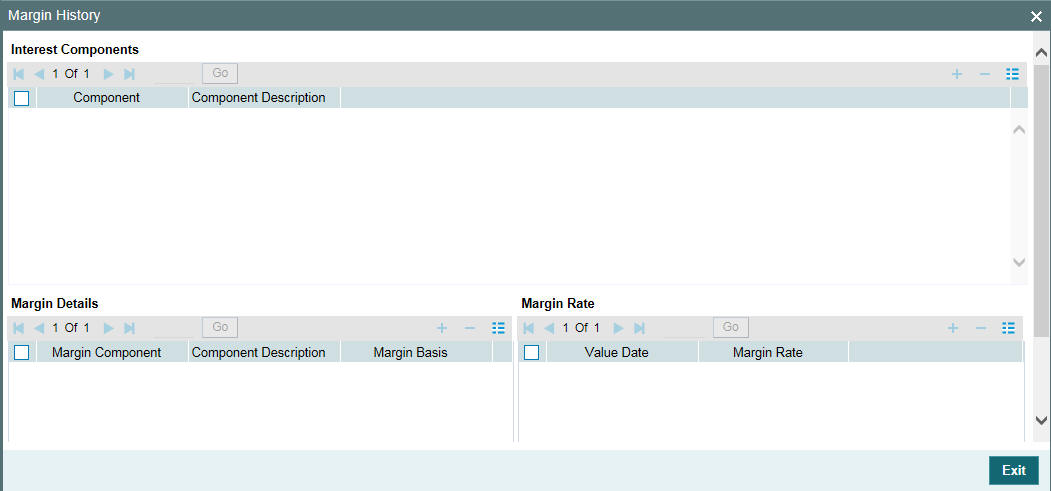

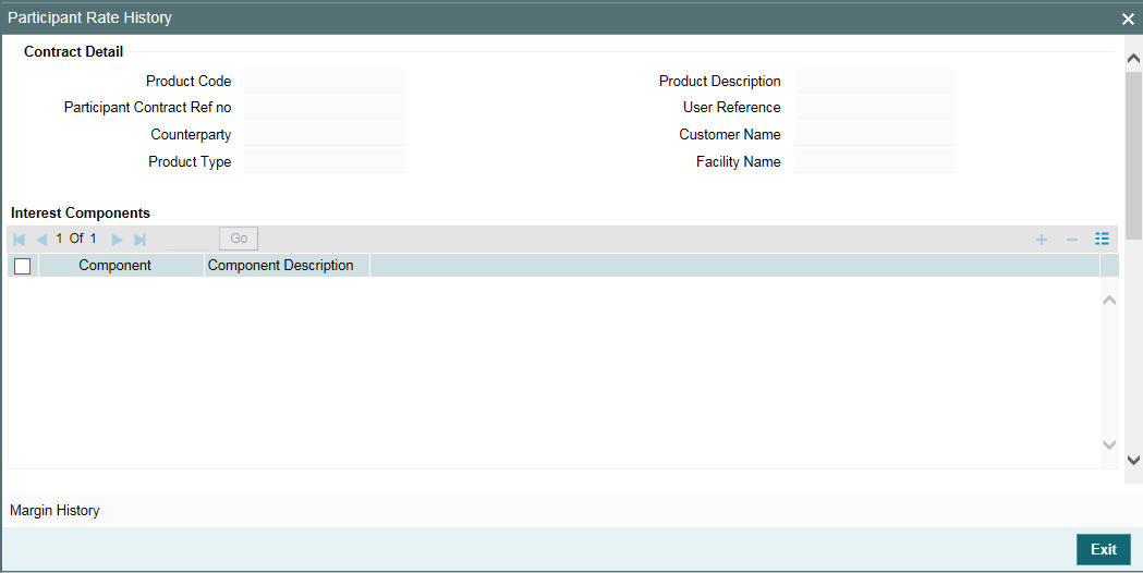

6.2.8 Viewing Rate History Details
You can view the Interest rate and margin rate history for each drawdown in the ‘Rates History’ screen. This screen holds the history of interest rate and margin changes that have happened for the drawdown. Click ‘Rate History’ tab to invoke this screen.
In this screen, you have to select the interest component to view the corresponding interest and margin details. To view the margin rates for the components, click the ‘Margin History.
6.2.9 Specifying Drawdown Entity Details
You can view the borrower entity details in the ‘Borrower Entities’ screen. These details default from the tranche associated with the drawdown. Click the ‘Entity’ tab to invoke this screen.
You can modify only the following parameters:
SSI Counterparty
By default, the drawdown borrower is displayed here. You can change the counterparty if the borrower requests to process the settlements through another account. The option list displays the names of all the customers maintained in Oracle Banking Corporate Lending.
SSI Mnemonic
SSI Mnemonics are maintained in the ‘Settlement Instructions’ screen for a Counterparty, Module, Currency, Product and Branch combination. The same is available for the counterparty/borrower of the drawdown. The Mnemonic selected here obtains the settlement details for the borrower of the contract and the same defaults to the ‘Settlement Message Details’ screen.
If you do not select the SSI Mnemonic, system defaults the SSI Mnemonic for the counterparty and contract currency when you exit the screen.
Note
Note the following:
Select the appropriate ssi mnemonic applicable for the selected currency

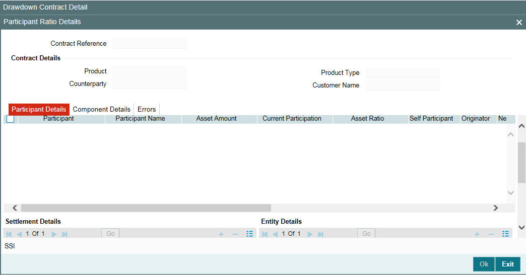

6.2.10 Specifying Drawdown Participants
You must also identify the participants who contribute to the amount being disbursed under the drawdown. A borrower drawdown contract inherits the participant details defined for the borrower tranche under which it is entered. You can make changes to the defaulted participant details when you enter a borrower drawdown. To view the details in the ‘Participant Ratio Details’ screen, you have to click the ‘Participants’ tab.
Based on the drawdown amount, the system computes the contribution of each participant towards the drawdown as per the ‘Asset Ratio’ maintained for the tranche.
You can change the default participant details in this screen. Upon change of participants, the system automatically convert a ‘Cascade Participation’ type of tranche to a ‘Non Cascade Participation’ type. The ‘CASC’ event is triggered to indicate the change in the attribute and the ‘Cascade Participation’ option for the underlying tranche (in the ‘CONTRACT’ tab of the ‘LB Tranche Contract Online’ screen) is deselected. If changing the participant details is possible, you can specify the following details for each participant, for the drawdown schedule:
For example, let us assume a tranche amount of USD 10 million. The Asset Sharing Ratio (ASR) for various participants can be calculated as follows:
Participant
Asset amount in USD
ASR in %
CITIBANK
2,000,000
20
BAR­CLAYS
2,000,000
20
NATWEST
3,000,000
30
HSBC
3,000,000
30
At the drawdown level, you can choose to change the asset sharing ratio of the participants in the following manner, if required.
Let us assume that the first drawdown amount is USD 4 million. The Asset Sharing Ratio (ASR) for this amount is as follows:
Participant
Asset amount in USD
ASR in %
CITIBANK
1,200,000
30
BAR­CLAYS
400,000
10
NATWEST
1,600,000
40
HSBC
800,000
20
When you change the ASR for a drawdown under the tranche, the ASR at the tranche level will remain the same. However, at the time of a second drawdown, the ASR at the drawdown level displays the availability ratio instead of the tranche asset sharing ratio.
Note
The original asset sharing ratio is displayed only at the Tranche level.
The availability ratio after the first drawdown is as follows:
Participant
Asset amount in USD
ASR in %
Availability amount
Availability ratio in %
CITIBANK
2,000,000
20
800,000
13.33
BAR­CLAYS
2,000,000
20
1,600,000
26.67
NATWEST
3,000,000
30
1,400,000
23.33
HSBC
3,000,000
30
2,200,000
36.67
The availability amount is computed on the following basis:
The availability amount could vary for revolving and non-revolving tranche.
For revolving tranche contracts, the available amount will be calculated as follows:
For non-revolving tranche contracts, you can compute the available amount in the following manner:
You can change the asset sharing ratio for participants on a non proportionate basis using the ‘Contract Payment’ screen.
For more information on this, refer the section ‘Processing Repayments Manually’ in the ‘Processing Repayments’ chapter of this User Manual.
For details on fields available in this screen, refer the heading ‘Maintaining participant details for the tranche’ in this chapter.

6.2.11 Viewing Participant Margin Details
You can view margin details maintained for participants of the drawdown contract, using the ‘Participant Rate Summary’ screen. To view this screen, you have to click the ‘Part Rate’ tab.
Here you can view the following details.
Participant Details
The system displays the following participant details:
Interest Components
The system displays the following component details.
Interest Details
The system displays the following interest details.
Margin Details
The system displays the following margin details.
6.2.11.1 Viewing Margin History
You can view margin details of all participants including the margin history by clicking the ‘Margin History’ button on the ‘Participant Rate Summary’ screen.
The system displays the following details.
Margin History Interest Component
Margin Details
Margin Rates
The system displays the following margin rate details.
The margin rate maintained for the individual participant is considered while calculating the interest due on the participant side, during contract booking. This is applicable for current dated/back dated/forward dated drawdown bookings.
6.2.12 Fixing Exchange Rate for Drawdown Currency
You will need to fix the exchange rate for drawdowns only if the drawdown currency is different from the tranche currency. The exchange rate fixing days refers to the number of business days before the value date of the drawdown or the new rate fix period. Exchange rate fixing for the new drawdown or the new rate fix period is done on this day.
To fix the exchange rate for the drawdown currency, click ‘Exrrate Fixing’ tab. The ‘Exchange Rate Fixing’ screen is displayed, as shown below:
The system arrives at the exchange rate fixing date for the drawdown currency based on the exchange rate fixing days maintained at the tranche level and the holiday validation currencies specified for the drawdown currency.
For more details, refer the heading ‘Specifying currency details for the tranche’ in this chapter.
You can specify the following details in this screen:
Effective End Date
You have to specify an end date for the new rate to be effective in the system. The start date will be equal to the drawdown date. You have to capture the date in ‘DD-MMM-YYYY’ format.
Exchange Rate
The default exchange rate is displayed here. The system picks up this rate from the ‘Currency Rates Maintenance’ screen. You can change the rate, if required. You can enter upto 15 decimal points.
Remarks
You can also capture additional information, if required. This is used only for information purposes.
Note
It is not mandatory for you to fix the exchange rate before you fix the interest rate.
6.2.12.1 Saving the New Exchange Rate
Click ‘Ok’ button to save and exit the screen. When you save the drawdown, the system triggers the ‘EXFX’ event with the exchange rate fixing notice. For future dated drawdowns, you need to fix the exchange rate before the value date of the drawdown.
Subsequently, you have to manually fix the exchange rate for the drawdowns. You have to fix the rate for the next period before the end of the current period. However, if you do not do the rate fixing for the subsequent periods, Oracle Banking Corporate Lending applies the latest fixing rate for the rest of the period.
Note
For more information, refer the heading ‘Fixing Exchange Rate after drawdown booking’ in this chapter.

You can view the interest and margin components, if applicable to the drawdown, in the ‘ICCF Details’ screen. These details default from the tranche under which the drawdown is being processed. Click ‘Interest’ tab to invoke this screen.
6.2.13.1 Amending Interest Basis
The interest basis defaults from the product level. However, you can change the default value anytime during the lifecycle of the contract except for contracts with interest capitalization type of renewal instructions. When you change the day basis, the system re-computes the schedule interest amount from the start date of the component. The amendment becomes applicable from the value date of the contract. Note that the system considers the margin rates maintained for each participant while re-computing the interest.
The interest for each currency is calculated using the interest basis, which you select:
For more information on ‘Interest Basis’, refer to Interest User Manual.
Note the following:
You can use the navigation buttons - to view the interest components associated with the drawdown.
Specifying Interest Rate Rounding Components
The ‘Rate Rounding Rule, ‘Rate Rounding Unit’, and ‘Rate Rounding Position’ values get defaulted from ‘Interest Limits Detail’ screen. If required, you can change these values.
Amortization Constant Component
The default value from the product gets defaulted here. The check box is selected if this is an amortization constant component. You cannot change it in the contract level.
Compensatory Component
The corresponding compensatory component is displayed from the product for the main interest component.
Note
6.2.13.2 Alternative Risk-Free Rates Preferences
The options of ‘Alternative Risk-Free Rates Preferences’ are defaulted from ‘Interest Class Maintenance’ screen (LFDINTCL).
While booking the contract you can modify the 'Alternative Risk-Free Rates Preferences' options.You cannot modify the preferences during contract amendment and value dated amendment.
In case loan is booked with 'Alternative Risk-Free Rates Preferences' and during contract amendment if you try to change the preferences to LIBOR Fixed/Floating, then the following error appears "Modification of parameters from RFR to Non-RFR and vice-versa is not allowed".
For more information, refer to Interest User Manual.
6.2.13.3 Specifying Billing Preferences
The billing preferences maintained at the product level defaults to the contracts. You can amend these preferences at the contract level only if you have specified the same at the product level.
Billing Notice Required
Select this check box to indicate that you would like to send a billing notice for the interest component.
No of Days
Specify the number of days prior to the billing date that the billing notice needs to be sent.
Note
You can not amend these values if the Billing Notice Required option is deselected at the product level.
For details on the above screen, refer the heading ‘Specifying Interest Details for a Contract’ in the ‘Processing Interest’ chapter of the Interest User Manual.
6.2.13.4 Fixing Interest Rate for the Drawdown
Just as you fix the exchange rate for the drawdown currency, you can also fix the interest rate for a predefined period. The Interest rate fixing days refers to the number of business days before the value date of the drawdown or the new rate fix period. Interest rate fixing for the new drawdown or the new rate fix period is done on this day.
Note
Note
For main interest component if ‘Rate Type’ is 'Fixed', then you can enter rate fixing details in 'Rate Fixing' screen. In addition, you can enter the 'Spread' and 'Margin Details'.
For more details regarding dual authorization, refer the heading titled ‘Authorizing Overrides’ in the chapter titled ‘Loan Syndication Contracts - Part 1’ of this User Manual.
The system arrives at the Interest rate fixing date for the drawdown currency based on the Interest rate fixing days maintained at the tranche level and the holiday validation currencies specified for the drawdown currency.

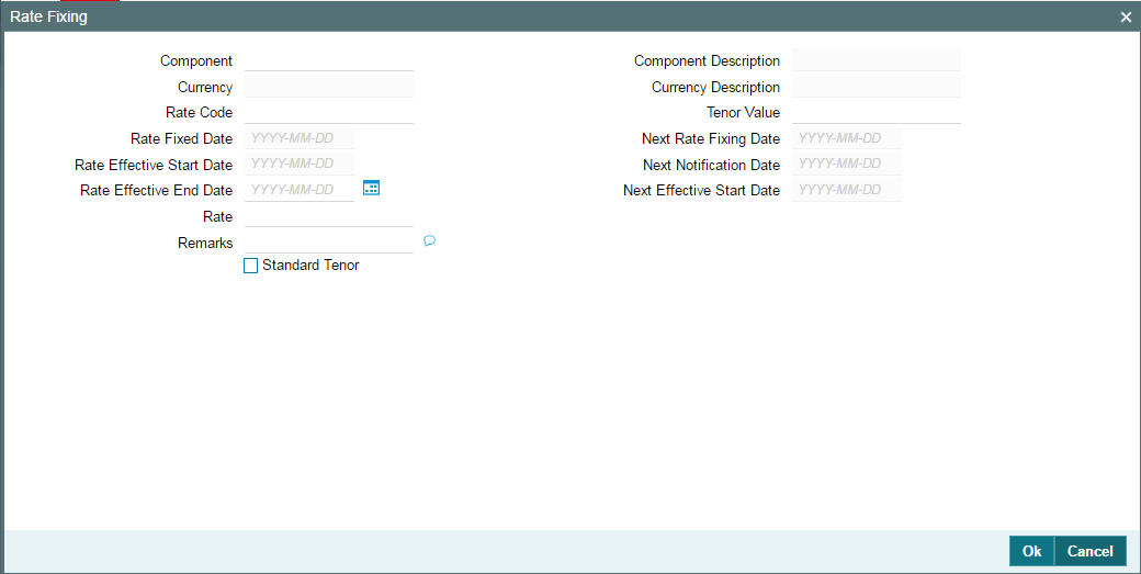

To fix the interest rate for the drawdown currency, click the ‘Rate Fixing’ tab in the ‘ICCF Details’ screen and invoke the ‘Rate Fixing Details’ screen, as shown below:
Note
Rate Fixing button gets enabled in ‘ICCF Details’ screen only if rate fixing is selected at the product level.
You can specify the following details in the ‘Rate Fixing Details’ screen:
Rate Code
You have to specify the floating rate code based on which you can specify the interest rate fixing tenor and the default fixing rate.
Tenor Value
You can specify the rate fixing period by specifying a ‘Tenor Value’ or the ‘Rate Effective End Date’. If you are specifying a tenor, you can select a value from the option list which displays the tenor values associated with the rate code you select. This is based on your maintenance in the ‘Floating Rate Code Definition’ screen. Upon choosing a value, the following details are also displayed:
If you do not want to specify a ‘Tenor Value’, you have the option to capture the end date of the rate fixing period. This date should not be less than or equal to the ‘Rate Effective Start Date’. The system displays the following after you specify the end date:
Rate
The system defaults the interest rate based on the rate code and the tenor value/effective end date you specify for the drawdown. You can change the default rate, if required.
If the base rate is changed or new rate is added or the floating rate codes are changed, the system recalculates the interest. Note that it considers the margin rates maintained for the participants while recalculating the interest due for the participants.
For more details on negative rate processing, refer the title ‘Maintaining Loans Parameters Details’ in the chapter ‘Bank Parameters’ in Core Services User Manual.
Remarks
You can also capture additional information, if required. This will be used only for information purposes.
Click the ‘Ok’ button to save and exit the screen.
Note
Capturing the Value date
On click of unlock button you are allowed to capture the value date by altering the rate effective start date.
Note
The following actions should be performed automatically on click of ‘OK’ button in the ‘value date’ field.
For more information on bidding refer ‘Bidding Contract’ section in ‘Interest’ manual in ‘Modularity’ module.
For details on the ‘LB Interest Rate Fixing’ screen, refer the heading ‘Fixing Interest Rate after drawdown booking’ in this chapter.
Rate Setting
To set the rate setting rules for the borrowers drawdown, click the ‘Rate Setting’ in the ‘ICCF Details’ screen and invoke the ‘Rate setting’ screen, as shown below:
Specify the following details.
Contract Details
Product code
The system displays the product code.
Contract Ref number
The system displays the contract ref number.
User ref number
The system displays the user ref number.
Customer
The system displays the customer name.
Facility name
The system displays the facility name.
Split Details
Split number
The system displays the split number.
Principal roll amount
The system displays the principal roll amount.
Interest roll Amount
The system displays the Interest roll amount.
Roll Product
The system displays the roll product.
Total roll amount
The system displays the total roll amount.
Maturity date
The system displays the maturity date.
Interest rate rounding rules
Rounding rule
Select the rounding rule from the adjoining drop down list. Select one of the options listed below:
Rounding Unit
The rounding unit enables only if the you have selected the ‘rounding rule’ as ‘Down’ and ‘Upto’
Interest rate period
Select one of the interest rate periods from the options given.

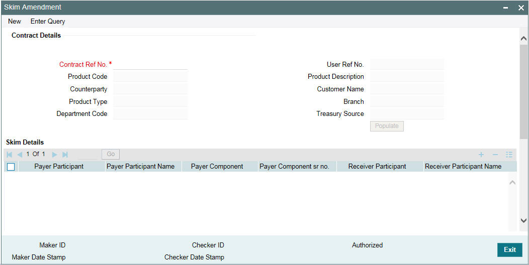

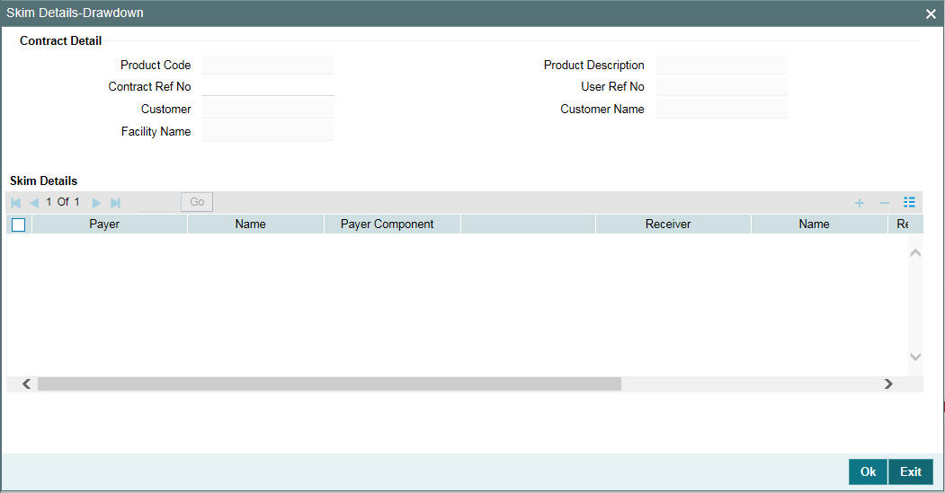

6.2.14 Specifying Drawdown SKIM Details
The SKIM details captured for the tranche gets propagated to the drawdown contract. You are allowed to amend the details at the drawdown level. To view and amend the details, if needed, click the ‘Skim’ tab. The ‘SKIM Details – Drawdown’ screen is displayed.
The details of the payer and receiver of Skim and the Skim rate gets defaulted to the respective participant contracts for processing. The accounting entries are also passed in the corresponding participant contracts.

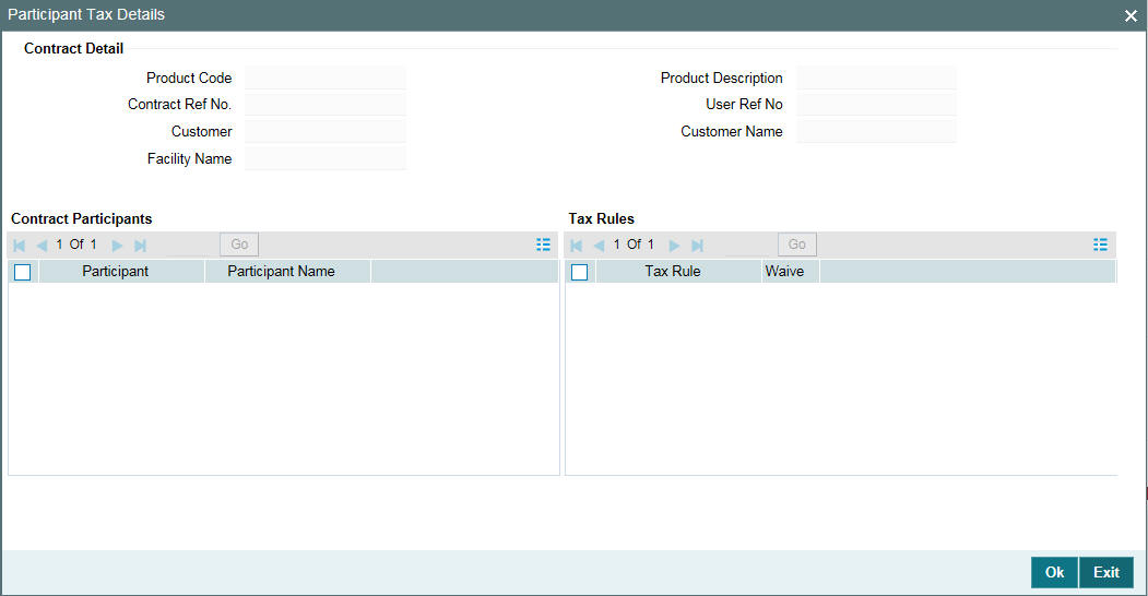

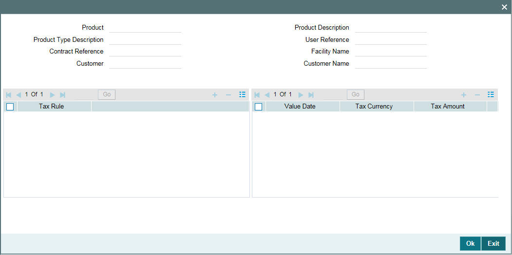

6.2.17 Tax Details
At the drawdown level, tax is applicable only on the interest and fee component.
The ‘ Tax’ sub-screen displays the tax rule details associated with the drawdown product.
You can view both borrower and participant tax details associated with the drawdown.
You can waive the subsequent tax that is applied for a borrower/participant and tax rule combination.The system passes the entries for tax based on the event you specify in the ‘Product Tax Linkage’ screen.
Typically, tax on fee is calculated upon liquidation of the fee (event ‘FLIQ’ is associated with the rule) while tax on interest is computed on interest liquidation (event ‘LIQD).

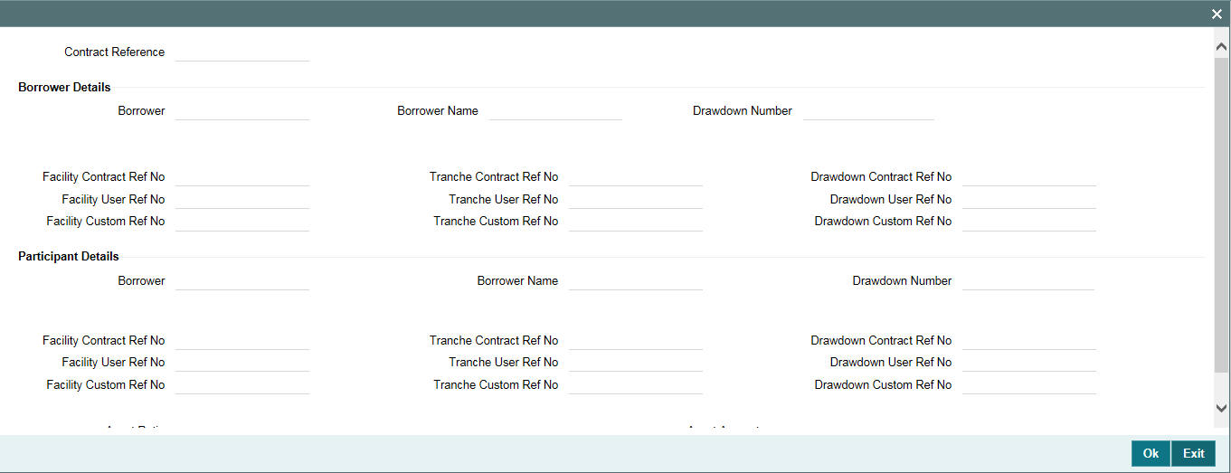

6.2.18 Viewing Drawdown Tax Details
You can collect withholding tax on the fee/interest collected by the participants of a drawdown. However, tax is not applied on the fee collected from the participants. The tax details, if applicable for the participant product (linked to the drawdown through the facility product) is applied on the drawdown. To view the details, click the ‘Tax’.
This screen displays the tax rules for each participant based on which withholding tax is computed on the fee or interest components. Tax rules associated with the drawdown product defaults to the drawdown. You can waive the subsequent tax to be applied for a participant and tax rule combination.
The system passes the entries for tax based on the event you specify in the ‘Product Tax Linkage’ screen. Typically, tax on fee is calculated upon liquidation of the fee (event ‘FLIQ’ will be associated with the rule) and tax on interest is computed on interest liquidation (event ‘LIQD’ is associated with the rule).
For details on associating tax with a product, refer the heading titled ‘Specifying tax details for a participant product’ in the ‘Defining Products for Loan Syndication’ chapter of this User Manual.
For more information on the Tax sub-system of Oracle Banking Corporate Lending, refer the Tax User Manual.

6.2.20 Viewing Settlement Instructions for the Drawdown
You can view the settlement instructions for the drawdown in the ‘Settlement’ screen. Click the ‘Settlement’ tab to view the details.
The system obtains the settlement account for each drawdown component based on the SSI Mnemonic selected for the component.

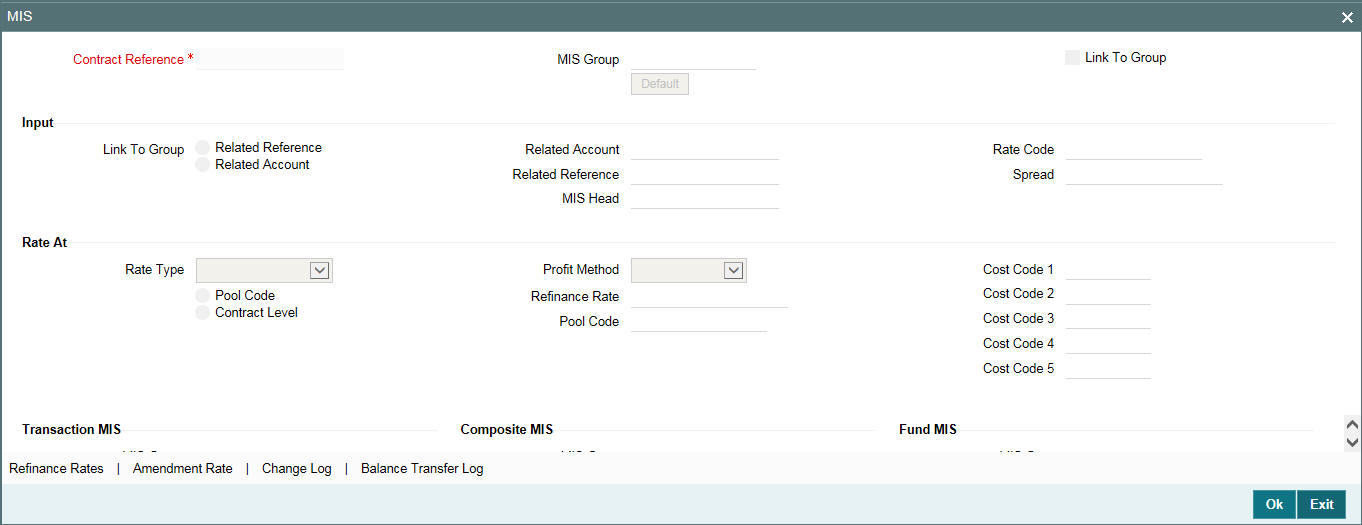

6.2.21 Viewing MIS Details for the Drawdown
If you have maintained MIS details for the DD (drawdown) product, the same will default to the drawdown. To view the details, click the ’MIS’ tab.
For details on the ‘Transaction MIS Details’ screen, refer the MIS User Manual.

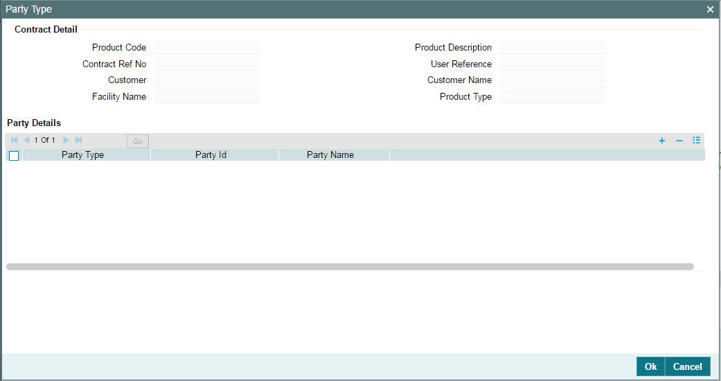

6.2.22 Specifying Parties for the Drawdown
You can also specify different entity or party types that would be applicable for the borrower drawdown as well as the applicable parties belonging to the selected party type. This is done in the ‘Party Details’ screen. Click ‘Party Type’ in the ‘DrawDown Contract Online’ screen. The party types associated with the drawdown product defaults to the drawdown. You can change the defaulted values, if required.
For more details on the above screen, refer the heading ‘Specifying parties for the facility’ in this chapter.

6.2.25 Viewing EI for the Drawdown
You can view the effective interest (EI) rates applied on the drawdown through the Effective Interest Rate details screen. Click the ‘Effective Interest Rate’ to invoke this screen.
In this screen you can view the ‘Effective Interest Rate’ and the ‘Start Date’ from which interest rate is effective in the system.

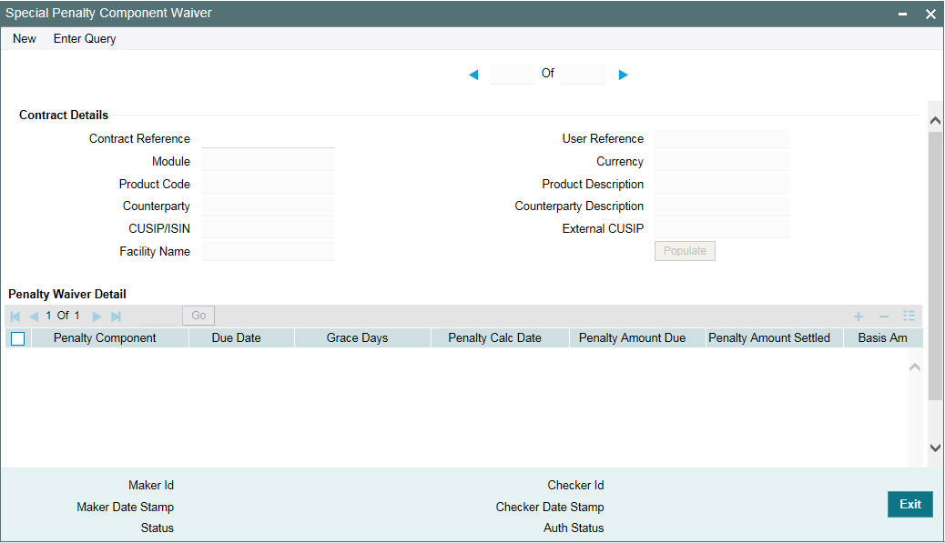

6.2.27 Specifying the Special Penalty Components
You can select components to which late payment charges are applicable for both commitment and loan contracts using the ‘Special Penalty Components’ screen. To invoke this screen, click the ‘Special Penalty’ tab in ‘Drawdown Contract Online’ screen.
Specify the following details:
Component
System defaults the components selected for late payment charge application at the product level.
Apply Special Penalty
Select this check box to indicate that system should apply special charges to the penalty component.
6.2.27.1 Processing the Late Payment Charges
System identifies the loan contracts where grace period has expired and tracks due date, amount paid and amount settled for each component of the loan. If late payment charge component has been defined for a loan contract, that is,. if the ‘Special Penalty Component’ is selected for a component in a contract, then system does the following:
6.2.28 Specifying Media for Message Generation
You can specify the media for the message generation in ‘Media for Message Generation’ screen. You can invoke this screen by clicking ‘Media Priority; tab. This button is enabled only if the ‘FpML Type’ option is unchecked and the ‘Media Priority’ option is checked at the product level.
The system displays the following details:
You can specify the following details:
Media for All Investors
Select this check box to indicate that the media is applicable for all the investors.
Media
Specify the individual participants and media for primary entity of each participant if the ‘Media for All Investors’ option is not selected. The adjoining option list displays all valid media maintained in the system. You can select the appropriate one.
You are allowed to select any media for primary entity of individual participant only if that media is maintained for primary entity of individual participant in the ‘Customer Entity Maintenance’ screen and also message type corresponding to the media is maintained for the event at the product level.
If there are multiple events to be registered in a single transaction from the same screen, the system validates such that message type corresponding to the media is maintained at least for one event at the product level.
In case, if the selected media is not available for any messages attached for some event, then the message for that event is generated based on the priority maintained in the ‘Customer Entity Maintenance’ screen.
During the drawdown booking, if the ‘Media for all investors’ is selected as ‘FPML’ , then the message generation corresponding to the events will be as follows:
Events
Message generation
DNOT
FPML message will be generated
IRFX
Since there is no message attached with media FPML for IRFX event system checks the priority of Entity1 of participant and message is sent through media ‘FAX’.
If there is no media order maintained for Entity1, then system will generate the message using customer entity maintenance.

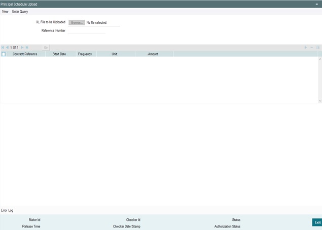

6.2.29 Amortize schedule type DD Contracts
You need to do the following set ups at the contract level for amortization schedule type contracts.
The ‘Liqd Interest on Prepayment’ flag is unchecked and disabled at the contract online screen. You are not allowed to perform any changes here. Partial payments is not allowed for agency amortization type of contracts and Partial payment allowed flag is unchecked and disabled for Amortization schedule type contracts. In CONTRACT tab, field ‘Amortization Type’ can be selected as ‘Reducing Balancing’ or ‘Rule 78’. The default value is ‘Reducing Balance’ and Schedule type is displayed as ‘AMORTISE’.
Contract schedules parameters like component, start date, number, frequency, units and other fields are defaulted. Amount is automatically derived by the system and is disabled. Based on these parameters, installment amount of each payment schedule is derived.
Contract schedule frequency redefinition to frequency values other than Monthly and Bullet are not allowed for all the components. System derives amortize amount based on the Principal and tenure of the contract using the EMI computation function.
Principal portion of the payment is derived using the formula Principal = Amortize amount– Interest component amount. System supports reducing balance amortization. And, amortization is not applicable for Sighting Funds applicable contracts.

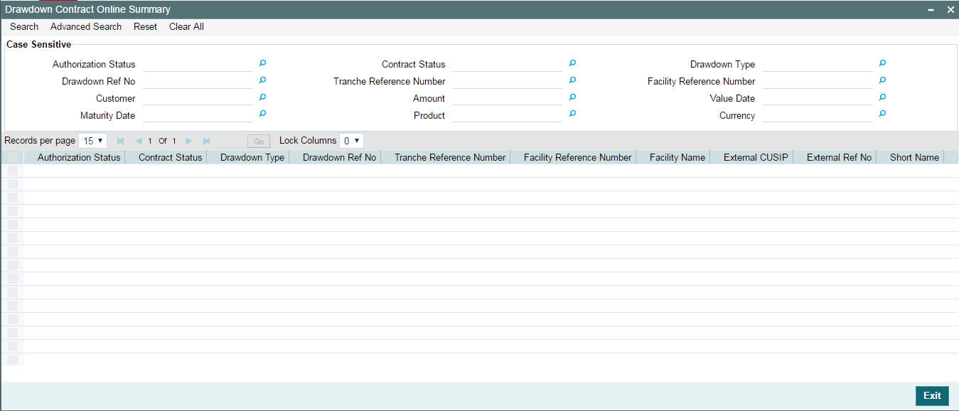

6.2.30 Viewing Drawdown Summary
You can view the drawdown details using the ‘Drawdown Summary’ screen. You can invoke the ‘‘Borrower Drawdown Summary’ screen by typing ‘LBSDDONL’ in the field at the top right corner of the Application tool bar and clicking the adjoining arrow button.
You can view the following fields:
6.2.31 Fixing Exchange Rate After Drawdown Booking
You can perform a case independent search only if the parameter, ‘CASE_SENSITIVITY’ in cstb_param, is set to ‘Y’.
If you do not fix the exchange rate during drawdown booking (the event ‘EXFX’ is not fired for such drawdowns) you have the option to fix the same after the booking event. This is applicable if the drawdown currency is different from the tranche currency. You can invoke the ‘Exchange Rate Fixing’ screen by typing ‘LBDEXRFX’ in the field at the top right corner of the Application tool bar and clicking the adjoining arrow button.
All subsequent exchange rate fixing after the drawdown booking is done through the above screen. Through this screen, you can fix the exchange rate for the current period (before the effective start date) as well as specify a rate for a new period. These options are discussed below.
6.2.31.1 Using the ‘Unlock’ option to fix the exchange rate before the start date
You can use the unlock option to fix the exchange rate before the effective start date of the exchange rate fixing period. If you attempt to fix the exchange rate after the effective start date, the following message is displayed:
Exchange rate already fixed
To amend the exchange rate for the current fix period (i.e. before the effective start date), do the following:
  1. Select the drawdown for which you want to fix the exchange rate. You can use the navigation button provided in the toolbar of the screen to select the drawdown. Alternatively, you can also use the F7 and F8 keys to fetch the required drawdown. The system will display the ‘Fixing Date’ based on the exchange rate fixing days maintained for the drawdown currency at the tranche level. The ‘Fix Notification Date’ will be one day prior to the ‘Fixing Date’ for such drawdowns (for which exchange rate fixing is done before the effective start date).
  2. Unlock the selected drawdown. To do this, Select Unlock option from the menu.
  3. Specify the effective end date for the period. This date should not be greater than the drawdown maturity date and earlier than the ‘Effective Start Date’. When you specify the end date, system will accordingly display the ‘Next Effective Start Date’ (Effective End Date + 1).
  4. Change the default exchange rate, if required. This rate is picked up from the ‘Currency Rates Maintenance’ screen. You may also capture any remarks, if required.
  5. Select Save from the menu to save the changes. The system will display a confirmation message if the save operation is successful.
Note
    • If you have defined revaluation schedules for a period, you cannot fix the exchange rate for that period
    • In case of future dated drawdowns, exchange rate should be fixed before the value date of the drawdown
    • If you fix the exchange rate for a contract wherein the advices ‘BORR_EXFX_ADV’ or ‘PART_EXFX_ADV’ are suppressed for the EXFX event, then the system dis­plays the following override when you save:
‘Advice for event EXFX is suppressed for the product, Do you want to continue?’
Advice for event ROEX is suppressed for product, Do you want to continue?
Advice for event CREX is suppressed for product, Do you want to continue?
6.2.31.2 Using the ‘New’ option to fix the exchange rate after the effective start date
You can use the ‘New’ option to fix the exchange rate for the next period. Follow the steps given below to fix the exchange rate using this option:
  1. Select New from the menu
  2. Select the reference number of the drawdown for which you want to fix the exchange rate for the next period. The option list will display the reference numbers of drawdowns with effective start date earlier than the current system date. This indicates that you are fixing the exchange rate for the next period. By default, the effective end date of the previous period+1 will become the effective start date of the new period. The system displays the ‘Fixing Date’ for the next period based on the exchange rate fixing days maintained for the drawdown currency at the tranche level.
  3. Change the effective start date, if required. By default, the system displays the current date. You can change it to date in the future such that the date is not beyond the drawdown maturity date. However, if the end date of the previous exchange rate fixing period is greater than the system date, the effective start date of the current period should be greater than the previous period end date.
  4. Specify the effective end date for the period. This date should not be greater than the drawdown maturity date but may be equal to the effective start date.
  5. Change the default exchange rate, if required. This rate is picked up from the ‘Currency Rates Maintenance’ screen. You may also capture any remarks, if required.
  6. Select Save from the menu to save the changes. Since you are fixing the exchange rate before the actual fixing date, the system will display an override message indicating the date and time when the actual fixing should have taken place, before saving the details. A confirmation message is displayed if the save operation is successful.
6.2.32 Fixing Interest Rate after Drawdown Booking
For the first time, you can fix the interest rate as part of drawdown booking through the ‘Rate Fixing Details’ screen. Subsequent rate fixing should be performed through the ‘LB Interest Rate Fixing’ screen. You can invoke the ‘Interest Rate Fixing’ screen by typing ‘LBDIRTFX’ in the field at the top right corner of the Application tool bar and clicking the adjoining arrow button.
You can view the agent reference number in this screen.
For interest rate fixing also you have the ‘Unlock’ (to fix the interest rate before the effective start date) and ‘New’ (to fix the interest rate after the effective start date) option. For more details on negative rate processing, refer the title ‘Maintaining Loans Parameters Details’ in the chapter ‘Bank Parameters’ in Core Services User Manual. For details on the two options, refer the heading ‘Fixing exchange rate after drawdown booking’ in this chapter.
For more information on the editable fields in the above screen, refer the heading ‘Fixing interest rate for the drawdown’ in this chapter.

6.3 Amending Drawdown SKIM Details
You can amend the Skim details maintained for a drawdown in the ‘Skim Amendment’ screen.
For details on maintaining SKIM for a tranche, refer the section titled ‘Defining SKIM details for tranche participants’ in this chapter.
You can invoke the ‘Amending Drawdown SKIM Details’ screen by typing ‘LBDSKMAM’ in the field at the top right corner of the Application tool bar and clicking the adjoining arrow button.
You can use the ‘New’ option for amending the Skim details for an authorized drawdown. The ‘Unlock’ option is available only if the drawdown is unauthorized.
Note
During amendment:
When you ‘Unlock’ or select the ‘New’ option, as the case may be, do the following as part of amendment:
  1. Add a new combination of Payer and Receiver Participants. The option list displays the participants selected for the drawdown. When you select a ‘Payer Participant’ or ‘Receiver Participant’, the corresponding name and component are also displayed. The system displays the number of times you select the participant for a combination. However, you cannot repeat a combination of Payer and Receiver
  2. Specify the value date when the amendment should be applied to the drawdown. This date should not be earlier that the drawdown value date or later than the drawdown maturity date.
  3. Specify the Skim rate for the combinations maintained for the drawdown
  4. The details get updated to the drawdown upon save of the amendment. You can view the same in the ‘Skim Details – Drawdown’ sub-screen invoked from the ‘Drawdown Contract Online’ screen. The drawdown status is ‘Unauthorized’ after an amendment. The same gets updated to ‘Authorized’ only after the amendment is authorized.
For more details on the ‘Skim Details – Drawdown’ sub-screen, refer the heading titled ‘Specifying drawdown SKIM details’ in this chapter.
  1. Viewing the Skim Rate History
In the ‘Value Date Wise Skim History’ section of the ‘Skim Amendment’ screen, you can view the history of modifications/amendments made till date for a payer and receiver combination. The following details are displayed here:
In the ‘Skim Rate History For:’ section of the screen, you view the latest values associated for a payer and receiver combination, prior to the amendment. If only a single amendment is processed for the drawdown, both the history sections will display the same details.
Following points are noteworthy here with reference to interest rate changes:
In addition, the margin value can change due to changes in the tranche outstanding because of a back value dated drawdown. If the amount due from a borrower changes due to a back value dated drawdown, the amount receivable from the participants also change and this change is shared by the participants based on the participant sharing ratio for the associated business event (MRFX).
The following points are noteworthy with respect to payable/ receivable tracking:
Note
You can reverse a payment of a payable/receivable by clicking the ‘Reverse’ option . This option is enabled only if you access the above screen directly from the Application Browser (to do this, you need to choose LB Operations and double-click on the Payment option under Receivable Payable).

6.7 Amending Global Amount for a Contract
You can specify the Global Tranche or Global Drawdown amounts in the ‘Tranche Online’ and ‘Drawdown Online’ screens respectively during contract booking. Any amendment to the Global Tranche or Global Drawdown amounts is done in the ‘Global Amount Amendment’ screen.
Using the ‘Global Amount Amendment’ screen, you can amend all non-lead Tranches; however, you can only amend those non-lead Drawdowns where the Cascade Participation is set to ‘No’.
You can invoke the ‘Global Amount Update’ screen by typing ‘LBDGLAMT’ in the field at the top right corner of the Application tool bar and clicking the adjoining arrow button.
To amend the Global Tranche or Drawdown amounts, do the following:
The system automatically updates the Global Amount for non-lead Tranches or Drawdowns in the following scenarios:
The latest Global Amount for tranche as on the date of handoff is used for handoff of the Commitment Reduction to the Loans QT system.

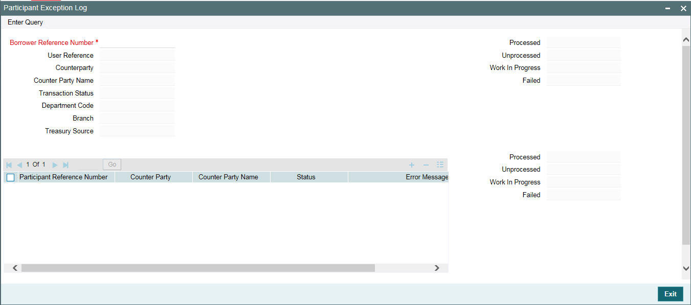

6.8.2 Processing in the ‘Job’ Mode
If the ‘Participant Process’ mode is set to ‘Job’ for your branch, you have to initiate a Background Job which picks up the participant contracts created in the system for further processing.
You have to initiate the Background Process as part of BOD programs run for the branch. The initiation is done through the ‘Participants Propagation’ (LBSPPROP)screen.
The ‘Job Status’ is ‘Job’. When you click the ‘Start Job’ button, the Background Job gets initiated in Oracle Banking Corporate Lending. In the ‘Job’ mode, after you save the borrower side contract, you can proceed with the next contract while the system processes the participant side contracts in the background. However, you can authorize the borrower side contracts only if the corresponding participant side contracts are processed successfully.
For successfully saved borrower contracts, the ‘Participant Processing Status’ (in the audit trail section at the bottom of the respective borrower contract) displays any one of the following statuses:
The status gets updated when the Background Job processes the participant contracts. After processing, the status reads ‘Processed’ or ‘Failed’, as the case may be.
Before executing the EOD operations for the branch, you have to stop the Background Job. This is mandatory. To stop the process, you have to click the ‘Stop Job’ button in the ‘Participants Jobs’ screen.
You can also view the details of borrower and participant contracts processed in Oracle Banking Corporate Lending in the ‘JOB PROCESS STATUS’ screen.
For more details on the above screen, refer the heading ‘Viewing borrower/ participant contract processing status’ in this chapter.

6.9.3 Viewing Settlement Instructions for the Participant
You can view the settlement instructions for the contract in the ‘Settlement Message Details’ screen. Click the ‘Settlements’ tab to view the details. The details are defaulted based on the SSI Mnemonic selected for the participant in the borrower tranche/drawdown.
For more details about the ‘Settlement Message Details’ screen, refer the Settlements User Manual.

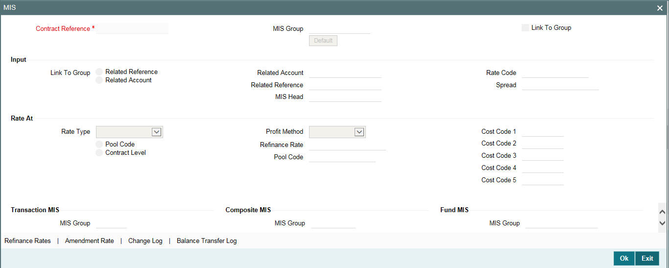

6.9.4 Viewing Participant MIS Details
If you have maintained MIS details for the participant tranche/drawdown product, the same will default to the participant tranche/drawdown. To view the details, click the ‘MIS’ tab.

6.9.6 Viewing Participant Tax Details
You can collect withholding tax from participants on the interest and fee components. If you have associated tax rules with the participant tranche/drawdown product, the same is become applicable to the contract. You can view the tax details for the contract in the ‘Tax Details’ screen.
Click the ‘Tax’ tab to invoke the screen.
For details on maintaining tax rules and schemes, refer the Tax User Manual.

6.9.8 Viewing Rates History
To view the margin rate history, click the ‘Rate History’ tab. The ‘Rates History’ screen is displayed, as shown below:
The following details are displayed on this screen.
6.9.8.1 Viewing Margin History
You can view the participant’s margin details that are applicable for the contract, by clicking the ‘Margin History’. The ‘Rates History’ screen is displayed, as shown below:
Margin Details
Margin Rates
6.9.9 Viewing the Syndication Details
To view the details of the syndication, click the ’LB’ tab. The ‘Syndication Details’ screen is displayed, as shown below:
In this screen, you can view the reference numbers of contracts created both for the borrower and the participant involved in the syndication.
After you save the contract, you can view the following details of the contract:

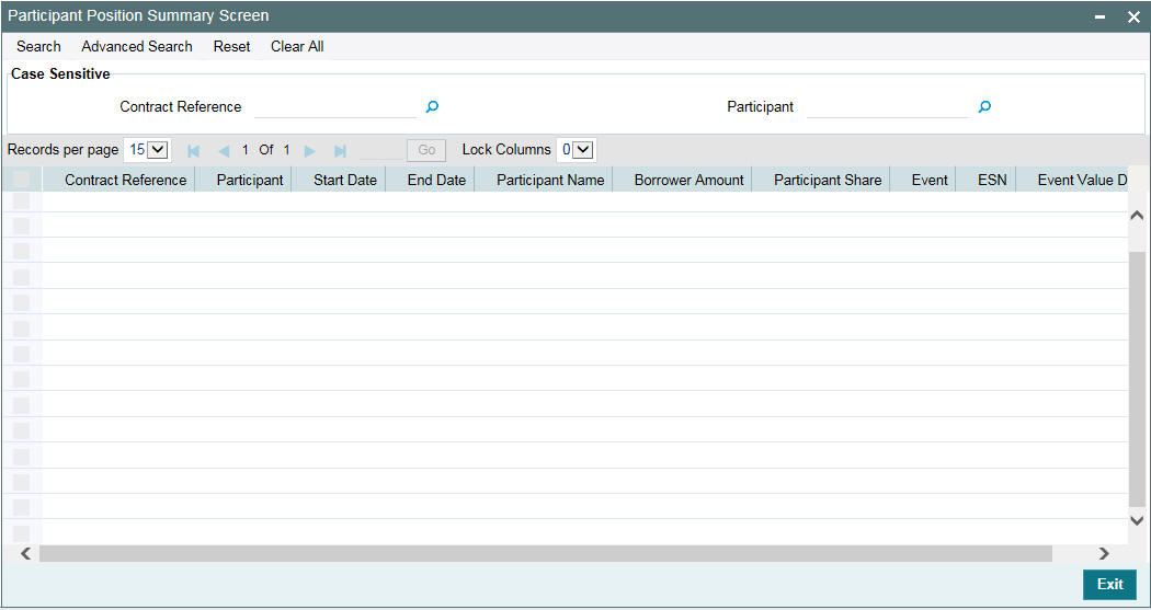

6.10 Participant Position Summary
You can view the participant position summary in the Participant Position Summary screen.
You can invoke the ‘Participant Position Summary’ screen by typing ‘LBSPTPSN’ in the field at the top right corner of the Application tool bar and clicking the adjoining arrow button.
You can view the position details of the participants, for different dates, using this screen. To view details, query using any of the following fields in the Participant Position summary screen:
The following fields are displayed in this screen
You can use this screen to query the details for self-participants and also for external participants.

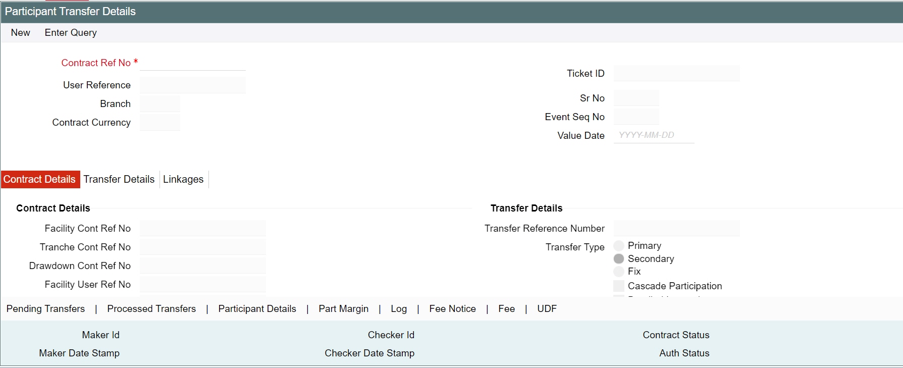

You can use the ‘Participant Transfer Details’ screen for the following purposes:
Addition of new participant is allowed from a facility and is available for the tranches and drawdowns processed under it. When you invoke the screen, the following contract details are available:
When you perform a back value participant transfer and when tranches for which ‘Cascade Participation’ is selected, the following happens:
When you perform a back value participant transfer and when tranche contracts for which ‘Cascade Participation’ is not selected following happens:

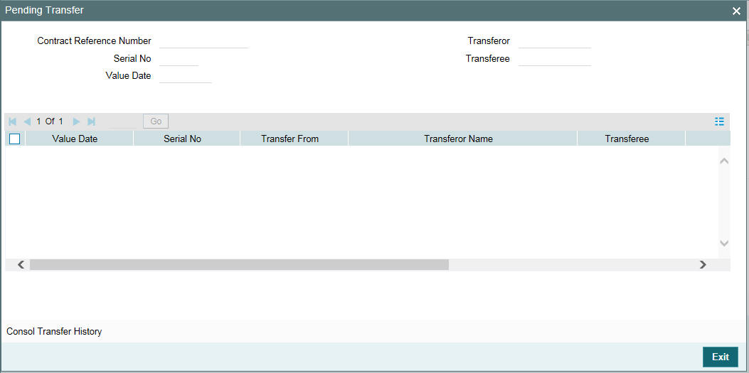

You can perform future dated participant transfers for pro-rata tranches. You can specify a future date as the value date for the transfer.
The following table lists out the events associated with future dated participant transfer.
Event
Description
PAMB
Future dated PRAM instruction booking
PAMI
Future dated PRAM instruction Initiation (will happen on value date)
PAMA
Modification of future dated PRAM instruction
PAMC
cancellation of future dated PRAM instruction
If any back/current dated activity is performed on a tranche and underlying drawdowns before the value date of the future dated Participant Transfer instruction, the system rebuilds the asset ratio for the future dated transfer.
The following events result in a change in the asset ratio of FD PRAM:
The following events are impacted by future dated Participant Transfers:
If the future dated Participant Transfer instruction is unauthorized you are allowed to perform activities like LIQD, VAMI, and PRAM. If an unauthorized FDPRAM exists along with other unauthorized current/back dated PRAM instructions, authorizationis allowed for the earliest instruction based on the value date.
Note
Linkage Tab
The system defaults the linkage details for the contract. You can edit the linkage details during PRAM and the same gets updated at the contract and the limits are updated accordingly.

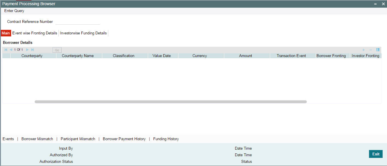

In the ‘Payment Processing Browser’ (LBDMTPRC) screen, the following details are updated for participant transfer with existing participants during participant transfer authorization based on the latest ratio for future-dated events:
For participant transfer with new participants, system adds the new participants to the existing list of participants in the ‘Payment Processing Browser’ screen. The fronting value is defaulted as follows:
For more details, refer section ‘Processing the Release of Payment Messages’ in this User Manual.

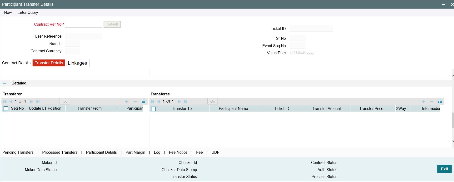

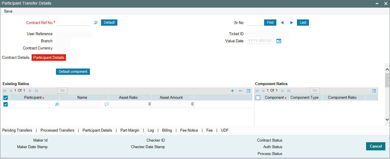

To transfer assets from one participant to another, you have to select the reference number of the contract for which you want to initiate the asset transfer amongst the participants.
  1. Enter the Contract Reference Number. You can either enter or select from the option list.
  2. Click ‘Default’ button.The system defaults the contract details.

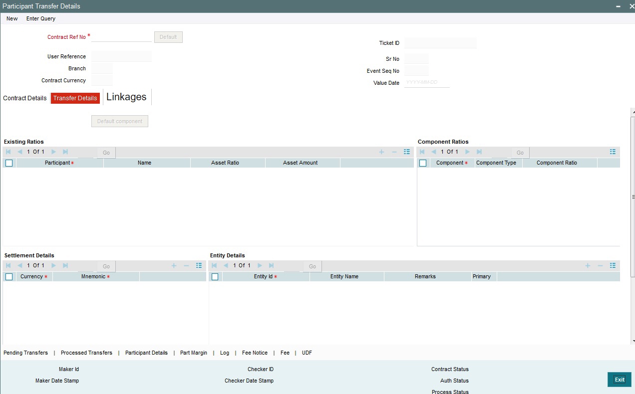

  3. Click ‘Transfer Details’ tab
You can either click ‘Add Row or ‘Delete Row’ to add or delete participants. The ‘Participant Selection’ screen is displayed.
In this screen, you can view the existing participants of the contract.
The ‘Participant Transfer Details’ screen displays the following details:
You have the option to capture a consolidated type of transfer instruction or a detailed instruction for each participant. By default, the system takes you to the ‘Consolidated’ tab of the ‘Participant Transfer Details’ screen.
The system ensures the following when you capture the transfer instructions:

Send Message
Select this check box to indicate if the fax messages have been generated for this participant with the details of the transfer.

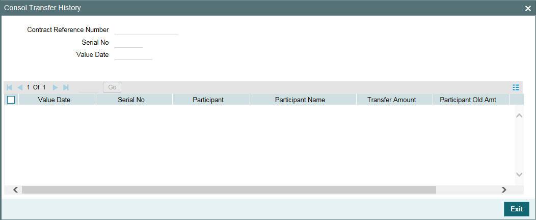

6.12.2.2 Capturing Consolidated Transfer Instructions
Select the name of the participants between whom you want to asset transfer in the ‘Consolidated’ tab of the ‘Participant Transfer Details’ screen. For a given value date, you can capture the net amount transferred to and from each participant.
For the participant who is the transferor, specify the amount with a negative sign (to indicate that the transfer is ‘From’ the participant).
Note
The sum of the transfer amount across all participants should be zero.
While maintaining the consolidated transfer instruction, you cannot visit the ‘Detailed’ section of the screen. The system displays the following error message:
Transfer Instruction Type is consolidated. Cannot enter detailed transfer instructions.

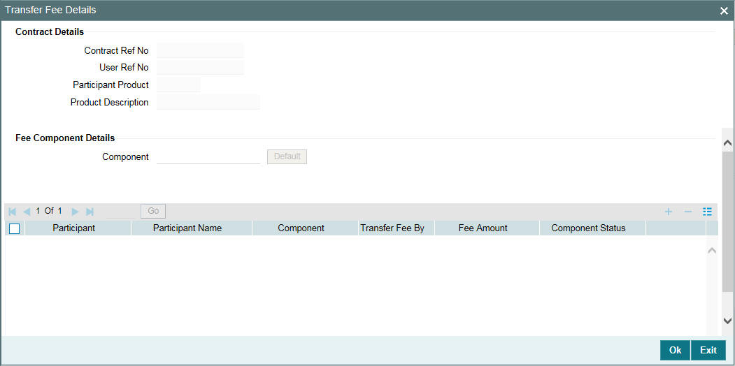

6.12.2.4 Capturing Transfer Fee Details
You, as the lead agency, have the option to collect transfer fee for the asset transfer between participants. The fee can be charged to both the transferor and the transferee.
You can collect fee from participants only if fee components are associated with the participant product involved in the contract. In addition, the fee components should be defined with the following attributes:
For details on defining product level fee components, refer the heading ‘Specifying fee components with the product’ in the ‘Defining Products for Loan Syndication’ chapter of this User Manual.
You can capture the fee details in the ‘Transfer Fee Details’ screen. Click ‘Fee’ tab to invoke this screen.
You can capture the following transfer fee details in this screen:
Component
The applicable fee components defined for the participant product is available in the option list. You can select one of them to collect the transfer fee. After you select the component, the following details are displayed:
Fee Amount
Specify the amount to be collected as fee. The fee is expressed in the contract currency. This is collected as one time fee and hence requires no schedule definition.

6.12.2.7 Adding a New Participant
To add a new participant
  4. Click the ‘Add Row’ from the ‘Existing Ratios’ section and click ‘Default Components’.
You can define the following:
LMA/LSTA Participation
The following are the list of values in the ‘LMA / LSTA Participation’ drop-down list.
You are allowed to select the value during new tranche contract creation. In the drawdown creation screen, the value is defaulted from the tranche contract and you are not allowed to edit the same.
Note
LMA / LSTA participation is applicable only for ‘Cascade Participation’.
The default value of ‘LMA / LSTA Participation’ is ‘Non-Standard’ during new tranche con­tract creation. However, you are allowed to manually update the same to ‘LMA Participa­tion’ / ‘LSTA Participation’.
The system validates at the time of clicking ‘Ok’ button in the participant sub screen if position identifier and portfolio maintenance is present with the ‘LMA / LSTA Participation’ value selected when you create a tranche contract with the new field value for ‘LMA/LSTA Participation’. Appropriate error messages are displayed if the validation is failed.
When the ‘LMA / LSTA Participation’ value is selected ‘Non-Standard’ for a participant for whom the ‘LMA / LSTA Participation’ is selected in the portfolio / position maintenance, the system displays an error message advising ‘LMA Participation’ is selected at position identifier or portfolio maintenance for $1.LMA/LSTA Participation flag cannot be Non-Standard when self-participation flag is checked for this participant’ at the time of save.
You have to either change the value of the field to ‘LMA Participation’ / ‘LSTA Participation’ or clear the ‘Self-Participation’ check box and proceed to save the contract.
The ‘Self Participant’ check box is selected and disabled if the value ‘LMA /LSTA Participation’ is selected.
Note
If the value ‘Non-Standard’ is selected , the ‘Self Participant’ check box is cleared and dis­abled.
The value of the ‘LMA / LSTA Participation’ is not editable during contract amendment.
When you select the value for ‘LMA / LSTA Participation’, there will not be any validations to check if the linked trade contract has the similar value in the field ‘Trade Standard’.
When a participant transfer or value dated amendment is processed for tranche / drawdown contracts with value selected in the ‘LMA / LSTA Participation’, the same value is defaulted to the participant sub-screen in the corresponding tranche and drawdown contracts.

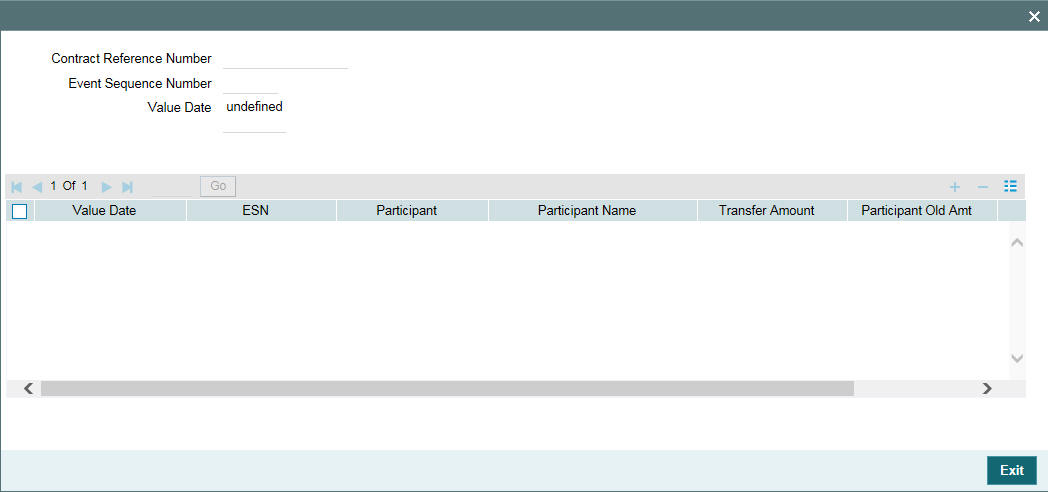

The ‘Participant Transfer Details’ screen looks as shown below:
After capturing the necessary details, save and authorize the record. You can then select the tranche processed under the facility (to which new participants have been added) and transfer the assets appropriately between the existing and new participants. Viewing Details of Processed Transfers
You can view all ‘Detailed’ authorized transfer instructions in the ‘Processed Transfer Details’ screen. To invoke this screen, click ‘Processed Transfer’ tab.
In this screen, you can view the following details of a transfer transaction:
You can also view the net amount transferred from/to each participant (for ‘Consolidated’ transfer instructions) in the ‘Processed Transfers - Consolidated’ screen. To invoke this screen, click ‘Console Transfer History’ button.
The ‘Transfer Amount’ with a negative sign indicates that the transfer is ‘From’ the participant. If the transfer is ‘To’ the participant, the amount will be shown with a positive sign.
6.12.2.8 Viewing Details of Pending Transfers
You also have the facility to view details of all pending transfer instructions in the ‘Pending Transfer’ screen. To invoke this screen, you have to click ‘Pending Transfer’ tab in the ‘Participant Transfer Details’ screen.
For each pending transfer, you can also view the net amount transferred from/to each participant in the ‘Pending Transfers - Consolidated’ screen. To invoke this screen, click ‘Console Transfer History’ button.

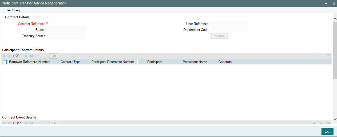

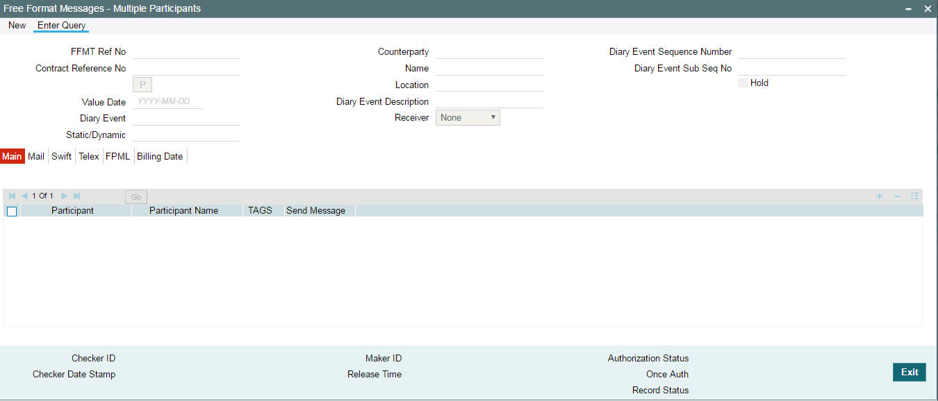

6.12.4 Generating Third Party Faxes
Oracle Banking Corporate Lending enables you to send faxes to all the participants on Participant transfer (Assignment) Processing with the following details:
After the Participant Transfer is authorized, an override message gets generated for regeneration of Pending Advices. Regeneration of pending advices/notices is for the existing participants with event based notices, event based rate fixing advices and event based payment notices. You can view the list of existing affected participants and advices for the existing affected participants with Pending Status in the ‘Participant Transfer Advice Regeneration’ screen.
You can invoke the ‘Participant Transfer Advice Regeneration’ screen by typing ‘LBDPTADV’ in the field at the top right corner of the Application tool bar and clicking the adjoining arrow button.
You can view the following details here:
Generate
The generate check box is selected for all the investors and the events for regeneration. However, you can also clear the check box.
After the generation of selective advices, the status gets updated to ‘Regenerated’ from pending.
Note
Regeneration of Free format is possible only when billing date is in future. The contracts which got the cascade participation are applicable for regeneration. Advices are also re­generated for new participants added as part of participant transfer. The system identifies the events for which advices have to be regenerated based on the advice events whose value dates are greater than the system date. Event value date should be greater than or equal to assignment date for the events other than NOTC and for NOTC it should be great­er than the assignment date.

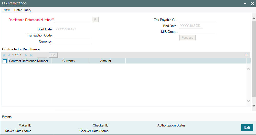

6.13 Remitting Withheld Tax
Oracle Banking Corporate Lending enables you to remit the withheld tax amount that was not remitted for a period, to the Central Bank. The tax administrators will review the tax withholdings of all participants at regular intervals. They will select the tax withholdings that need to be sent to the internal Treasury Tax Loan (TTL).
Tax is remitted to the Central Bank using the ‘Tax Remittance’ screen. You can invoke the ‘Tax Remittance’ screen by typing ‘LBDTARMT’ in the field at the top right corner of the Application tool bar and clicking the adjoining arrow button.
Enter the following details:
Remittance Ref No
For any remittance, you need to click ’New’ from menu. System generates a unique 16 digit reference number and populate the same here. For example, the format of the reference number will be as follows - CT4ZTRM043660065 where;
You can query the remittance made in the past using the remittance reference number.
Tax Payable GL
The tax remitted amount will be credited into this GL account. The option list will display all internal GLs of the branch.
Start Date
Select the date from when you want to remit the tax withholdings. The drop-down list will display all the withholding tax have been booked from this date.
End Date
Select the date till when you want to remit the tax withholdings. The drop-down list displays all the withholding tax have been booked till this date.
Transaction Code
The transaction code you specify here will be used to pass liquidation entries. The option list displays all transaction codes maintained in the ‘Transaction Code Maintenance’ screen.
For more details on transaction codes, refer the chapter ‘Transaction Code Maintenance’ in the Core Services (CS) User Manual.
MIS Group
Select the MIS Group from the list of values. The accounting entries are posted with MIS details associated with the MIS group.
Currency
This is the currency in which the tax that has been withheld needs to be remitted.
Note
System does not post accounting entries or fire events after remitting tax for any LB con­tract.
Once you enter the above details, click the ‘Populate’ button to view details under ‘Contracts for Remittance’. Here, system will display all the withheld tax entries for the specified period in the currency you have selected.
If you change the Start Date, End Date or Currency, you will need to click the ‘Populate’ button to update the details displayed under ‘Contracts for Remittance’.
Contract Ref No.
The reference number of the facility, tranche and drawdown contracts against which the tax was withheld is displayed here.
System displays the tax currency and the total tax amount that was withheld against the participants of the contract. Click ‘Events’ to view the ‘Event Log Details’ screen.
For more details on the ‘Event Log Details’ screen, refer the section titled ‘Viewing events for the facility’ in the ‘Loan Syndication Contracts’ chapter of this User Manual.
You can execute the following operations in the ‘Tax Remittance’ screen:
Note

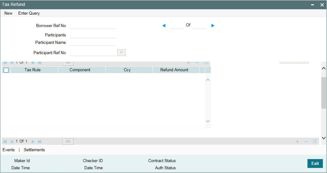

6.14 Refunding Withheld Tax
Oracle Banking Corporate Lending enables you to refund the withheld tax amount when there is fluctuation in the interest rate, or change in the tax status. The tax administrators review the previous tax withholdings of all participants and select those withholdings that need to be refunded. System calculates and refunds the total amount to the participants through wire transfer.
Tax is refunded to the participants using the ‘Tax Refund’ screen. You can invoke the ‘Tax Refund’ screen by typing ‘LBDTXREF’ in the field at the top right corner of the Application tool bar and clicking the adjoining arrow button.
In the above screen, system displays all the withheld tax components. The following details will be displayed:
Borrower Ref No.
Specify the reference number of the borrower contract for which you want to refund the tax.
Participant
From the option list select the participant for whom you want to refund the tax.
Participant Ref No.
System displays the reference number of the participant.
Tax Rule
System displays the tax rule associated with the contract.
Component
System displays the component against which the tax rule is associated.
Ccy
This is the currency in which the Tax that has been withheld which needs to be remitted.
Refund Amount
This is the sum of all the Refund Amount specified under ‘Schedule Details’.
System will display the schedule details of the components:
Tax Rule
This is defaulted from the Tax Rule under ‘Component Details’.
Tax Due Date
System displays the due date of the component with which the tax rule is associated.
Tax Collection Date
This is the date on which the component was liquidated.
Amount
This is the maximum tax amount that can be considered for the refund for a Tax rule, Due Date and collection date combinations for the given participant of an LB contract. System calculates this amount considering the impact of the past refunds and the remittances.
Refund Amount
You can specify the amount you wish to refund to the participant. You can choose to refund the tax withholdings in partial or full. The amount in the Amount field is defaulted here. You can, however, change the amount. If you specify zero, it indicates that you do not want to refund any amount.
Click ‘Settlements’ tab in the ‘Tax Refund’ screen to invoke the ‘Settlement ’ screen. This screen displays the customer’s account where the refund amount is credited.
Click ‘Events’ tab to invoke the ‘Event ’ screen. This screen displays the accounting entries posted with TXRF (Tax Refund) and TXRV (Reversal of refund) events.
Click ‘Media Priority’ button to invoke the ‘Media for Message Generation’ screen. You can specify the media for the message generation in this screen. This buttonis enabled only if the ‘FpML Type’ option is unchecked at the contract level and the ‘Media Priority’ option is selected at the product level.
If this button is enabled, then the system displays an override message saying to view the ‘Media for Message Generation’ screen. If not, the system handoffs the message as per the details maintained in the ‘Customer Entity Maintenance’ screen.
For more information on ‘Settlement Message Details’ screen, refer the Settlements User Manual.
For more information on the ‘Media for Message Generation’ screen, refer the section ‘Specifying Media for Message Generation’ of this chapter.
You can execute the following operations in the ‘Tax Refund’ screen:

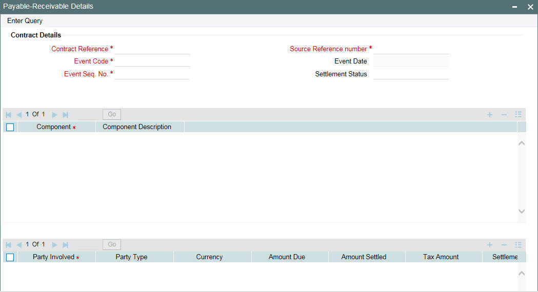

6.15.1 Viewing the Receivables/Payables for a Contract
In Oracle Banking Corporate Lending, you have the ‘Payment–Receivable Details’ screen through which you can view the receivable/payable amounts for a drawdown. You can invoke the ‘Payable-Receivable Details’ screen by typing ‘LBDPRDET’ in the field at the top right corner of the Application tool bar and clicking the adjoining arrow button.
For a drawdown/tranche, this screen displays the receivable/payable amounts for each component and the associated event. Based on the last event which has occurred in the life cycle of the contract, the corresponding event sequence number gets defaulted in the ‘Event Seq No’ field. Once the payable and the receivable amounts are settled across all the components for a particular contract, the system updates the ‘Settled Status’ field to ‘Settled’.
All the components for a contract are displayed in the ‘Component Details’ section.
For each component of the drawdown/tranche, the system displays the following details:
Note
If the tax rules are tagged to the components and if the tax is applicable, the system also passes the necessary accounting entries for tax.
You can use the navigation buttons - provided in the toolbar to scroll through the tranches and drawdowns.

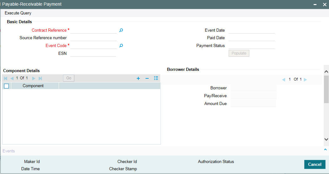

6.15.2 Processing Settlement of Receivables/Payables for a Contract

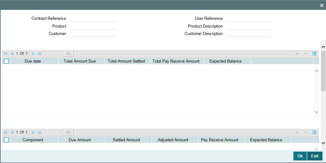

You can process settlement of a payable/receivable amount in the ‘Payable – Receivable Payment’ screen. Click the ‘Payment’ button to access this screen. This screen shows the amounts payable and receivable for the contract chosen in the ‘Payable – Receivable Details’ screen.
Note
You also have the provision to invoke the ‘Payable-Receivable Payment’ screen directly from the Application Browser. To do so, choose LB Operations and double-click on the Payment option under the Payable Receivable sub-menu. In this case, you need to se­lect the tranche/drawdown from the option list provided. In addition, you need to select the relevant event from the ‘Event Code’ option list provided. The corresponding event se­quence number gets defaulted in the ‘Event Seq No’ field here.
To view the components due for the selected contract, click “Populate’ button. The following details are displayed:
Liqd Reqd
By default, this option is checked for all the participants. However, you can choose to liquidate the payable/receivable amount for selective participants only. To do so, you need to check this option against the appropriate participant (s) and uncheck the same for the others.
Note
The receivables from any party (participant or borrower) should be liquidated in a single instance. For instance, if the amount receivable from a borrower is USD 6000, the same has to be settled entirely including the settlement of individual participant share. Likewise, the amount receivable from participants can be settled individually or with other partici­pants. However, you are not allowed to do a partial liquidation within the individual partic­ipant amount.
Apply Tax
Tax is calculated upfront based on whether tax is applicable for the contract. However, at the time of payment, you can check this option to apply tax on the receivable/payable amount. To waive tax, uncheck this option. Your selection here is updated in the ‘Payable-Receivable Details’ screen.
Click button to move between the ‘Component Details’ and ‘Participant Due Details’ sections of the screen.
After capturing the amounts to be settled against the components, click ‘Save’ to save the payment. Click ‘Exit’ button to exit the screen and return to the ‘Payable-Receivable Details’ screen. The ‘Amount Settled’ field in this screen is updated accordingly.
Note
You can reverse a payment of a payable/receivable by clicking the ‘Reverse’ from the menu. This option is enabled only if you access the above screen directly from the Appli­cation Browser (to do this, you need to choose LB Operations and double click on the Payment option under Receivable Payable.

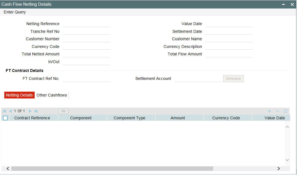

6.19 Netting Cash Flows for a Tranche
You can maintain netting preferences for borrowers and participants of a tranche in the ‘Borrower Details’ sub-screen and the ‘Participant Ratio Details’ sub-screen of the ‘LB Tranche Contract Online’ screen.
For a borrower, you can choose one of the following as the netting preference (in the ‘Borrower Details’ sub-screen of the ‘LB Tranche Contract Online’ screen):
Similarly, for a participant, the following options are available for netting (in the ‘Participant Ratio Details’ sub-screen of the ‘LB Tranche Contract Online’ screen):
You can view the borrower and participant side contracts for a tranche, for which netting is applicable, in the ‘Loans Syndication Netting Cash Flow Summary’ screen.
Netting takes place only if the following parameters for a cash flow are same:
6.19.1 Viewing the Contracts for Netting
In this screen, you can specify the following to view:
6.19.2 Netting the Components
To net the components for a contract, select the contract from the summary screen and double-click on it. The ‘Cash Flow Netting Details’ (LBDNETCF) screen is displayed, as shown below:
You can view the following details in the ‘Netting Details’ tab of this screen:
The ‘Other Cashflows’ tab of the screen displays all contracts till date which need to be netted.
You can check the ‘Netted’ option for these contracts if you want to net them along with the current contracts.
After selecting the contracts for netting (in the ‘Netting Details’ tab of the screen), you have to click the ‘Resolve’ button to continue. If pending cashflows are present in the ‘Other Cashflows’ tab, system will display a message to indicate the same. The system will display a message to seek confirmation to resolve the selected contracts. Select ‘OK’ in the message window to continue.
If netting is successful, system will update the ‘FT Contract Details’ section of the screen with the following details:

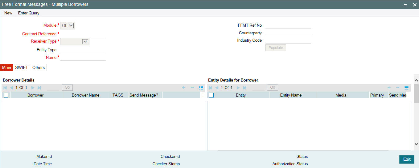

6.20 Free Format Messages for Loan Syndication Con­tracts
You can enable the system to generate free format messages with respect to loan syndication contracts, by using either of the following options:
You can generate free format for multiple participants or borrowers.
6.20.1 Generating Free Format Messages for Multiple Participants
You can invoke the ‘Free format message’ screen by typing ‘OLDFFMSG’ in the field at the top right corner of the Application tool bar and clicking the adjoining arrow button.
Thereafter, select ‘New’ from the menu. The Free Format Message screen is displayed without any details. Alternatively, you can also select invoke this screen by clicking the ‘PartFFT in the ‘Contract Diary Event’ screen.
When you click on the ‘New’ button, system automatically generates a unique ‘FFMT Reference No’ for the free format message.
6.20.1.1 Specifying Message Details
You have to specify the following in the ‘Message Details’ section of the screen:

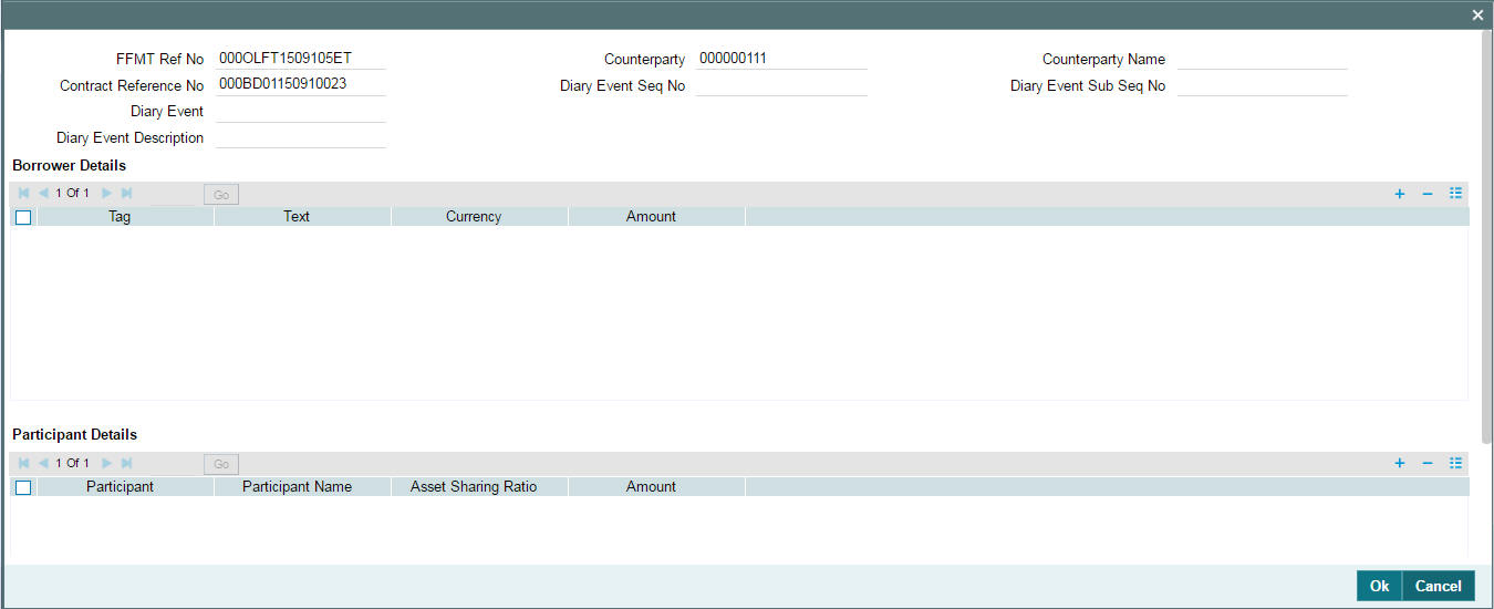

6.20.1.12 Specifying ‘ProRata’ Message Details
If you select the ‘Message Type’ as ‘ProRata’, you have to specify the pro-rata tag values. To do this, click the ‘Prorata Tag Values’ button in the ‘Free Format Messages – Multiple Participants’ screen. However, you can enter the tag values only if the message is specified in the ‘Message’ section of the screen. If not maintained, the system displays an override to indicate the same.
You can use a template to capture the message format. Refer the heading ‘Capturing the free format message’ in this chapter for details on the same.
6.20.1.13 Selecting Pro-Rata Tags for the Message
When you right-click on the ‘Message’ section of the screen. When you select the ‘TAGS’ option, a list of pre-defined loan syndication module tags will be displayed as shown below:
You can select the required tags one by one, to be included in the message. After selecting the tags, you have to specify the values for the same.
Note
Only those Tag IDs that you have defined for the Message Type ‘ProRata’ in the Free For­mat Message Tags screen is available for use.
6.20.1.14 Specifying Pro-rata Tag Values
You can specify the tag values in the ‘ProRata TAG Values’ screen. To invoke this screen, click the ‘Prorata Tag Values’ button.
Specify the following details in the screen:
The system automatically computes the breakup details of the components for the participants based on the amount you enter and the asset sharing ratio. The following details are displayed in the ‘Participant Details’ section of the screen:

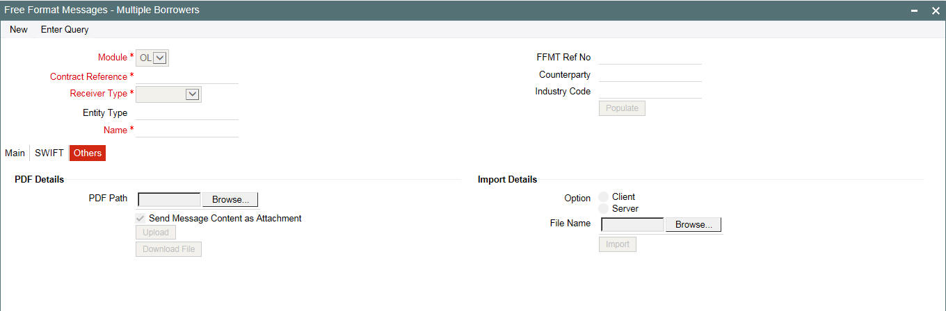

You can upload and download the PDF file using 'Free Format Messages -Multiple Borrowers' and 'Free Format Messages -Multiple Participants' screen.
You can upload the PDF file from your local system or shared area.
The uploaded PDF file is sent as e-mail attached to the borrowers/participants. You can draft content to be sent be sent to the borrowers/participants in the body of the email message.
