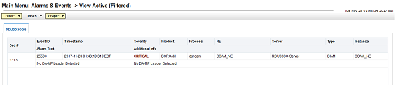

- Examine the alarm
log from
Main Menu > Alarms & Events on
Active SOAM Server.
- This alarm is raised against the Network Element when no DA-MPs report themselves as Leader.
- Examine the alarm
log from
Active SOAM Server.
