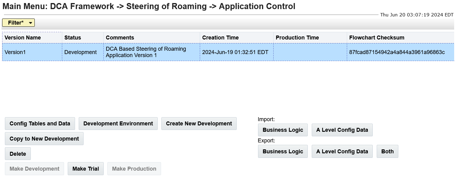

Perform the following procedure to migrate the NOAM Level configuration data:
- Export the NOAM configuration data on the previous release setup.
- Log in to the NOAM GUI.
- From the Main Menu, navigate to DCA Framework, and Steering of Roaming, and then Application Control. Ensure that an entry is added in DCA application version details table.
- Select the required Steering of Roaming version name.
- Click A Level Config Data in the
Export section of the Application
Control page.
Figure 3-1 Application Control Page
- To import the configuration data to a new release setup, the SoR application should be fresh installed on a new release. The application should be deactivated, then activated, and then NOAM json file of the upgraded release should be imported.
- Perform the following procedure to import the NOAM configuration data
on the upgraded setup:
- Log in to the active NOAM GUI.
- From the NOAM GUI Main Menu, navigate to DCA Framework, and Steering of Roaming, and then Application Control.
- Click A Level Config Data in the Import section of the Application Control page, select the file, and then click Import to import the NOAM configuration data.
