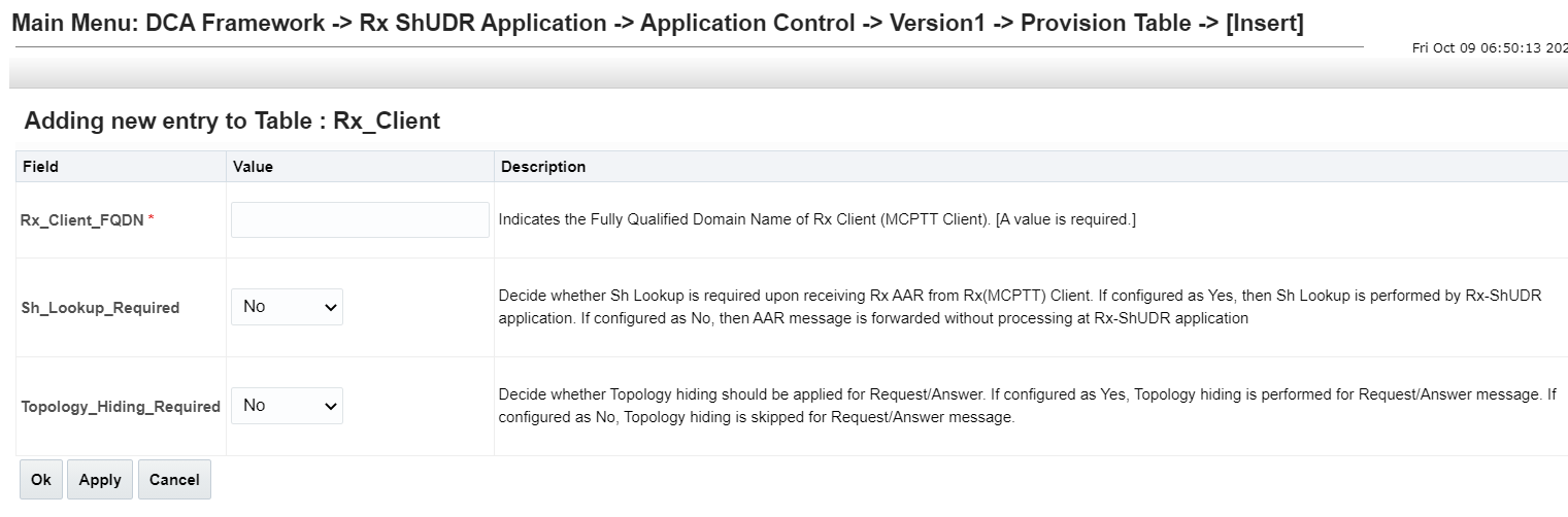

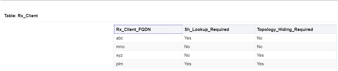

Rx_Client Table
This is the first table Application lookup when Rx Initial message is received from client.
Figure 4-1 Rx_Client Provision Table
Figure 4-2 Rx_Client Provision Table Insert Screen

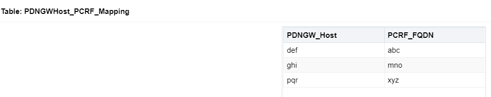

PDNGWHost_PCRF_Mapping Table
This table gets the PCRF address from PDNGW_Host received from HSS (Sh:UDA Response).
Figure 4-3 PDNGWHost_PCRF_Mapping table
Figure 4-4 PDNGWHost_PCRF Provision Table Insert Screen

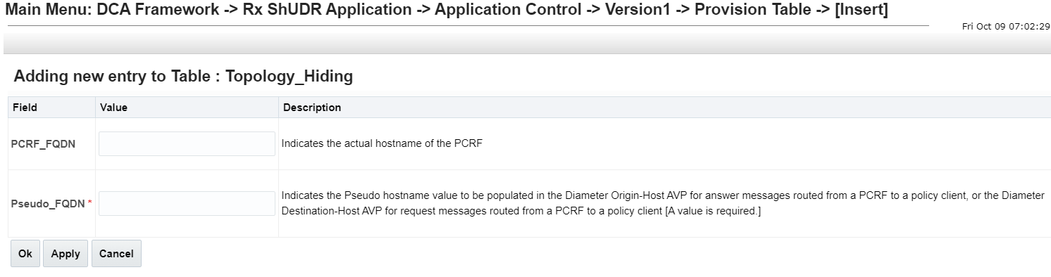

Topology_Hiding Table
This table is used when a AAA Response is reeived from PCRF, message generated from PCRF, message generated from Rx Client other than AAR Initial message for apply the topology hiding (replace the PCRF address with Pseudo FQDN).
Figure 4-5 Topology_Hiding table Provision Table
Figure 4-6 Topology_Hiding Provision Table Insert Screen

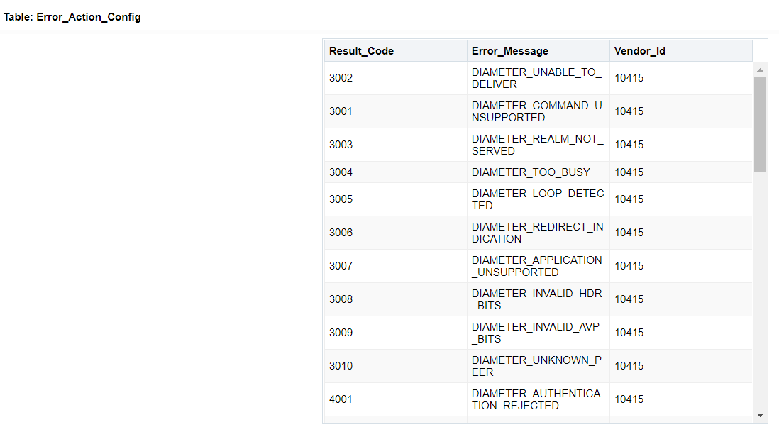

Error_Action_Config Table
This table used when non success response is received from HSS (Sh:UDA Response from HSS) to map to AAA Response (Result code, Error Message, Vendor Id).
Figure 4-7 Error_Action_Config table Provision Table
Figure 4-8 Error_Action_Config Provision Table Insert Screen

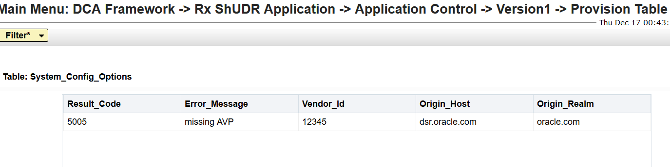

System_Config_Options Table
This table is used to configure system wide configuration that is used for Sh UDR message creation and sends the error response to Rx Client.
Figure 4-9 System Config Option table
