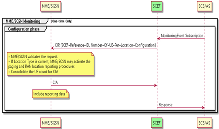

Monitoring Event Subscription Request to MME/SGSN
This procedure is used between SCEF and MME and between SCEF and SGSN to configure the monitoring events directly at the MME/SGSN through the T6a/b interface.
When the procedure is invoked by SCEF, it is used for configuring the
number of UEs at a given geographic location. Each SCEF Reference ID MME/SGSN
is able to process successfully, it includes the exact number of UEs known to
be at the requested location in the Configuration-Information-Answer.
Figure 2-11 Monitoring Event Subscription Request to MME/SGSN
