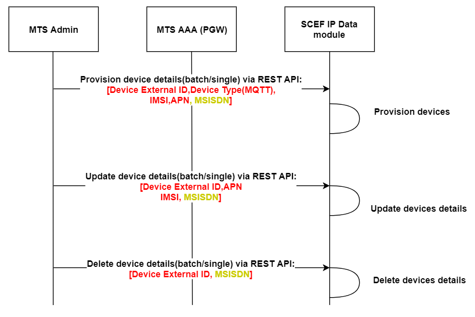

IP Device Provisioning
Operator need to provision devices in MQTT broker before the device connects to broker.
- Broker provides a REST
based interface for single/batch IP device provisioning/deletion.
Refer to the Sample json Body for more details.
Below device data must be provisioned in broker:- Device External
Id/MSISDN (either one can be present, if both are present, the
ExternalIdtakes precedence) - Device Type (MQTT or CoAP) (MQTT-2, CoAP-1)
- IMSI
- APN (device that is used to connect to operator's network)
- Device External
- Provisioned devices can be
updated with details of IMSI, APN and IP address of current device using the
PATCH operation for the matching External Id or MSISDN.
If both External Id and MSISDN are provided, then the External Id is given priority and the devices matching the External Id is updated. Only in the absence of External Id, the MSISDN is considered. Refer to the Sample json Body for more details.
- Provisioned devices can be deleted using the POST operation of rest interface for the matching External Id or MSISDN. If both External Id and MSISDN are provided, then External Id is given priority and the devices matching External Id are deleted. In the absence of External Id, MSISDN is considered.

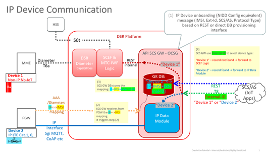

AAA Server Integration
- AAA server integration
feature enables identifying MQTT devices with device IP. When device connect to
operator network, P-GW (AAA server) will send Diameter ACR Start (Account
creation request-271 Command Code) message to AAA interface. The following
information from the request will be collected and updated in the device
profile.
- Called-Station-Id (APN)
- User-Name (IMSI)
- PDP-Address (IP)
- When MQTT device sends CONNECT to broker, device details are retrieved using the device IP and device is identified with corresponding External Id or MSISDN. External Id or MSISDN is used to communicate MO or MT delivery notifications to SCEF application.
- Diameter ACR Stop - When Diameter ACR Stop (Terminate) message is sent then mapping between IMSI and IP will be removed from the device profile and the device will be disconnected if connected.
Figure 2-40 SCEF MQTT Broker - AAA Server Integration
Figure 2-41 SCEF MQTT Broker device provisioning
