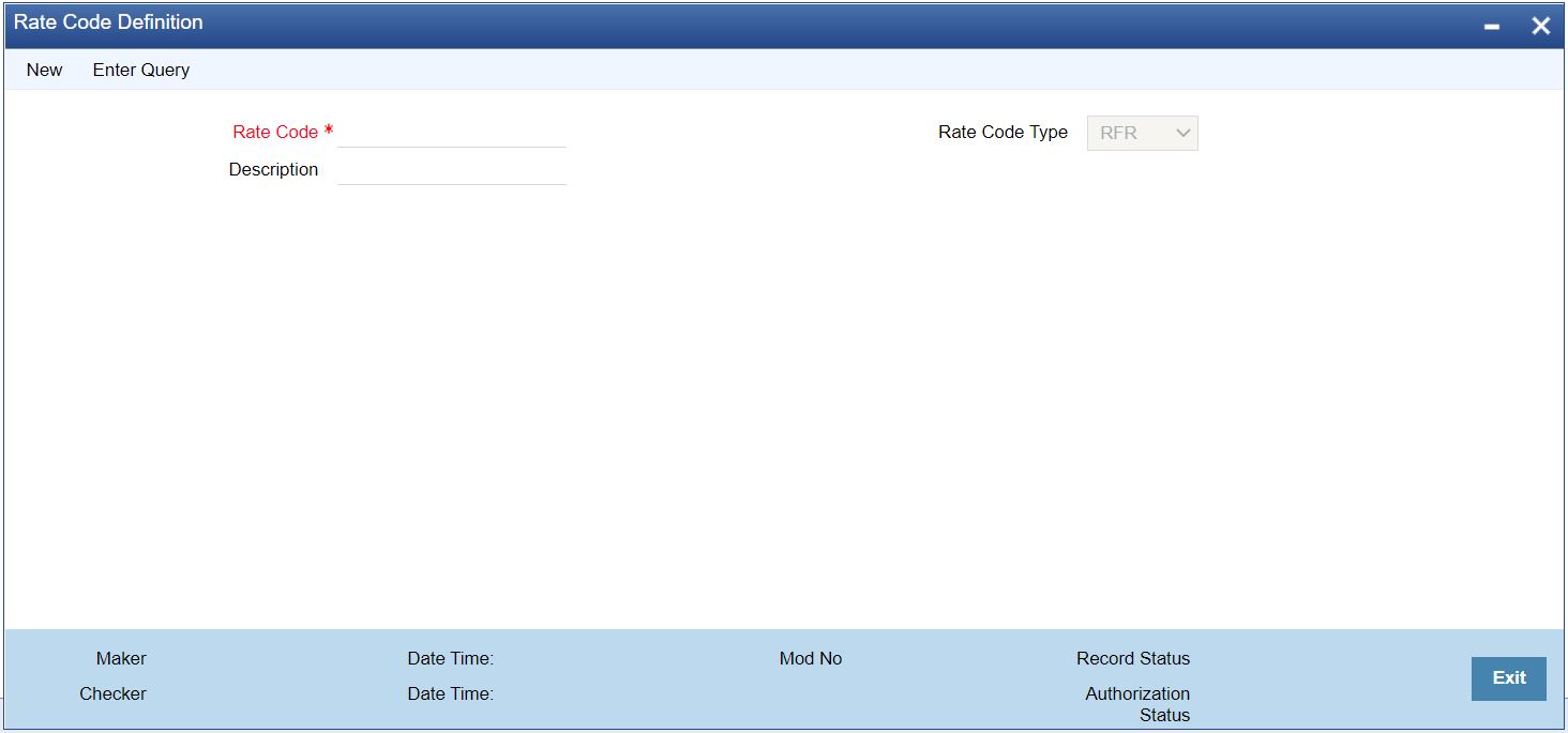

11.2 Define Rate codes for Risk Free rates
This topic provides the instructions to define the rate codes for risk free rates.
Context:
RFR codes is maintained at the Rate Code Definition screen.
1.On the Homepage, type CFDFRTCD in the text box, and click the next arrow.
Step Result:   Rate Code Definition screen is displayed.
Figure 11.1: Rate Code Definition
2.Specify the fields in the Rate Code Definition screen
Select Rate Code Type from the drop-down list. By default, the system displays the value
as RFR which is used to maintain the RFR rate for the rate code. You can also select Inflation or Other based on the required maintenance.

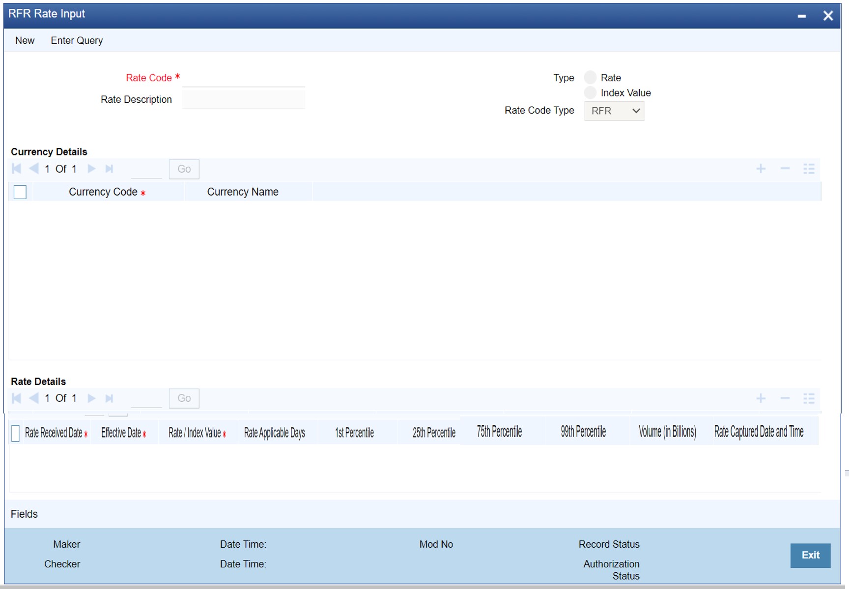

11.3 Risk Free Rates
This topic provides the instructions to capture the Risk Free Rates.
Context:
Selected Overnight Risk Free rates is maintained in this screen.
1.On the Homepage, type CFDRFRRT in the text box, and click the next arrow.
Step Result:   RFR Rate Input screen is displayed.
Figure 11.2: RFR Rate Input
2.On the RFR Rate Input screen, specify the details as required.
For information on fields refer to:
Table 11.1: RFR Rate Input - Field Description
Field
Description
Rate Code
Identifies the Risk Free Reference Rate Code
Rate Description
Defines the RFR rate code
Type
Choose the type of Maintenance:
Rate
Index
Currency Code
   Identifies the currency mapped to RFR code
Rate Received Date
   The date on which our system received the RFR rate
Effective date
Applicable RFR effective date
Interest rate
    RFR on the respective effective date
Rate Applicable days
Number of days the RFR is applicable for
Percentile
Percentile of RFR defined as 1st, 25th,75th and 99th
Volume in Billions
Identifies the RFR volume in count of billions

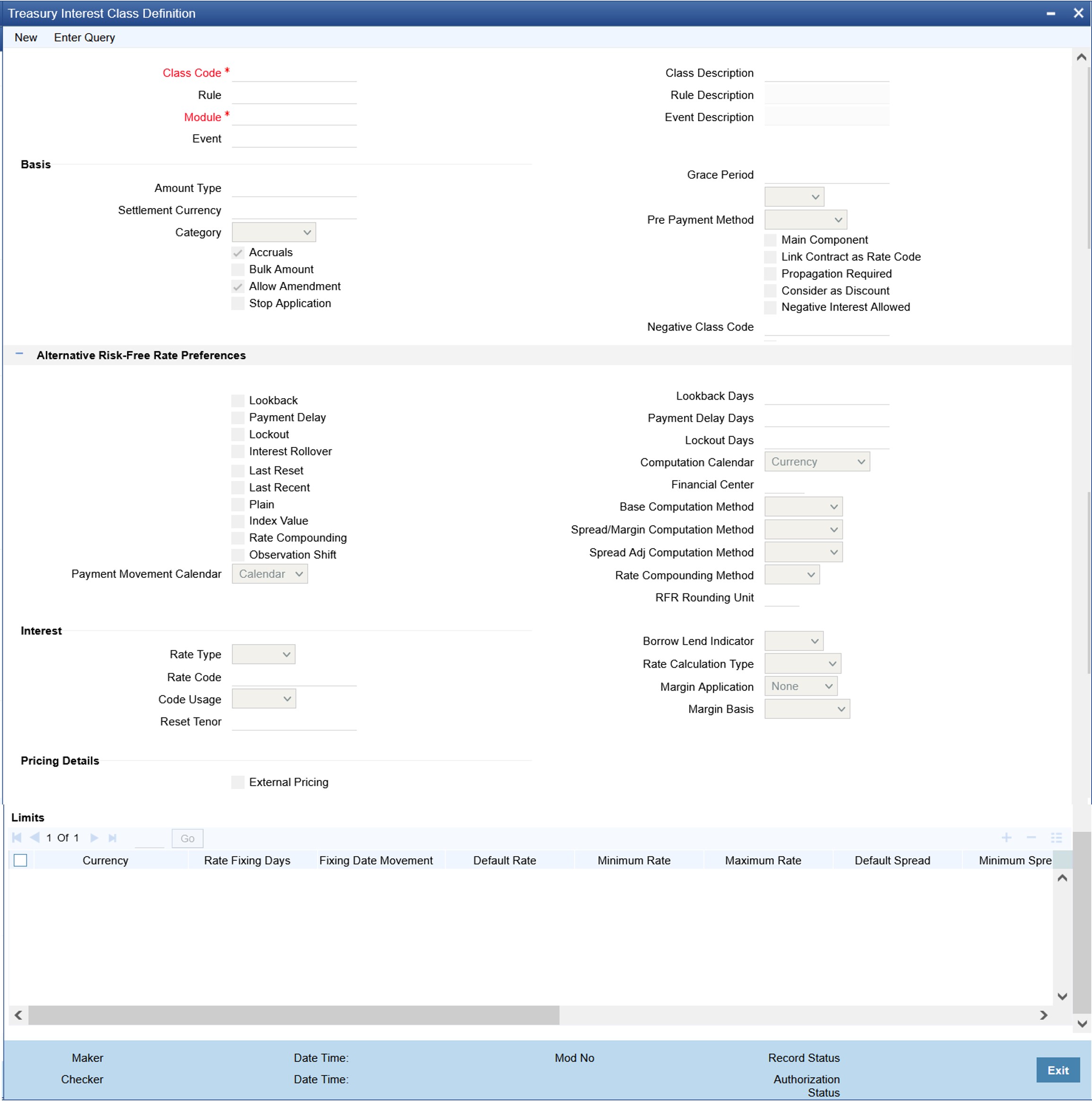

11.4 Treasury Interest Class Definition
This topic provides the instructions to capture the Treasury Interest Class Definition details.
Context:
Treasury Interest Class Definition supports RFR methods and computation preferences.
1.On the Homepage, type CFDTRINC in the text box, and click the next arrow.
Step Result:   Treasury Interest Class Definition screen is displayed.
Figure 11.3: Treasury Interest Class Definition
2.On the Treasury Interest Class Definition screen, specify the details as required.
For information on fields refer to: Table 11.2: Treasury Interest Class Definition - Field Description

Field
Description
Alternative Risk Free Rate
   Identifies if the interest class is enabled for RFR
Alternative Risk Free Rate Preferences
User can select any one of the below RFR calculation methods:
Lookback
   Payment delay
   Lockout
   Interest Rollover
Last reset
Last recent
Plain
The user can also select the combination of the below RFR methods:
Lookback and Lockout
Lookback and Payment Delay
Lockout and Payment Delay
Lookback, Lockout, and Payment Delay
Lookback
The user can select Lookback as RFR preference if the Rate Method is In-Arrears.
The observation period for the interest rate calculation starts and ends
a certain number of days prior to the Interest period. As a result, you
can choose the interest payment to be calculated prior to the end of
the interest period.
Lookback Days
This field will only be relevant if 'Rate Method' is 'In-Arrears' or bearing and RFR method is Lookback.
Lockout
The user can select Lockout as RFR preference if the Rate Method is In-Arrears.
Lockout means that the RFR is frozen for a certain number of days prior to the end of an interest period (lockout period).
During this time, the RFR of lockout period days is applied for the remaining days of the interest period. As a result, the averaged RFR can be calculated a couple of days before the end of the Interest period.
Lockout Days
This field will only be relevant if 'Rate Method' is 'In-Arrears' or bearing and RFR method is Lockout.
Payment Delay
The user can select Payment Delay as RFR preference if the Rate Method is In-Arrears.
In this method, Interest payments are delayed by a certain number of days and are thus due a few days after the end of an interest period.
Payment Delay Days
This field is relevant if 'Rate Method' is 'In-Arrears' or bearing and RFR method is Payment delay. Number of days by which the interest (or installment) payments are delayed by a certain number of days and are thus due a few days after the end of an interest period.
Interest Rollover
Check this box to indicate that interest rollover is allowed.
   Interest Rollover method can be used as a combined method along with one each of In-arrears & In-advance methods.
Payments are set in advance and any missed interest relative to in arrears is rolled over into the next payment period.
This option combines a first payment (installment payment) known at the beginning of the interest period with an adjustment payment known at the end. The adjustment payment can be made a few days later or at the end of the next accrual period.
Interest rollover with negative interest rate is allowed for In-arrear method.
Plain
This field is relevant if Rate Method is In-Arrears or bearing and RFR method is Plain. System uses averaged RFR over current interest period, paid on first day of next interest period.
Last Reset
   This field is relevant if 'Rate Method' is 'In-Advance' and 'Rate Convention' is Last reset. In this option, interest payments are determined on the basis of the averaged RFR of the previous period.
Last Recent
   This field is relevant if 'Rate Method' is 'In-Advance' and 'Rate Convention' is Last recent.
In this option, a single RFR or an averaged RFR for a short number of days, are applied for the entire interest period
Index Value
Select the Index Value check box to use the RFR index rate.
The RFR Index measures the cumulative impact of compounding RFR on a unit of investment over time. Index Value supports below RFR preferences.
1)Arrear Method
Lookback
Lockout
Payment Delay
Plain
2)Advance Method
Last Reset
Last Recent
For more information on the RFR Index Value, refer to the attached RFR Index Value calculation worksheet.
Observation Shift
Select the Observation Shift check box to apply observation Shift to RFR calculation.
The observation shift mechanism provides the rate to be calculated and weighted by reference to the Observation Period rather than the relevant interest period.
Observation Shift Currently supports below RFR Methods and combination.
Lookback
Lockout
Lookback and Lockout combination
For more information on the RFR Observation Shift, refer to the attached RFR Observation Shift calculation worksheet.
Payment Movement Calendar
Select the payment movement calendar from the drop-down list. The list displays the following values:
Calendar
Business
If the option Calendar is selected, then the system skips the Holiday Preferences selected at the contract level.
If the option Business is selected, it considers holiday treatment specified for schedule as per the Holiday Preferences selected at the contract level.
Computation Calendar
Select the Computation Calendar from the drop-down list, when RFR is selected for interest calculation. The available options are:
Currency
Financial Calendar
Financial Center
This field is mandatory if the Financial Center is selected as a computation calendar.
Select the code of the financial center from the displayed list of values.
Base Computation Method
The Base Computation Method is either simple or compounded.
Spread\ Margin Computation Method
   Spread\ Margin computation method can be maintained as either Simple or compounded.
Spread Adjustment Method
   Spread adjustment method is kept as either Simple or compounded.
Rate Compounding
This represents whether the rate compounding is applied for each calculation period. When enabled, system opts for rate compounding
instead of amount compounding, the amount difference comes into effect
only if any pre-payment is done.
For more information on RFR Rate Compounding, refer to the attached RFR Rate Compounding calculation worksheet.
RFR Rounding Unit
Specify the Rounding Units value to round daily index value to the nearest whole number and use it for interest calculation.
It is applicable only when RFR index value is used.
Rate Compounding Method
Select the Rate Compounding Method from the drop-down list. The available options are:
CCR
NCCR
This Rate Compounding method produces a rate for a period by applying the RFR compounding formula to the RFR rate and applying the compounded rate to the principal to calculate the interest due. Currently it’s applicable for MM & SR modules.
Rate Compounding supports two methods:
1. Cumulative Compounded Rate (CCR)
Calculates the compounded rate at the end of the interest period and it is applied to the whole period. It allows calculation of interest for the whole period using a single compounded rate.
2. Non-Cumulative Compounded Rate (NCCR)
 It is derived from Cumulative Compounded Rate i.e., Cumulative rate as of current day minus Cumulative rate as of prior Banking day. This generates a daily compounded rate which allows the calculation of a daily interest amount.
Rate Compounding supports below RFR preferences:
Arrear Method
Lookback
Lockout
Payment Movement
Plain

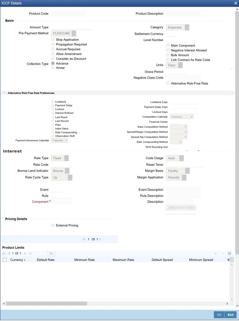

11.5 Money Market Product
This topic provides the instructions to capture the RFR details in money market product.
Context:
The Money market Product screen, Interest call form is enhanced to have similar new fields introduced in Treasury Interest Class Definition (CFDTRINC) screen.
Prerequisite:
Login to the homepage and navigate to the Money Market Product screen.
1.On the Money Market Product Screen, click Interest.
Step Result:   ICCF details screen is displayed.
Figure 11.4: ICCF details
2.On the ICCF details, specify the details as required.
During the creation and unlock after the authorization, user can change RFR preferences after defaulted from interest class.

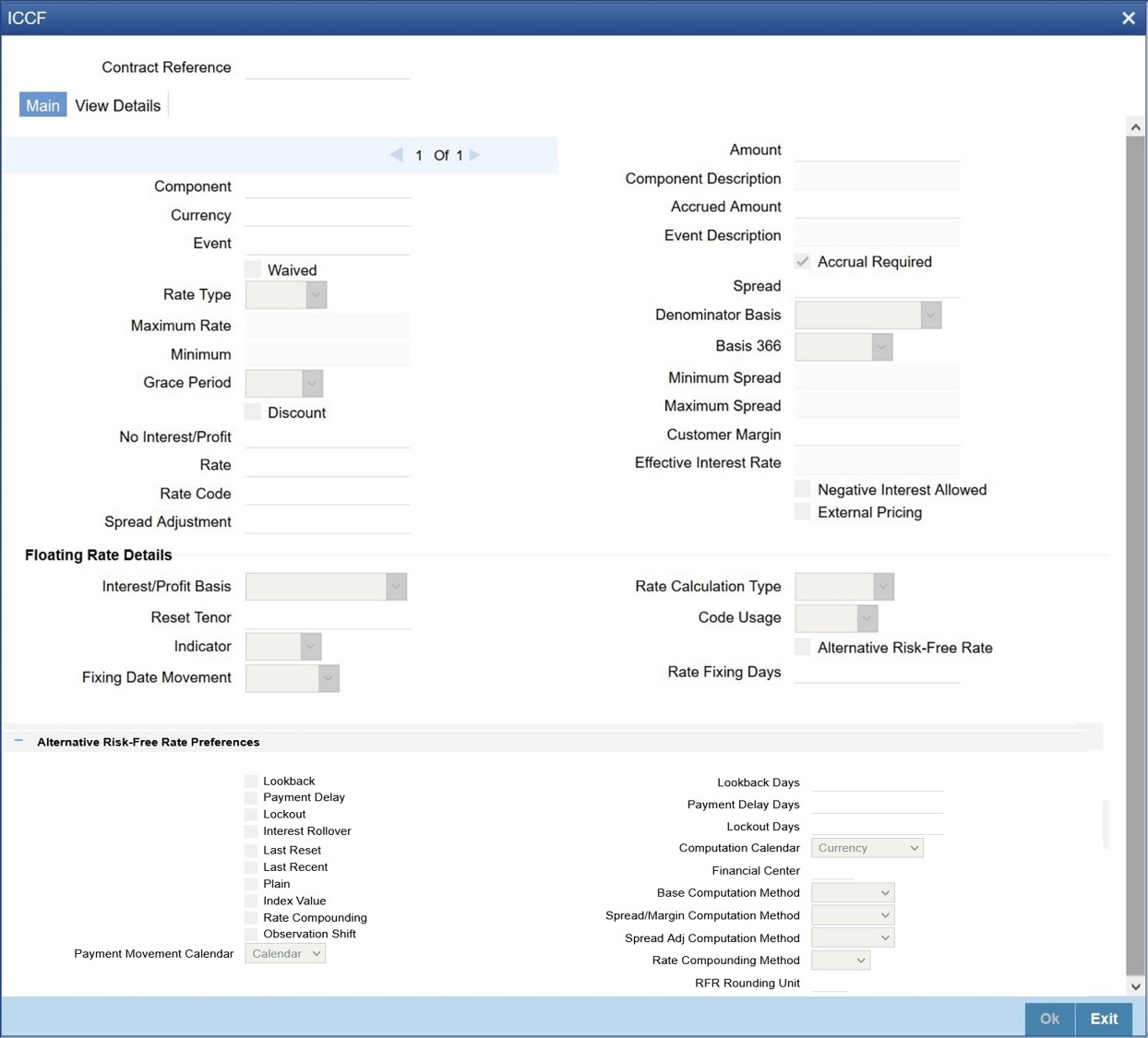

11.6 Money Market Contract
This topic provides the instructions to capture the RFR details in Money Market Contract.
Context:
The Money Market Contract screen, Interest call form is enhanced to have similar new fields introduced in Treasury Interest Class Definition (CFDTRINC) screen.
Prerequisite:
Login to the homepage and navigate to the Money Market Contract screen.
1.On the Money Market Contract Screen, click Interest.
Step Result:   ICCF screen is displayed.
Figure 11.5: ICCF
During the creation, user can change RFR preferences after defaulted from product level.
When RFR flag is checked, rate code has to be RFR code.
Spread Adjustment field is enabled and is used only for RFR component. Existing spread field is disabled and nullified for RFR component.
   System allows mapping of only one RFR interest class as main component for a contract.
Existing Rate Fixing Days field is used as lookback days only for RFR Advance methods.
Once contract is saved and authorized, the RFR preferences cannot be changed.
For information on Interest rate details in schedules explode, see the section
