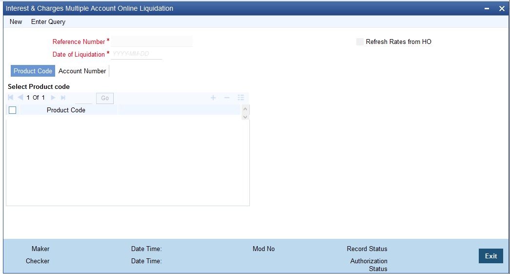

13.3.2 Product Code Tab
You can choose to liquidate interest for
l All products
l Selected products
Click on the buttons adjacent to each option to indicate that you would like to liquidate interest using the option.
Using these options in conjunction with the options in the ‘Accounts To Liquidate’ field, you can liquidate interest for
l All accounts linked to all products (that is, for the branch)
l All accounts linked to selected products
l Selected accounts linked to all products
l Selected accounts linked to selected products
l Selected account classes linked to all or specific products
Depending on your selection criteria (in conjunction with the ‘Accounts To Liquidate’ field), a list of products will be displayed.
For example, if you choose to liquidate interest for ‘selected accounts’ and ‘all products’, a list of all authorized products will be displayed. When you choose a product, all the authorized accounts linked to the product will be displayed. Interest for the accounts that you choose will be liquidated.

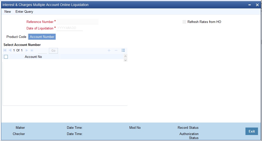

13.3.3 Account Number Tab
Click ‘Account Number tab in the Interest and Charges Multiple Account Online Liquidation screen to get below given screen:
l All accounts that are part of the interest system
l Selected accounts
Using these options in conjunction with the options in the ‘Products To Liquidate’ field, you can liquidate interest for
l All accounts linked to all products in your branch
l Selected accounts linked to any product
l Selected account classes linked to any or specific products
Depending on your selection criteria (in conjunction with the ‘Products to Liquidate’ field), a list of accounts will be displayed.
For example, if you choose to liquidate interest for ‘selected accounts’ and ‘selected products’, a list of all authorized products will be displayed. When you choose a product, a list of all the authorized accounts on which the product is applied will be displayed. Choose the accounts for which you want to liquidate interest.
To view the joint holder’s details of an account and the mode of operation maintained at the account level, place the cursor on the Account Number field and press Ctrl+J. The system displays the ‘Joint Holder’ screen.
For more information on the ‘Joint Holder’ screen refer to the section ‘Joint Holder Maintenance’ in this User Manual.
Note
If you choose to liquidate interest for ’All Accounts’ linked to ‘All Products’ the list of ac­counts for which interest is liquidated will not be displayed. Interest will be liquidated for accounts linked to any product in your branch.

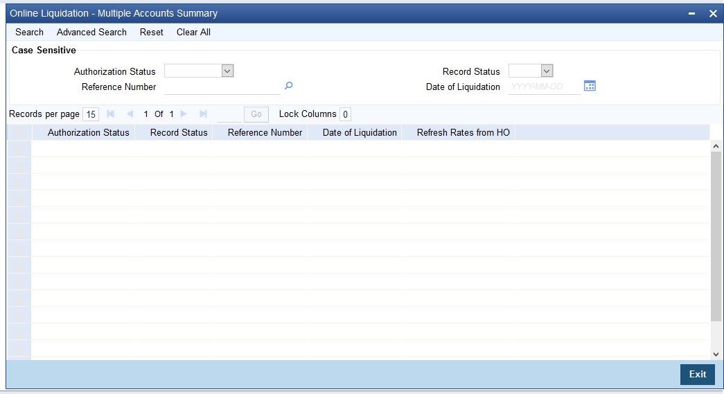

13.3.5 Viewing Interest and Charges Multiple Account
You can view the summary of interest and charges for multiple account in the ‘Online Liquidation – Single Accounts Summary’ screen. To invoke this screen, type ‘ICSOLIQ’ in the field at the top right corner of the Application tool bar and click on the adjoining arrow button.
You can query on records based on any one or all of the following criteria:
l Authorization Status
l Record Status
l Reference Number
l Date of Liquidation
Click ‘Search’ button. The system identifies all records satisfying the specified criteria and displays the following details for each one of them:
l Record Status
l Reference Number
l Refresh Rates from H.O

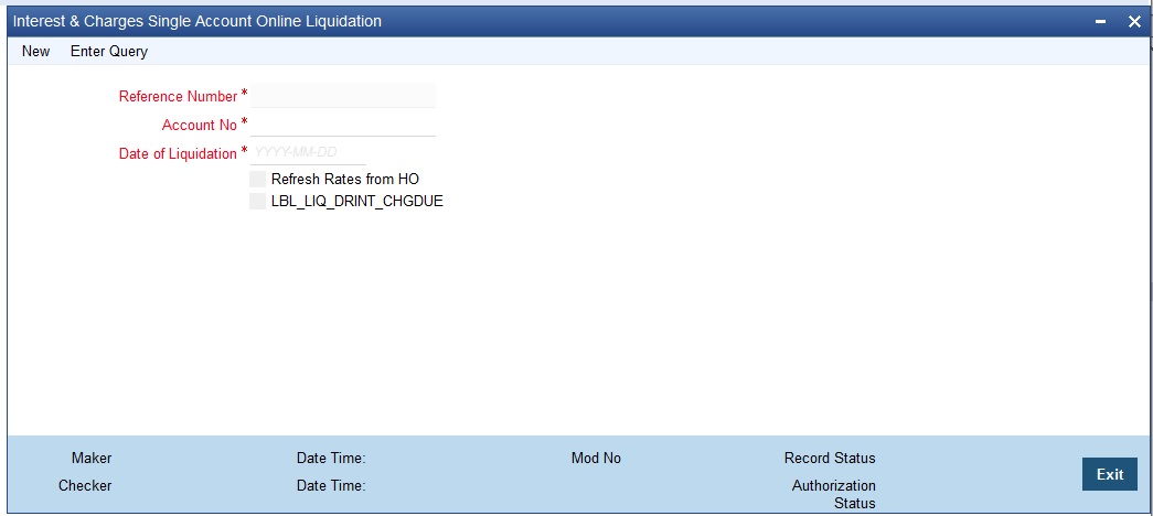

13.4.1 Invoking Interest and Charges Single Account Online Liquidation
You can process online liquidation for a single account using the ‘Interest & Charges Single Account Online Liquidation’ screen. You can invoke the ‘Interest & Charges Single Account Online Liquidation’ screen by typing ‘ICDLIQAC’ in the field at the top right corner of the Application tool bar and clicking the adjoining arrow button.
Note
You can query or modify the account details of the customers whose accounts are permit­ted to you for the query/modification in the ‘Group Code Restriction’ screen.
You can specify the following details here:
Reference Number
The system displays the reference number.
Account Number
If you have chosen to liquidate interest for specific accounts or products, choose the account or product from the list of values available.
To view the joint holder’s details of an account and the mode of operation maintained at the account level, place the cursor on the Account No field and press Ctrl+J. The system displays the ‘Joint Holder’ screen.
Date of Liquidation
Enter the date for which you want to liquidate interest. Interest for the accounts that you specify, will be liquidated from the last liquidation date up to the date that you enter here.
The system defaults to yesterday's date.
Refresh Rates from H.O.
You can indicate that you would like to apply the latest interest rates (maintained in the Head Office) on an account that you are liquidating by checking this box. If you do not check this box, the system will use the interest rates that were last propagated by the head office (to calculate interest for the account being liquidated).
Note
Interest will not be applied for the current month when you run the ad hoc liquidation func­tion if you specified that interest should not be applied for the ‘Account Closure Month’, when defining the rule. If you have specified that interest should be applied on ‘Account Opening Month’, interest will be computed for the first day of the month on which the ac­count was opened.
Remember that when you run the ad hoc liquidation function, inconsistencies in maintenance data, if there are any, will be reported by the IC Consistency Check. Rectify the inconsistencies before you run the ad hoc liquidation function.

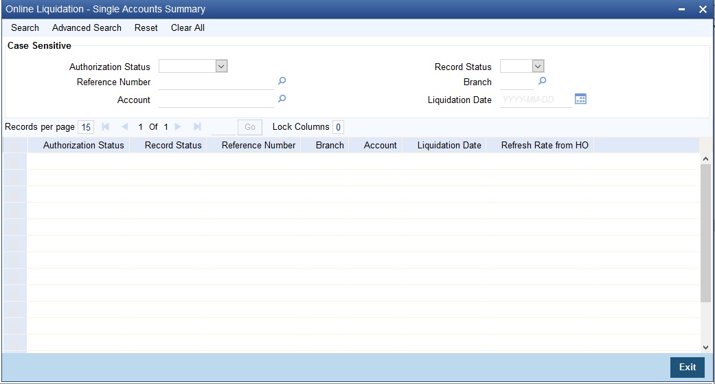

13.4.3 Viewing Interest and Charges Single Account
You can view the summary of interest and charges for single account in the ‘Online Liquidation – Single Accounts Summary’ screen. To invoke this screen, type ‘ICSLIQAC’ in the field at the top right corner of the Application tool bar and click on the adjoining arrow button.
l Record Status
l Reference Number
l Branch Code
l Account No
l Record Status
l Reference Number
l Branch Code
l Account No
l Refresh Rates From H.O

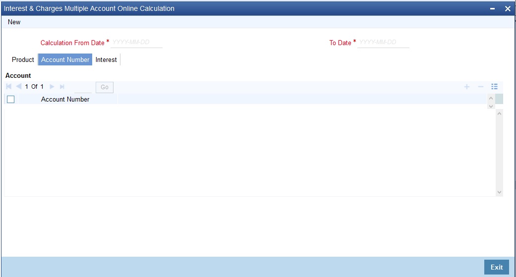

13.6 Online Calculation for Multiple Accounts
This section contains the following sub-topic:
l Section 13.6.1, "Processing Online Calculation for Multiple Accounts"

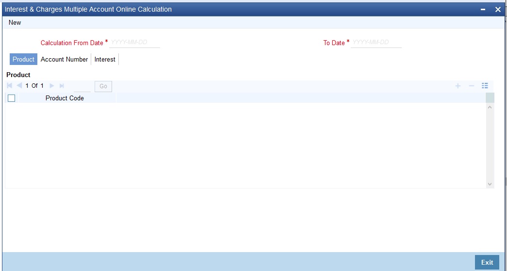

13.6.1 Processing Online Calculation for Multiple Accounts
Online Calculation for multiple accounts can be processed via the ‘Interest & Charges Multiple Account Online Calculation’ screen. You can invoke the ‘Interest & Charges Multiple Account Online Calculation’ screen by typing ‘ICDMCALC’ in the field at the top right corner of the Application tool bar and clicking the adjoining arrow button.
Note
Calculation From Date
You can get the interest applicable for an account over a period. Enter the ‘From Date’ for calculation.
To Date
You can get the interest applicable for an account over a period. Enter the ‘To Date’ for calculation.
Product Code
You can choose a product for which you want the interest applicable, in the following manner:
l All products
l Selected products
Click against the category you wish to choose. Account Number
Click on ‘Account Number’ tab in the ‘Interest & Charges Multiple Account Online Calculation’ screen to get below given screen
You can choose an account for which you want the interest applicable, in the following manner:
l All accounts
l Selected accounts
Intraday Sequence Number
This is like the reference number for each transaction using which the batch processing is done. This is getting generated in the back end using a sequence.
Submit Batch
The intraday Sequence Number is also being displayed in the screen for the user to submit the batch. When you click ‘Submit’ button a message conveys that the process has been submitted for batch processing.
Once the process is submitted, the batch processing happens independently in the back end without disturbing other activities in the front end.

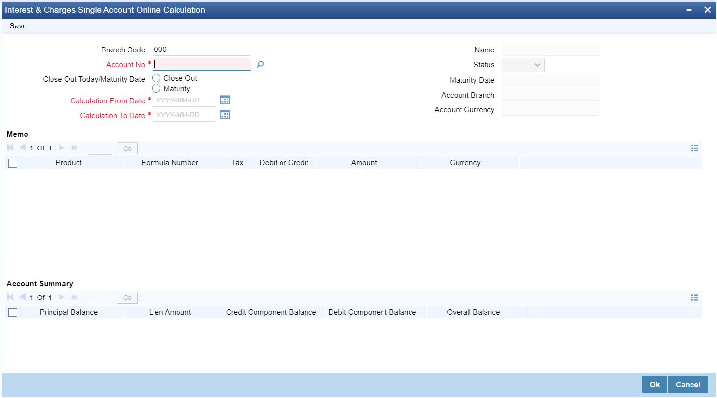

13.7 Online Calculation for Single Account
This section contains the following sub- topic:
l Section 13.7.1, "Processing Online Calculation for Single Account"
13.7.1 Processing Online Calculation for Single Account
Online calculation for a single account can be processed via the ‘Interest & Charges Single Account Online Calculation’ screen. You can invoke the ‘Interest & Charges Single Account Online Calculation’ screen by typing ‘ICDCALAC’ in the field at the top right corner of the Application tool bar and clicking the adjoining arrow button.

You can calculate interest for a specific account for a given date range.
Account Number
Specify the account number for which you need to calculate the interest. Choose the appropriate account number from the option list.
Close Out To date / Maturity Date
Choose the date type. The following options are available:
l Close Out
l Maturity
The system defaults the account start date when you select the account number from option list.
Calculation To Date
For TD accounts, if you have selected ‘Close Out’ as the date type, then ‘Calculate to Date’ will be defaulted to the current application date. If you have selected ‘Maturity’ as the date type, then ‘Calculate to Date’ will be defaulted to the maturity date of the TD account.
Name
The system displays the customer name.
Status
The system displays the status of the account. The possible values are given below:
l Open
l Closed
Maturity Date
The system displays the TD account maturity date.
Account Branch
The system displays the account branch.
Account Currency
The system displays the account currency.
The system displays the following details of the account:
l Product Code
l Formula Number
l Tax
l Dr/Cr
l Amount
l Currency
Account Summary
l Principal Balance
l Lien Amount
l Credit Component Balance
l Debit Component Balance
l Overall Balance
