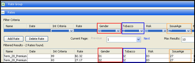

Steps to Filter Rates
Navigate to the Admin Explorer.
Open the Administration folder.
Open the Rate Groups folder.
Double-click on the folder of the rate group you want to work with.
Right-click on the XML file and select Check-out.
Scroll down to the Rates section of the screen.
Select a filter criteria from any column shown in the filter criteria section. For example, if you want to see all male and female non-smokers age 27 with a specific Tobacco class, you would set your filter as shown in the image below.
Close the Rate Editor when finished.
Rate File Open in Configuration Area
