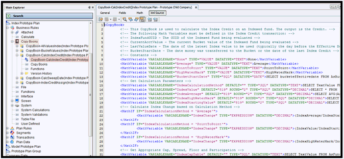

Step 10: Configure Reusable Configuration
Index funds products will reuse logic to calculate items such as the index credit or the actual sweep date. CopyBooks or Function rules can be used to configure this reusable logic. Transactions and other rules will call CopyBooks and Functions for these commonly used configurations.
The image below is taken from the Index Prototype Plan that is provided with the release. The prototype uses CopyBooks to calculate the credit for the index. Math variables are set up for the methods of crediting. Then a SQL is used to retrieve the actual index method set for the fund, which was set when the fund was created (from step 4). Other values are then queried to retrieve values from the rate tables that were created. The IF statements are used to figure out the index method and then run custom calculations.
Refer to the CopyBook prototoype examples for specific CopyBook configuration. Navigate to Main Explorer | Companies | Prototype | Subsidiary Companies | Prototype Individual Child Company | Products| Individual Prototype Product | Plans | Index Prototype Plan | Business Rules | CopyBooks.
CopyBook Used for Index Funds

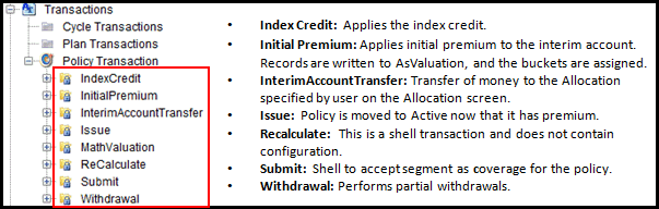

Step 11: Configure Transactions
Transactions must be configured to move the policy through its lifecycle. Some examples of events that are controlled by transactions are issuing the policy, applying money in and transferring money from the interim account into index funds on the Sweep Date.
For a complete example of the basic transactions required, review the transactions in the Index Prototype Plan, which demonstrate transactions that support the design of an Index product. A base segment is also needed to support the full product lifecycle. Navigate to Main Explorer | Companies | Prototype Company | Subsidiary Companies | Prototype Child Company | Plans | Index Prototype Plan | Transactions | Policy Transactions.
When working with the Withdrawal transaction, notice that as money is moved out according to a removal precedence and removal method that was established during fund creation. PureLIFO and ProRataLIFO are the methods that must be used with index funds.
- PureLIFO: last in/first out removal method for index funds. Applies across all indexed funds with the same removal precedence removing from the newest bucket first.
- ProRataLIFP: last in/first out removal method for index funds. Pro-rate across indexed funds first and then removes from the newest bucket first in each fund.
Bucket removal is based on the BucketEffectiveDate attribute of Assignment. This information is held in the AsBucket table.
Transactions in Index Prototype Plan in Rules Palette
