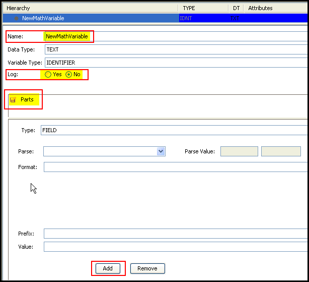

Define IDENTIFIER Math Variable and Parts
Drag and drop the IDENTIFIER math variable from the Palette window onto the configuration area of the Math Pane. Enter the math variable information such as the math variable name and Log value (Yes or No). The data type and variable type are preset. (Foradditionalinformation on adding math variables, see Math Pane.)
Click on the Parts node and begin to configure the individual components that will make up the unique identifier. An explanation of each type is given in the section below.Click the Add button after each individual part is added until all parts are complete.
Important: If the fields under the Parts node are not visible, drag the bottom scroll bar all the way to the right. Then, use the vertical scroll bar to scroll down to reveal the fields.
