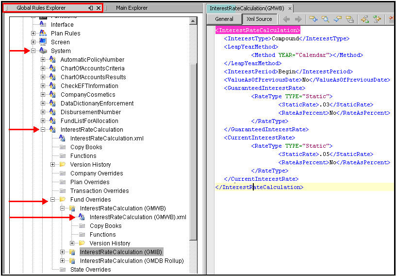

Steps to Configure Interest Rate Calculation
  1. Navigate to the Global Rules Explorer.
  2. Expand the Business Rule folder.
  3. Expand the System folder.
  4. Right-click on InterestRateCalculation.
  5. Select New InterestRateCalculation Override. The Override Wizard opens.
  6. Select the Next button for step one.
  7. Select the company, plan and fund where this override should be used.
  8. Select Finish.
  9. Configure your interest logic in the XML Source Pane of the override of the InterestRateCalculation that was created. View the V9 XML Configuration topic in this help system for additional information. View Business Rules | System Rules | InterestRateCalculation.
InterestRateCalculation Rule in Global Explorer
Interest Rate to be used with the Fund
In addition to configuring the logic for the interest rate calculation you must also ensure there is an interest rate for the fund to use. In the InterestRateCalculation rule you can enter it OR you can retrieve it from AsRate via the AsRateGroup name. If you decide to retrieve the rate from the rate tables, please see the Rates section for details on uploading rates via RateGroups in the Admin Explorer.

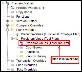

Steps to Configure Precision Values Rule Override
  4. Right-click PrecisionValues.
  5. Select New PrecisionValues override. The Override Wizard will open.
  6. Select Next for step one.
  7. Select the level you want the unit precision to apply to.
  8. Select Finish.
  9. Configure the unit precision value in the XML Source Pane of the override of the PrecisionValues rule that was created. View the V9 XML Configuration topic in this help system for additional information. View Business Rules | System Rules | PrecisionValues.
  10. Precision Values rule override
    PrecisionValue Rule Overridden atPlanLevel in Global Explorer
