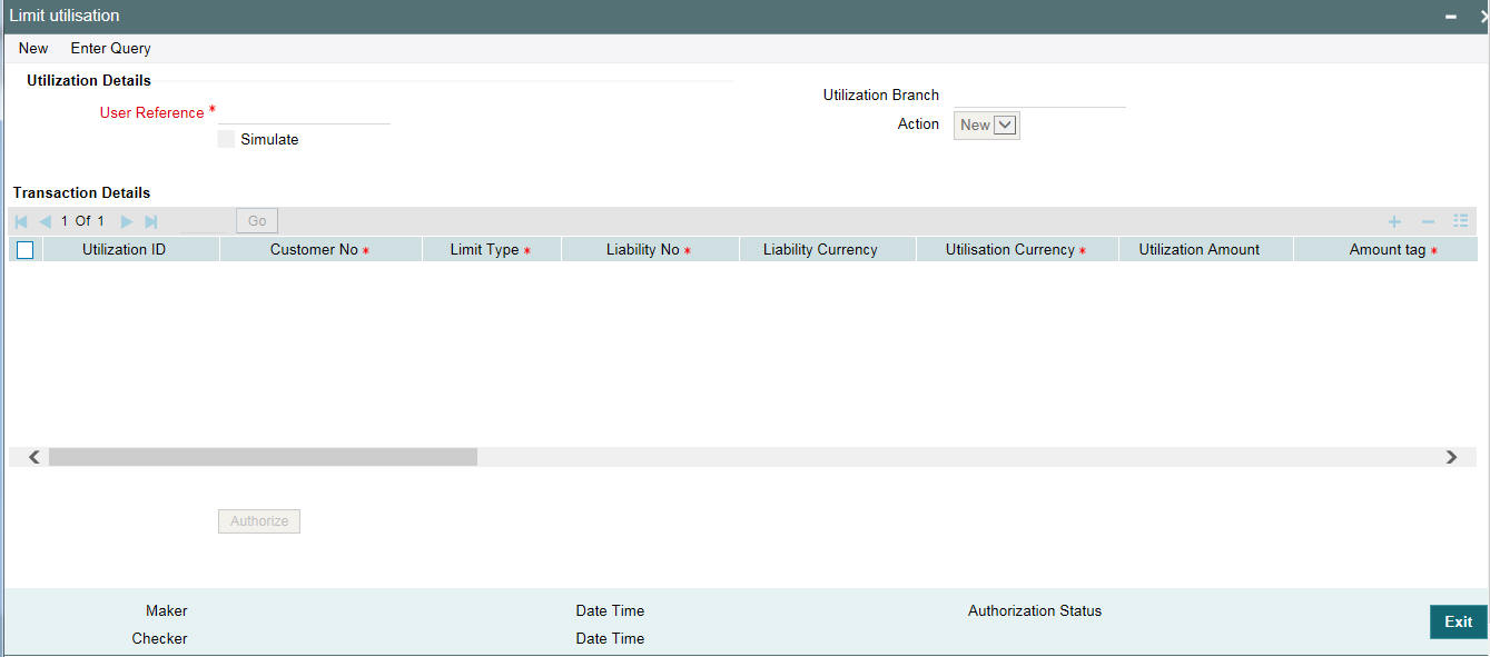

6.8 Utilization Transaction Screen
All utilization requests explained above can also be raised through the ‘Limit Utilization’ screen.
You can invoke the ‘Limit Utilization’ screen by typing ‘GEDUTILS’ in the field at the top right corner of the Application tool bar and clicking the adjoining arrow button.
Note
The limit utilization feature explained in this section is available only if the Enterprise Limits and Collateral Management module has been set up in standalone mode. This screen can be launched only if ELCM license is purchased.
Utilisation Branch
Specify the branch where the utilization request should be processed. The adjoining option list contains all the branches maintained in the system. Select the appropriate one.
User Reference Number
Specify a unique reference number for the transaction.
Transaction Module
Specify the module for the transaction. The adjoining option list contains all the modules in the system. Select the appropriate one.
Transaction Date
Specify the date for the transaction.
Simulate
Select this check box to indicate that the details for the transaction being entered should be used only for simulation and not stored permanently within the system. After a simulated transaction has been successfully put through, the system displays the utilized amount for the facility and the for the liability.
Customer Number
Specify a valid customer number for the transaction. The adjoining option list contains all the customers maintained in the system. Select the appropriate one.
Utilisation Amount
Specify the amount for the utilization transaction.
Utilisation Currency
Specify the currency for the amount entered. The adjoining option list contains all the currencies maintained in the system. Select the appropriate one.
Utilisation Product
Specify the product for the transaction. The adjoining option list contains all the relevant products. Select the appropriate one.
Uncollected Amount
Specify the amount that has not yet been collected from the customer.
Tenor Basis
Select this check box to indicate that the utilization should be tracked tenor wise for the facility. You can specify the basis on which it is to be tracked in the ‘Tenor’ field.
Tenor
Enter the basis on which tenor tracking should be done for the utilization. You need to have checked the ‘Tenor Basis’ option before you can specify the basis here.
Maturity Date
Specify the date on which the transaction matures.
Amount Tags
Specify the component type for the transaction. The adjoining option list contains all the relevant tags. Select the appropriate one. The 'Amount Tag' entered in 'Amount Tag Maintenance' screen is displayed here.
Remarks
Enter any additional remarks that you wish to maintain for this transaction. You can enter up to 255 characters.
Value Date
Specify the value date for the transaction.
Line Code
Specify the line code to be used for the transaction. The adjoining option list contains all the line codes allowed. Select the appropriate one.
Serial No
The ‘Serial No’ field is disabled and it gets defaulted from the ‘Facilities Maintenance’ screen.
Block Reference Number
If you enter the block reference number, you can utilize the limit amount, thereby reducing the block amount. The extent of the amount utilized is released from the block amount
If you try to utilize more than limit amount, the system gives an override.
An error appears, when you try to utilize more than blocked amount by providing block reference number.

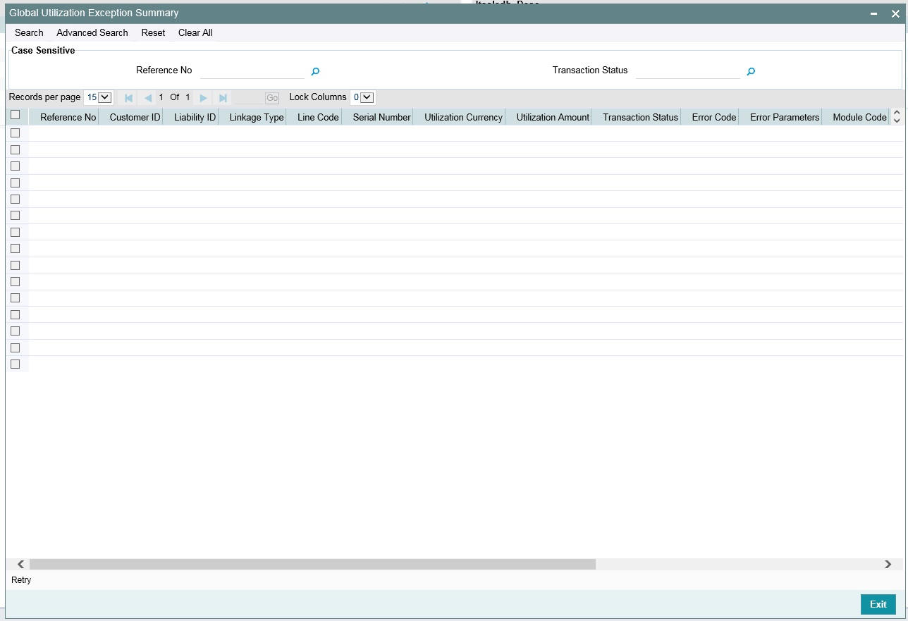

Viewing Mismatch Summary
You can view in the mismatch Summary screen all the counter transactions that has been performed by Oracle Banking ELCM for handling the mismatches. The summary also indicates whether the counter transactions have succeeded or failed.
For failed transactions, the reason for failure will be shown. You will have to take manual action in case of failed transactions.

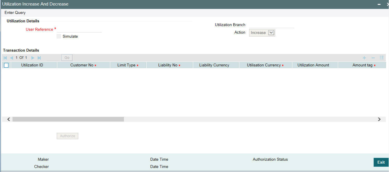

6.10 Increasing/Decreasing Utilizations
You can modify the utilization amount of the transaction through the ‘Utilization Increase And Decrease’ screen. This transaction can be used when customer is making payment for the loan or when the loan amount is modified.
You can invoke the ‘Utilization Increase and Decrease’ screen by typing ‘GEDUTNID’ in the field at the top right corner of the Application tool bar and clicking the adjoining arrow button.
Note
The feature explained in this section will be available only if the Enterprise Limits and Col- lateral Management module has been set up in standalone mode. This screen can be launched only if ELCM license is purchased.
Utilization Reference No
Specify the reference number for the utilization that you want to modify. The adjoining option list contains all the utilizations in the system. Select the appropriate one. The system displays the user reference number, the utilization currency and the amount tag.
Utilization Amount
Enter the amount by which you wish to modify the utilization.
Action
Indicate the operation for the utilization – whether you would like to increase or decrease the utilization amount.
The ‘Limit Utilization’ screen will be displayed when you click on the ‘Details’ button where you can view the details of the original utilization request.

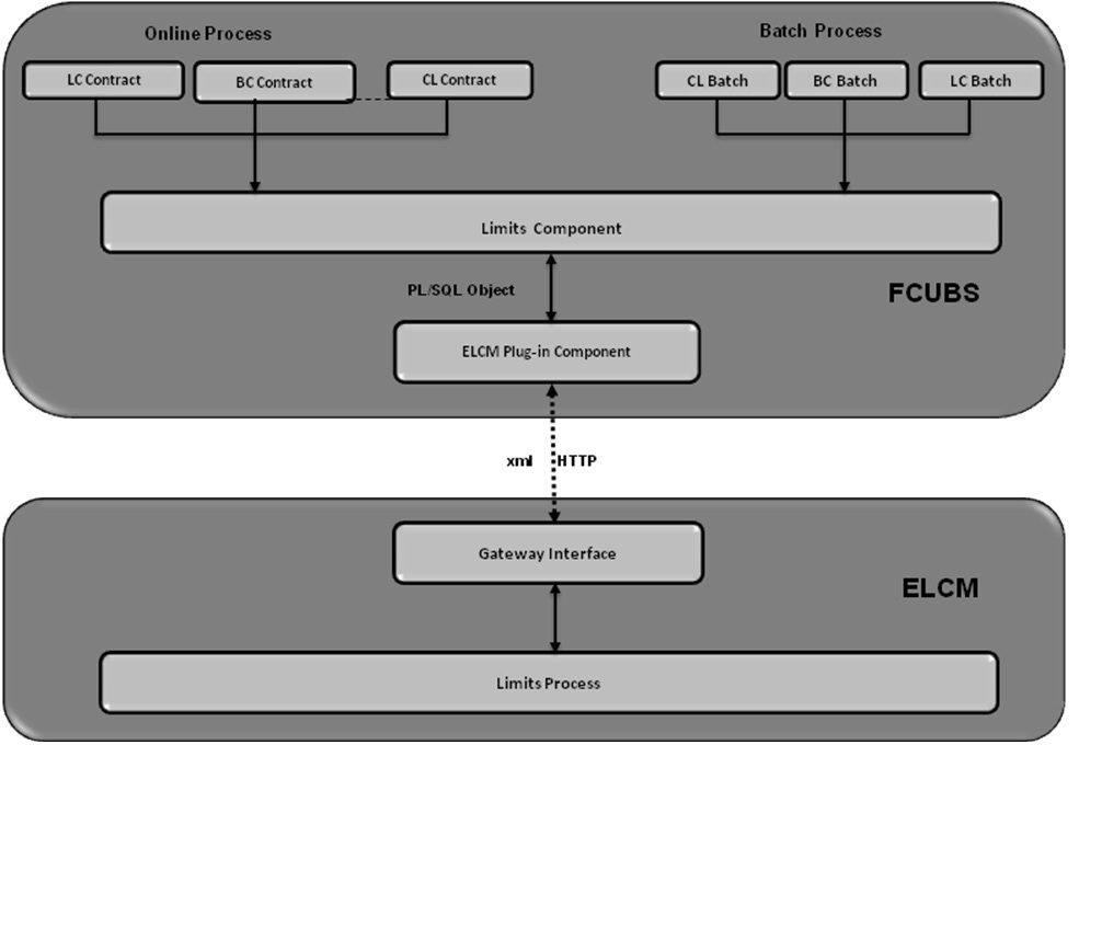

If you link an Oracle FLEXCUBE transaction to a facility, then based on the event of transaction corresponding, you need to process limits related data in Enterprise Limits and Collateral Management (ELCM) systems.
During processing if any error or override occurs in ELCM, then ELCM sends an error or override information to Oracle FLEXCUBE. Later Oracle FLEXCUBE displays the details to you. The Interface between Oracle FLEXCUBE and ELCM is online real time using HTTP and all transaction posted into ELCM is auto authorized. If delete or reversal action is triggered, the system will reverse the transaction in ELCM.
If a contact needs to be tracked under facility, then you have to link the contact to the facility and during transaction processing, Oracle FLXCUBE sends the utilization details to ELCM for processing.
The below diagram briefs the Utilization Transaction Integration Approach flow between Oracle FLEXCUBE and ELCM:
The table below explains the actions you can perform for which Oracle FLEXCUBE hands-off utilization transaction to ELCM:
Sl. No
Oracle FLEXCUBE Transaction Action
Utilization Transaction Action
1
New
New
2
Modify
Modify/ Increase/Decrease
3
Delete
Delete
4
Reverse
Reverse
5
Liquate
Liquate
6
Rollover
Rollover
7
Payment
Decrease
As part of the contract or transaction process, if a line code is linked to a contract then it is required to track the limits of the linked line. The system exposes limits process as subsystem and any module would interact with Limits subsystem.
The system allows you to trap all the utilization transaction. The system would interface with
ELCM Gateway HTTP to upload the utilization transactions in ELCM. Based on the utilization event, the system creates utilization request in ELCM format. It also logs transaction data and status of each utilization transaction.

6.12.2 Global Utilization Exception Summary
Global Utilization Exception Summary report is used for checking the response status (errors or overrides) of global utilization. In case of failure, you need to rectify manually.
You can invoke the ‘Global Utilization Exception Summary’ screen by typing ‘ELSGLOUT’ in the field at the top right corner of the Application tool bar and clicking the adjoining arrow button.

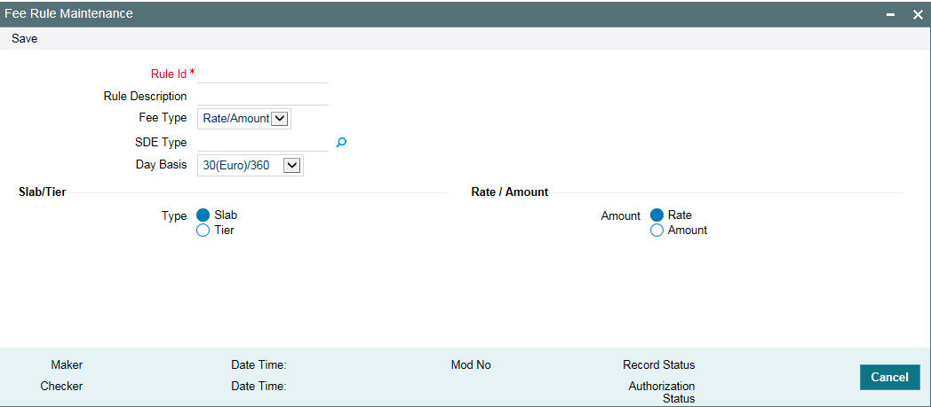

6.13.1 Maintaining Rule
You can invoke this screen by typing ‘GEDRULES’ in the field at the top right corner of the application tool bar and clicking the adjoining arrow button.
Rule ID
Every fee rule is identified by a unique code, called a Rule ID. You can link a valid fee Rule ID to the fee classes. Fees for a limit/collateral with which you associate a fee class is calculated on the basis of the Rule that is associated with the class.
Rule Description
For every rule that you define, you can enter a description. Specifying a description helps identify a rule.
Fee Type
This component value defaults to the ‘Fee Rule Preferences’ defined in the ‘Facilities/Collateral Maintenance’ screen. Rate/Amount are calculated based on the ‘Basis Amount’ where as ‘User Input’ is standard amount entered in the ‘Fee Rule Preferences’.
SDE Type
Specify the System Data Elements (SDE). The adjoining option list displays a list of SDEs maintained in the system. Applicable SDEs based on entity type selected will be available for selection.
Day Basis
A day basis method is used for fee calculations.
Different values for the numerator basis are as explained below:
Different values for the denominator of the fee basis are as explained below.
Fee Component Type
Select the fee component type either as ‘Slab’ or ‘Tier’.
Fee Type
Select the fee type either as ‘Rate’ or ‘Amount’.
Entity Type
Select the entity type either as ‘Facility’ or ‘Collateral’. By default, ‘Facility’ is selected. If you select 'Entity Type' as ‘Facility’ and select Rule Type as ‘Event Based Fee’, the system displays an error message.
Rule Type
Select the rule type either as ‘Fee’ or ‘Event Based Fee’.
If ‘Rule Type’ is selected as ‘Event Based Fee', then the following SDEs should be selected for 'Event Based Fee'.
External Pricing Required
Select this check box if the pricing (Rate/Amount) for a particular fee (SDE) needs to be fetched from external pricing and billing system.

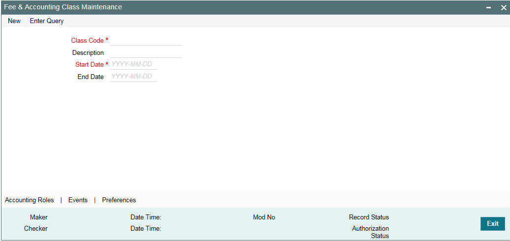

6.13.2 Maintaining Fee Class
You can invoke this screen by typing ‘GEDCLSMT’ in the field at the top right corner of the application tool bar and clicking the adjoining arrow button.
Class Code
Before defining the attributes of a fee class, you should assign the class a unique identifier, called the Class Code.
Description
A brief description about the class. A description helps you to easily identify the class.
Start Date
Specify the start date from which the fee calculation starts. The start date can only be a current date or the future and it cannot be a back dated date.
End Date
Specify the end date till which the fees will be calculated.
Entity Type
You can select the ‘Entity Type’ as ‘Facility’ or ‘Collateral’. Based on this selection, appropriate ‘Rule Code’ and ‘Rule Type’ is displayed in the ‘Preferences’ tab.

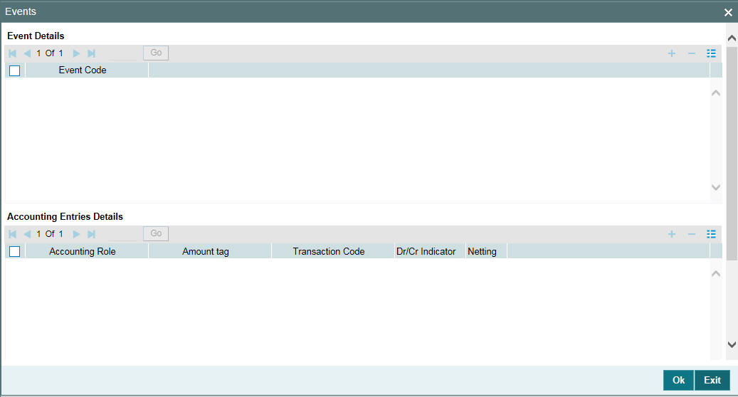

6.13.2.2 Events tab
You can specify event and accounting entries details in ‘Events’ screen. Click ‘Events’ tab to open this screen.
Event code
Specify the event code.
Accounting Role
Accounting Roles are tags that identify the type of accounting entry that is posted to an accounting head.
Amount Tag
Specify the amount tag.
Transaction Code
Indicates the type of accounting entry associated with every accounting entry.
Dr/Cr Indicator
Indicates whether the amount was debited or credited to the ‘Net’ Account
Netting
Select this drop-down list if you need netting for fee liquidation.

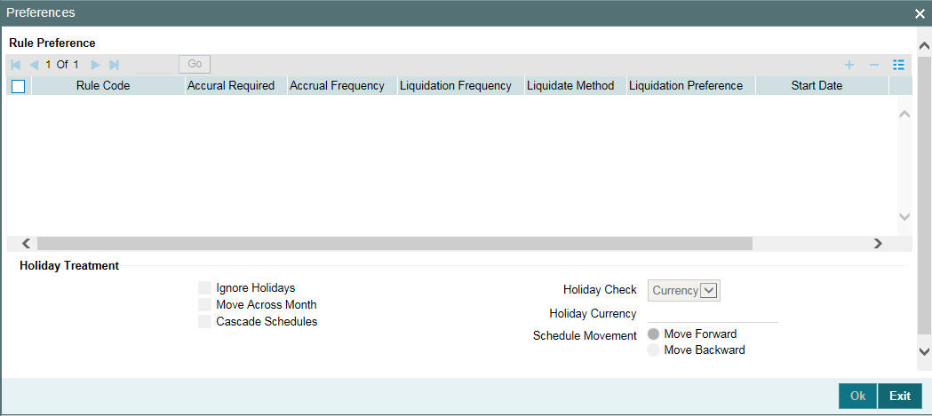

6.13.2.3 Preferences tab
Click ‘Preferences’ tab to open ‘Preferences’ screen.
Rule Code
You can link a valid fee Rule to the fee classes. Fees for a limit/collateral with which you associate a fee class is calculated on the basis of the Rule ID that is associated with the class.
Rule Type
Based on the rule code, the rule type gets defaulted.
Basis Amount
The following are the list of basis amount applicable for a collateral based on which the fees is calculated.
For collateral fees of type ‘Event Based Fee’, basis amounts ‘Collateral Value’ are applicable on which the fees is calculated. ‘Limit Contribution’ and ‘Available Amount’ are not applicable.
Accrual Required
Selecting this indicates that the fees have to be accrued.
Accrual Frequency
Specify the fee accrual frequency.
For limit/collateral fees, the 'Rule Type' of ’Fee’ can have any 'Accrual Frequency'. Ensure that accrual frequency is less than liquidation frequency.
Note
If a collateral fees of rule type ‘Fee’ is configured with 'Liquidation Frequency' as ‘One-Time’, then the 'Accrual Frequency' must be ‘One-Time’, if the value does not match the system displays appropriate error message.
Liquidate Frequency
Specify the fee liquidation frequency.
For collateral fees, the 'Rule Type' of ’Fee’ can have any 'Liquidation Frequency'.
Liquidation Method
The following are the liquidation method
Arrears
For collateral fees, the 'Rule Type' of ’Fee’ is collected/liquidated in 'Arrears' (For 'Fee Type' both 'Rate/Amount' and 'User Input').
Facility fee is collected at the end of liquidation cycle is marked as ‘Arrears’.
Advance
Liquidation method ‘Advance’ is not applicable for collateral fees. The system validates and throw an exception if ‘Entity Type’ is selected as ‘Collateral’ and for any of the fee rule 'Liquidation Method' is selected as ‘Advance’.
Facility fee is collected at the start of liquidation cycle is marked as ‘Advance’.
Event Based Fee
Applicable only for collateral.
Liquidation Preference
For collateral fees, the 'Rule Type' of ’Fee’ you can select 'Liquidation Preference' as 'Auto' or 'Manual'.
The 'Manual' fee liquidation is applicable only if in the 'Fee Rule Maintenance' screen, the 'Fee Type' is selected as 'User Input'. Liquidation preference manual is only applicable for facility fees.
This value is defaulted based on the rule selected in 'Fee Rule Maintenance' and you cannot modify this value.
Start Date
Specify the start date from which the fee need to be liquidated.
Start Month
Specify the start month from which the fee need to be liquidated.
Entity Type
Specify the entity type either ‘Facility’ or ‘Collateral’.
Waived
If this check box is selected, then the system does not calculate the fees.
Holiday Treatment
Ignore Holidays
If this check box is selected, then holiday treatment is not applied to calculate the next date. If this check box is not selected, then ‘Holiday Preferences’ settings are validated.
Move Across Month
If this check box is selected, then the system moves the date to next month. If this check box is unselected, then the system moves the date to next date.
Example
Working Day
30-Aug
1-Sep
Holiday
31-Aug
Schedule Movement
Move Forward
Calculated Next Date
31-Aug
In above mentioned example, if ‘Move Across Month’ is selected, then the system moves next date to 1-Sep. If ‘Move Across Month’ is not selected, then the system changes next date to 30-Aug.
Schedule Movement
Move Forward
In case calculated next date is holiday then date should be moved forward. In this case fee liquidation moves to 1st Sep which is next working date
Move Backward
In case calculated next date is holiday then date should be moved backward. In this case, fee liquidation moves to 30th Aug which is previous working date
Cascade Schedules
If cascade schedules is selected, then the next date is calculated on based on previous schedule date instead of start date.
If fee liquidation date for one of the liquidation cycle is changed based on holiday processing setting and if cascade schedule is selected future liquidation dates of corresponding fee gets modified as per the newly arrived liquidation date.
Holiday Check
If holiday treatment is applicable, then you can select ‘Local, ‘Currency’ or ‘Both’ based on your holiday maintenance.
If 'Both' is selected and 'Branch' or 'Currency' is holiday, then holiday processing setting is considered.
Holiday Currency
If holiday check is maintained as ‘Currency’ or ‘Both’ then currency code to be maintained here.
