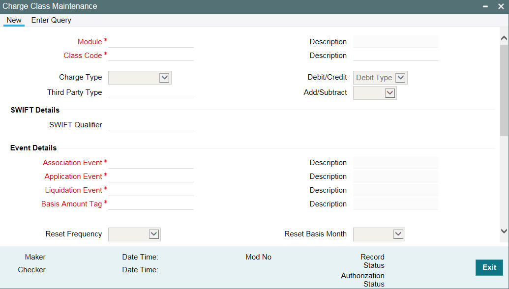

A class is a specific type of component that you can build with certain attributes. You can build a charge class, for instance, with the attributes of a specific type of charge, such as ‘Charges for amending the terms of a loan’, or ‘Charges for provision of services’.
When building a charge class, you define certain attributes such as:
You can define the attributes of a charge class in the ‘Charge Class Maintenance’ screen, You can invoke the ‘Charge Class Maintenance’ screen by typing ‘LFDCHGCE’ in the field at the top right corner of the Application tool bar and clicking the adjoining arrow button.
Before defining the attributes of a charge class, you should assign the class a unique identifier, called the Class Code and briefly describe the class. A description would help you easily identify the class.
Module
A charge class is built for use in a specific module. As a charge component would be applied on different basis amounts, in different modules.
Note
The Basis Amount Tags available would depend on the module for which you build the class.

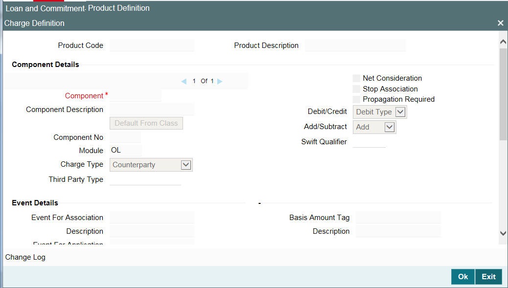

You can specify the charge components applicable to a product, in the Charge Definition sub- screen of ‘Loans and Commitment Product Definition’ (OLDPRMNT) screen. Click ‘Charges’ from ‘Loans and Commitment Product Definition’ screen to invoke the ‘Charge Definition’ sub-screen.
You should necessarily use a charge class to indicate the charge components applicable to a product. A charge class is a specific type of component that you can build with certain attributes.
To associate a charge class with a product, select the appropriate charge class from the list of classes defined specifically for the particular module of Oracle Lending. Click ‘Default From Class’ from the ‘Charge Definition’ screen.
The attributes defined for the charge class are displayed. You have the option to change the attributes defined for the charge class to suit the requirement of the product you are creating.
You can associate several charge classes with a product. To add to the list of classes associated with the product click the ‘Add row’ button. Thereafter, click ‘Default From Class’ and select a class from the option list that is displayed.
To navigate between the charge classes associated with a product, you can use the icons provided for the same.
To disassociate a class from the product, navigate to the class, and click the ‘Delete row’ button.
You can choose to waive a charge component for a product that you are defining by clicking on this option. The charge component displayed in the Component field is not associated with the portfolios maintained under the product that you are defining.

Consider as Discount
While associating a charge class for either a loans or bills contract, you can indicate whether the charge component is to be considered for discount accrual on a constant yield basis.
If you select this option the charge received against the component is used in the computation of the constant yield and subsequently amortized over the tenor of the associated contract.
Accrual Required
This field is defaulted from the Charge Class Maintenance screen. You cannot change it in this screen.
During the charge liquidation if this option is selected, the system uploads the charge as Upfront Fee Component. The FELR event is activated and FACR happens based on the frequency maintained at the product level.
Any subsequent liquidation of the charges of the same component is treated as amendments to the existing uploaded fee component.
You are not allowed to perform any manual operation on the uploaded fee component.
Note
If both the options ‘Consider as Discount’ and ‘Accrual Required’ are selected, the charge amount is considered for Internal Rate of Return calculation. But it is not part of the total discount to be accrued amount.
