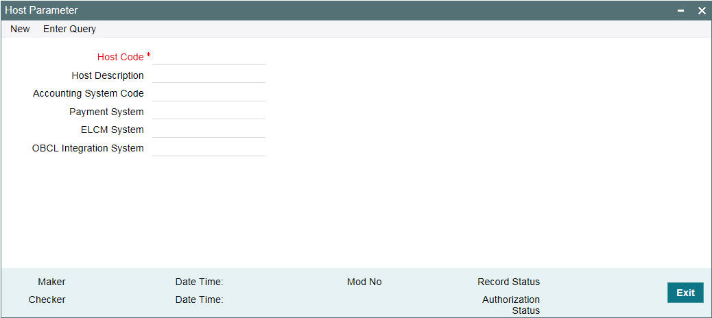

2.1.1  Configuring Accounting System for Host Code
You can configure the accounting system using host code in the ‘Host
Parameter’ screen.
To invoke this screen, type ‘PIDHSTMT’ in the field at the top right corner
of the application toolbar and click the adjoining arrow button.
Specify the following
details
Host Code
Specify the host code.
Host Description
Specify the brief description for the host.
Accounting System Code
Specify the accounting system code.
Payment System
Specify the payment system.
ELCM System
Specify the ELCM system.
OBCL Integration System
Specify the external system. For example, OLINTSYS

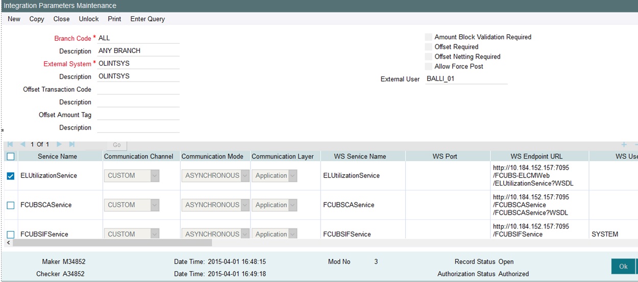

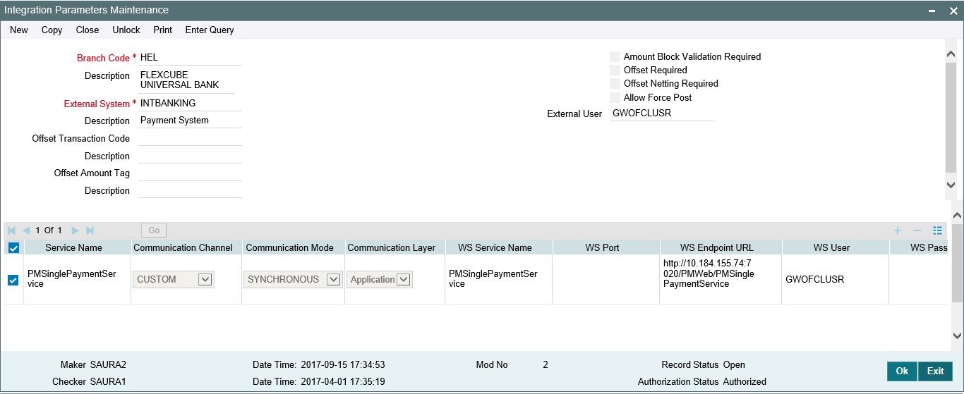

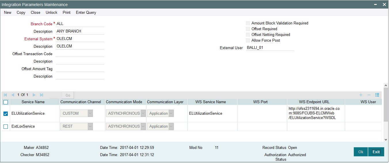

2.1.2  Maintaining Integration Parameters
You have to maintain integration parameters for ‘External LOV’
and ‘ELCM/Payment/OL Utilization’. This maintenance must
be done for all branches. This maintenance is done through ‘Integration
Parameters Maintenance’ screen.
To invoke this screen, type ‘IFDINPRM’ in the field at the top right corner
Example of Integration Parameter Maintenance screen for Payments
Example
of Integration Parameter Maintenance screen for ELCM
Parameter Maintenance screen for OBCL
You can specify
the following fields in this screen:
Branch Code
Select the branch code for which the parameters are to be maintained
from the adjoining option list.
Description
A brief description of the branch code is displayed.
External System
Select the external system for which the parameters are to be maintained,
Description
A brief description of the external system is displayed.
Offset Transaction Code
Select a transaction code for the offset entry from the adjoining
option list. The adjoining option list displays all valid transaction
codes available in the system. You can select the appropriate one
Offset Amount Tag
Select an amount tag for the offset entry from the adjoining option
list. The adjoining option list displays all valid amount tag available
Amount Block Validation
Select this check box to validate the amount block. If the amount
block reference number is sent with the transaction details then the
accounting will be invoked after the release of amount block.
Offset Required
Select this check box if an offset entry is required. If this check
box is selected, then ISB GL will be resolved based on branch, currency,
function id and external system. If the check box is not selected, then
it is expected that external system sends the balanced entry
Offset Netting Required
Select this check box if offset netting entry is required. If this
check box is selected, then the consolidated entries will be built. Offset
amount tag is picked from the maintenances. If this check box is not
selected, then individual entries are built.
Allow Force Post
Select this check box to suppress all the overrides after posting
transactions.
You need to maintain the integration parameters for the following:
- External Lov – ExtLovService
- ELCM Utilization/Payments/OBCL – ELUtilizationService/PMSinglePaymentService/FCUBSCAService
External Lov
- External System - External system name is specified here. For example,
OLELCM, INTBANKING for Payments, and OLINTSYS for OBCL.
- Service Name – The service name for which the maintenance is
done. For example, ELUtilizationService for ELCM, ExtLovService for External
LovExtLovService, and PMSinglePaymentService for Payments, and FCUBSCAService
for OBCL.
- Communication Channel – The communication channel like REST,
CUSTOM, WEB SERVICE, and so on are specified here.
- Communication Mode – The communication mode can be SYNC/ASYNC.
Note
Rest Service need not be maintained for OBCL.
- Rest Service IP – You have to maintain the IP address. For
example, ELCM IP, Payment IP.
- Rest Service Port – You have to maintain port details. For
example, ELCM Port, Payment Port.
- Rest Service Pattern - You have to maintain rest service pattern.
For example, LovService
- Rest Service Context – You have to maintain rest service context.
For example, FCJNeoWeb
- External User - ELCM/Payment/OBCL user should have access to all
branches and autoauth
ELCM Utilization/Payment/OBCL
OLELCM.
LovExtLovService and PMSinglePaymentService for Payments.
- WS Service Name – The service name needs to be maintained here.
For example, ELUtilizationService, PMSinglePaymentService, and FCUBSCAService.
- WS Endpoint URL – The WSDL of the services are maintained here.
For example, ELCM utilization/Payment/CA service WSDL link
- WS User – ELCM/Payment user should have access to all branches
and autoauth.
branches and autoauth.

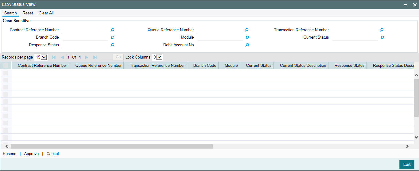

ECA Queue Summary screen contains details on the transactions between
OL/LS and external system.
To invoke this screen, type PISECAQU’ in the field at the top right corner
You can search records
based on the following parameters:
- Transaction Reference No
- Network code
- ECA Amount
- Customer No
- Requested Date
- Authorization Status
- Cross Border Contract Reference Number
- Activation Date
- File Reference Number
- Payment Transaction Type
- ECA Currency
- Current Status
- Response Date
- Maker Id
- Payment Type
- Customer Service Model
- Queue Reference No
- Transaction Branch
- Module
- Response Status
- ECA System Code
- Checker Id
- Source Code
Click  ‘Search’ button with or without entering any of
the above search parameters. All records matching the search criteria
are displayed. To view a particular record double-click on the desired
record displayed in the list of records. The details pertaining to each
record is displayed.

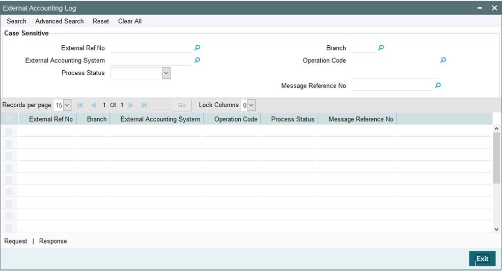

2.3.2  Viewing External Accounting Log
'External Accounting Log' screen contains OL/LS transaction details
with External Accounting System linkage.
To invoke this screen, type ‘OLSEACLG’ in the field at the top right corner
In this screen, you can view the request sent from OL and LS module
and view the response (received for the request sent) from the External
Accounting System.
- External Reference Number
- Branch
- External Accounting System
- Operation Code
- Process Status
- Message Reference Number

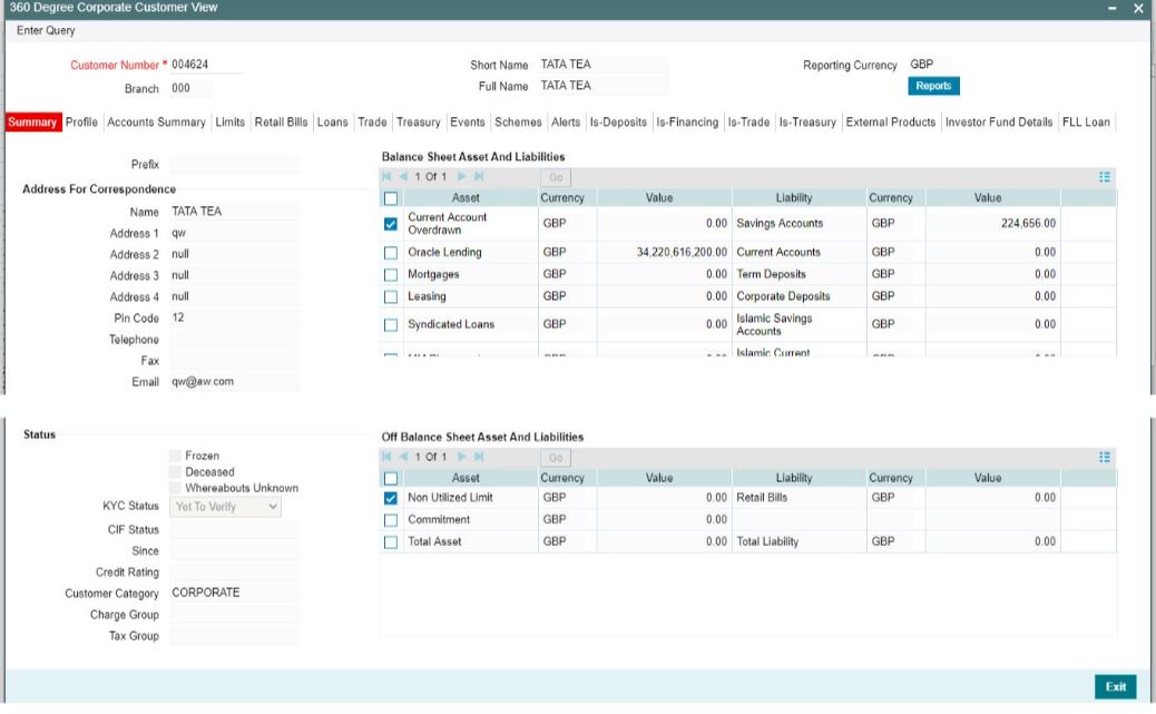

2.4  Integration with FCUBS for 360
Degree Customer View
Using 360 Degree Customer View, you can query customer limits, account
statements, view settlement balances contracts, view assets and liability
balances, view loans, commitments and syndication contract details of
the customer. You can also view summary of loans, commitments and syndication
contract details of the customer. The 360 degree customer view facilitates
easy and total view of the customer details and reduces customer service
complexities.
FCUBS pulls the required data from OBCL by using the below operation
code.
- Service Name : FCUBSOLService
- New Operation : QueryCorpCustview

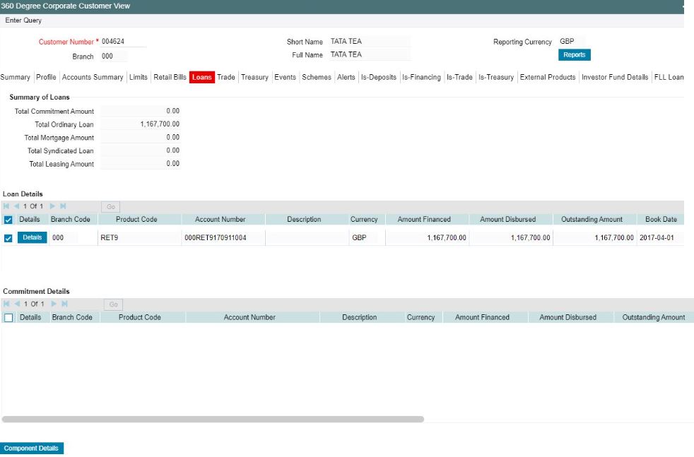

2.4.1  Summary Tab
The ‘Summary’ tab displays the OBCL loan contracts of
the selected customers along with the details.
2.4.2  Loans Tab
In an FCUBS – OBCL integrated environment, click ‘Loans’
tab in ‘360 degree customer view’ screen to view the details
for OBCL contracts in Loan details/Commitment and Syndicate Loan Details
block for the selected customer.
The loans
details are classified as follows:
- Commitment Details
- Loan Details
- Mortgage
- Leasing
- Syndicate Loans details
Under each of the loan details, the system displays the following:
- Branch Code
- Account Number
- Description
- Currency
- Amount Financed
- Amount Disbursed
- Outstanding Amount
- Book Date
- Value date
- Maturity Date
- Product Code
- Account Status
- User Defined Status

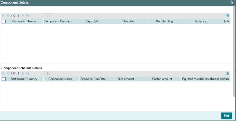

2.4.3  Component Details Button
You can view details about the components linked to an account in
the ‘Component Details’ screen. You can invoke this screen
by clicking the ‘Component Details’ button in the ‘360
Degree Retail Customer View’ screen.
You
can view the following component details:
- Component Name
- Component Currency
- Expected – the system displays the amount which is not due
for the present date. This amount is arrived during querying.
-  Overdue – – the system displays the amount which is
not overdue for the present date. This amount is arrived during querying
- Outstanding – the system displays the amount which is due for
- Advance – the system displays the amount pre paid for a component
as on the present date. This amount is arrived during querying.
- Latest Interest rate – the system display the current interest
rate only for main interest component.
-  Number of Days Overdue.
Here you can view the following:
- Component Name
- Schedule Due Date
- Due amount
- Settled Amount
- EMI Amount
- Accrued Amount

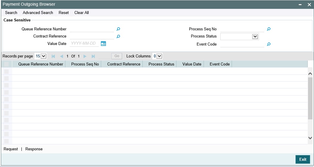

2.5.2.2  Viewing Payment Integration Request/Response Messages
You can view Oracle Lending and Loan Syndication contracts with payment
integration in ‘Payment Outgoing Browser’ screen.
To invoke this screen, type ‘OLSPMTBR’ in the field at the top right corner
In this screen, you can view the request sent from Oracle Lending/Loan
Syndication module and view the response (received for the request sent)
from the Payments module.
- Queue Reference Number
- Sequence Number
- Contract Reference
- Process Status
- Value Date
- Event Code
Note
To search outgoing payment details, for LB side use
DD Contract Reference Number and for LP side use Contract Reference Number

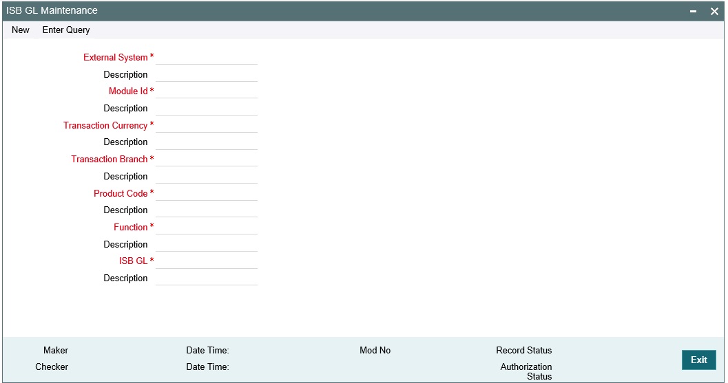

2.5.2.3  Maintaining ISB GL
You can invoke the ‘ISB GL Maintenance’ screen by typing
‘OLDISBGL’ in the field at the top right corner
of the application tool bar and by clicking the adjoining arrow button.
You can specify the
following field information in this screen. A brief description of each
value updated in the fields appearing in this screen, is displayed by
the system.
External System
Select the external system from the adjoining option list.
Module ID
Select a valid module code from the adjoining option list.
Transaction Currency
Select a valid currency code from the adjoining option list.
Transaction Branch
Select a valid transaction branch code from the adjoining option list
Product Code
Select a valid product code from the adjoining option list.
Function ID
Select a valid function ID from the adjoining option list.
ISB GL
Select a leaf General Ledger from the adjoining option list.

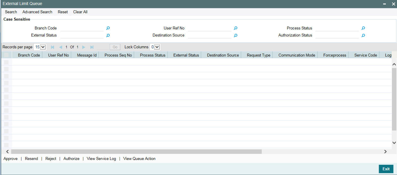

2.6.3.1  Viewing External Limit Summary
Details
External Limit Summary screen contains details of the Oracle Lending
and Loan Syndication transactions with ELCM linkage.
You can approve, resend, reject, and authorize the Oracle Lending
and Loan Syndication transactions using this screen.
To invoke this screen, type  OLSEXLMT’ in the field at the top right corner
- Branch Code
- User Reference Number
- Message ID
- Process Sequence Number
- Process Status
- External Status
- Destination Source
- Request Type
- Forceprocess
- Service Code
- Logtime
- Maker ID
- Maker Date Stamp
- Checker ID
- Checker Date Stamp

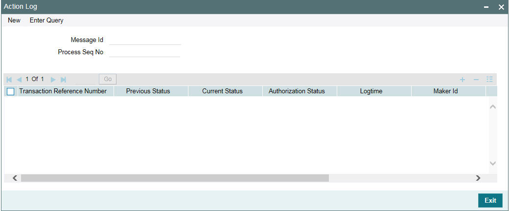

2.6.3.2  Viewing Action Log of External
Limit Queue
The action log screen displays the details of actions performed in
the External Limit Queue screen.
To invoke this screen, type ‘OLDQAHIS’ in the field at the top right corner
This screen displays
the action log of the following fields along with ‘Message Id’
and ‘Process Sequence Number’.
- Transaction Reference Number
- Previous Status
- Current Status
- Logtime
- Maker ID
- Maker Date Stamp
- Checker ID

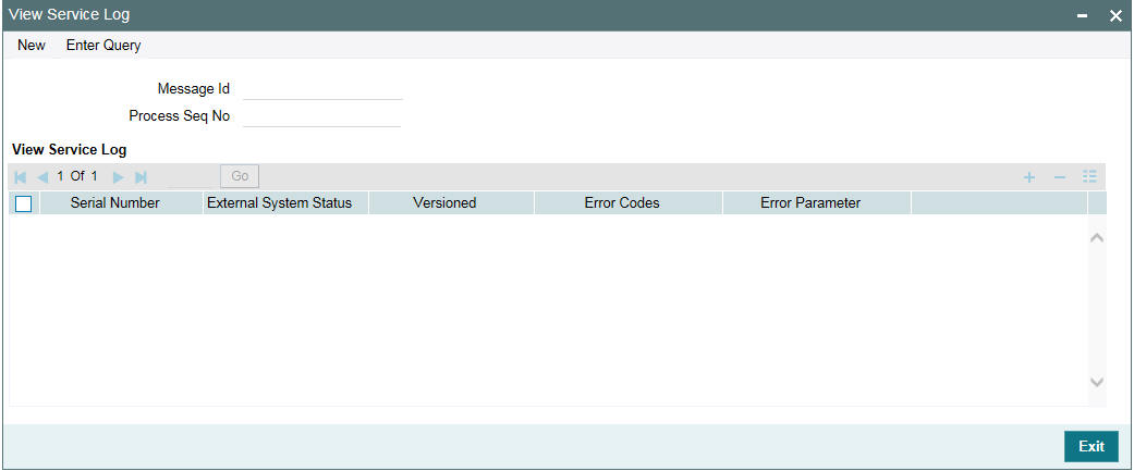

2.6.4  Viewing Service Log Details
You can view service log using ‘View Service Log’ screen.
To invoke this screen, type ‘OLDSRLOG’ in the field at the top right corner

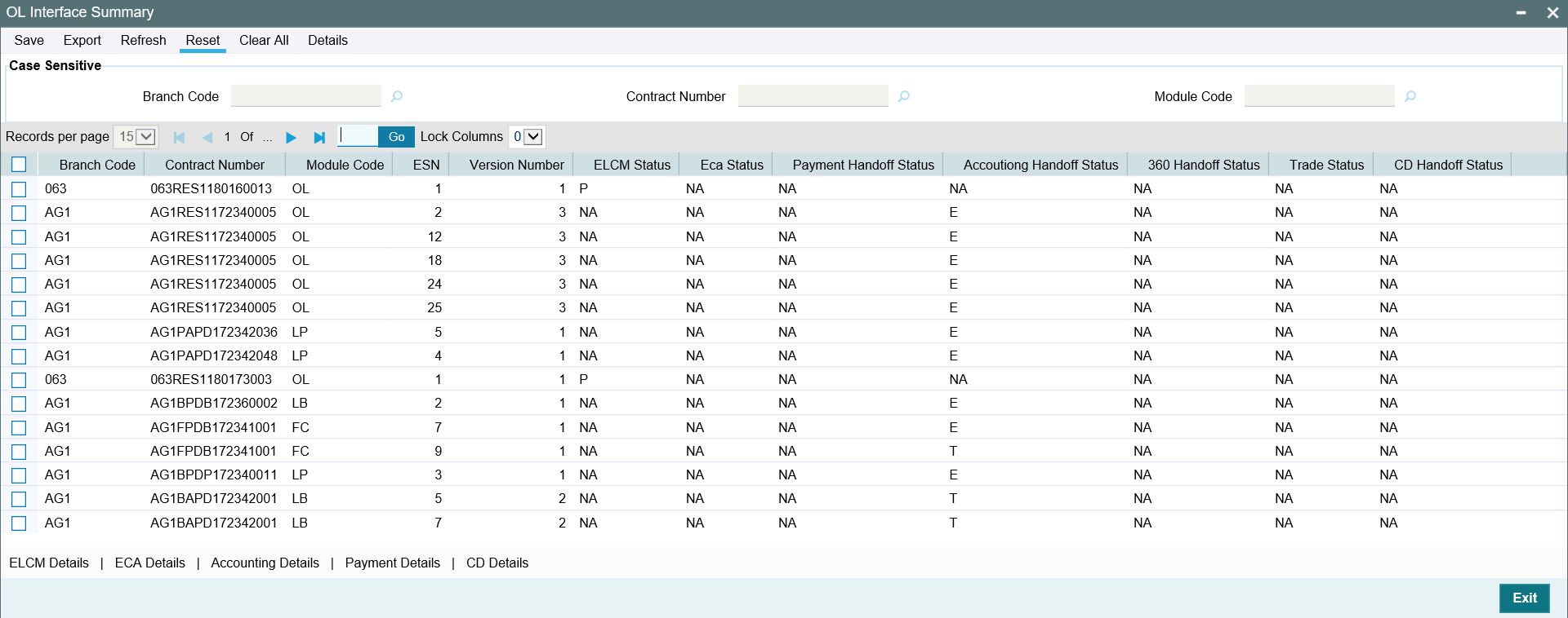

2.7  Common Integration Details Summary
screen
You can view the contract integration status of various modules (OL,
LB, LP, FC, TL) of OBCL and also connect to integration screen of different
product processors.
You can invoke the ‘OL Interface Summary’ screen by typing
‘OLSCNSTS’ in the field at the top right corner
of the Application tool bar and clicking the adjoining arrow button.
To view the details,
query using any of the following fields.
- Branch Code
- Contract Number
- Module Code.
You can select the specific contracts and then click their respective
product processor sub-system.
- ELCM Details - External Limit Queue (OLSEXLMT)
- ECA Details - ECA Status View (PISECAQU)
- Accounting Details - External Accounting Entries Browser (OLSEACBR)
- Payment Details - Payment Outgoing Browser (OLSPMTBR)
- CD Details - Transaction Log (OLSIFCD)
After going to the integration screen, you can re-process and verify
the logs of various contracts.
For more information on CD Details - Transaction Log (OLSIFCD), refer
to FCUBS Corporate Deposit -OBCL Integration User Guide.

Customer Status
- This integration is to verify the frozen, deceased and where about
unknown status for the counterparty and Borrower CIF of a contract.
- The synchronous call request is inserted into OLTB_REQ_MASTER with
process status as ‘U’.
- New stage table contains the tag value required to build the request
for each contract
- The system validates the counterparty and borrower based on few parameters
(frozen/deceased/where about unknown/invalid customer) and an appropriate
error message appears.
Inactive Customer Status
If a customer does not have any single contract active, then an update is sent to FCUBS using
"QueryCustSts" service. "QueryCustSts" service is consumed by OBCL to handoff the
customer status (Active/Inactive) to FCUBS system.
