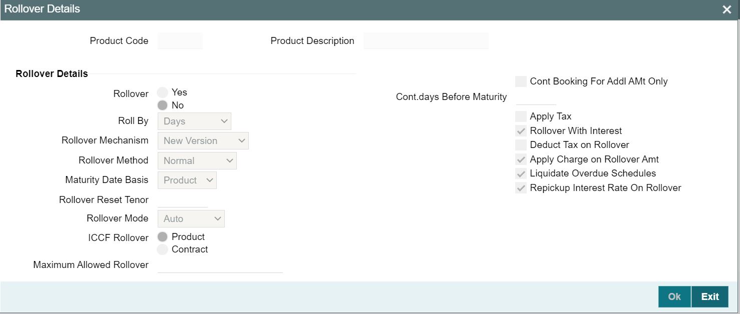

The rollover details for the product that you are defining can be specified in the Product Roll-over details screen. Click ‘Rollover Details’ button in the Product Preferences screen to invoke this screen.
The following are the features of the product roll-over details screen.

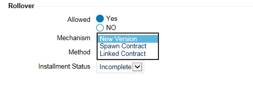

Select the option ‘Yes’ in the section ‘Rollover’ to indicate contracts booked under this product can be rolled over. Select the option ‘No’ to indicate contracts under this product cannot be rolled over. You can, for a contract, change this preference. This can be done while entering a contract in the OL Contract Online screen.
You can indicate whether rolling over a loan contract using the product must create a new version of the original contract, a spawn contract, or a linked contract.
Note
Note
RFR (Risk Free Rate) is supported for New Version Rollover, Spawn Normal Rollover, and Spawn Split Rollover.
If you have indicated the rollover mechanism applicable for contracts using the product in the Rollover Mechanism field as ‘New Contract’ (as in the case of borrower draw down products), then you can use this field to indicate whether a single new contract must be created for the rolled over amount.

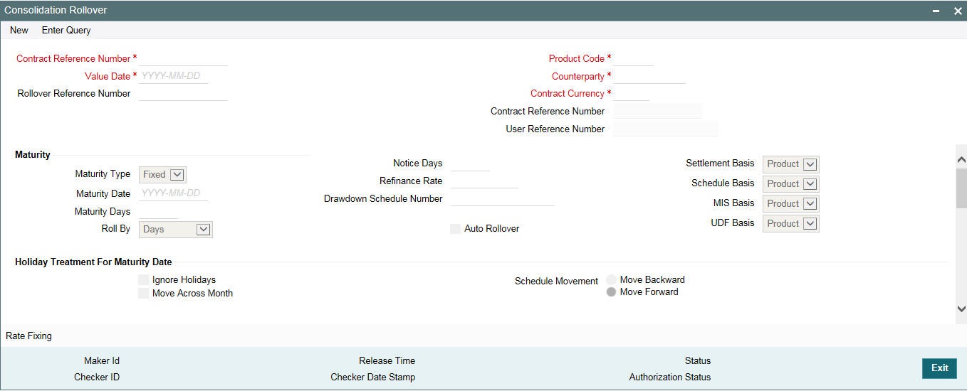

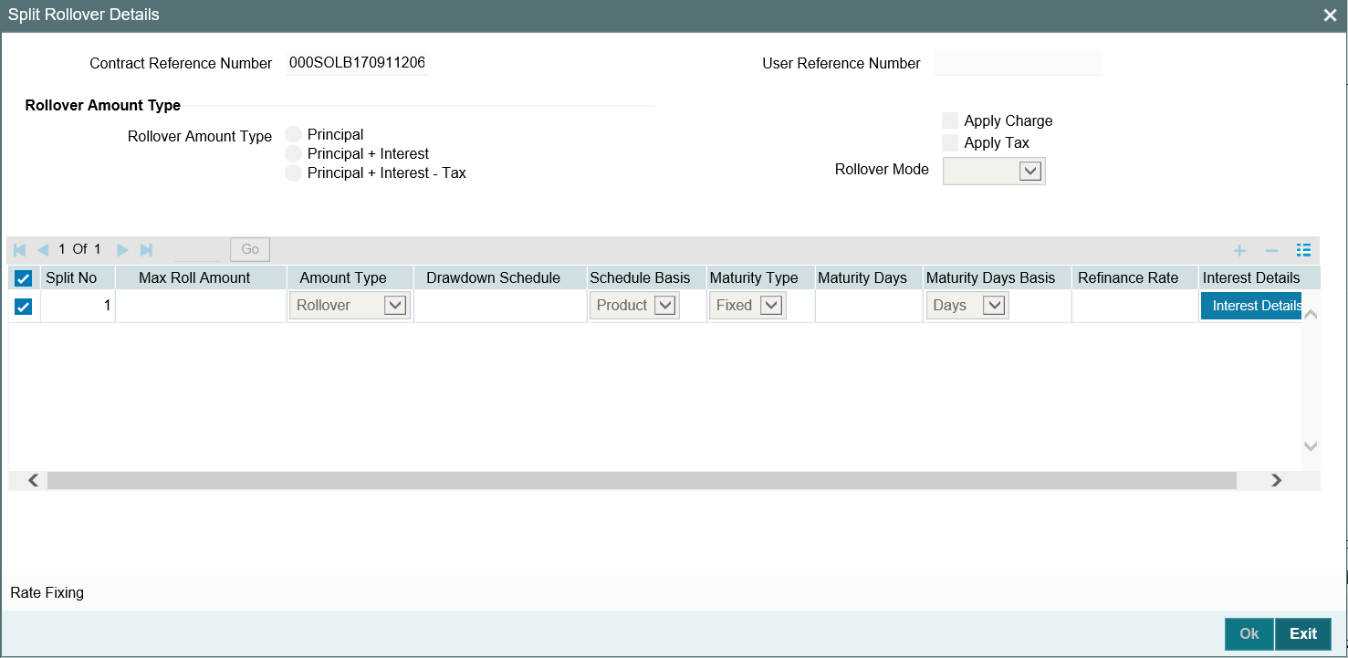

Whether the original contract must be split into multiple contracts, or consolidated with other contracts into a single new contract, when rolled over using the rollover operation. Accordingly, select any of the options, ‘Normal’, ‘Split’, or ‘Consolidated’, in this field, as applicable.
If you indicate the ‘Split’ option, you can specify the preferences for the split, when you enter the borrower draw down contract using the product.
If you indicate the ‘Consolidate’ option, you can specify the other draw down contracts with which the original contract must be consolidated into a single contract, when you enter the borrower draw down using the product.

Select the Maturity Date basis for a rolled over contract. Select the option ‘Product’ if you want the tenor of the rolled over contract to be the default tenor maintained for the product. Select the option ‘Contract’ if you want the tenor of the rolled over contract to be the one currently applicable for the contract.
For tax to be applicable on a rolled-over loan:
You have to indicate whether tax has to be applied, on the rolled-over loan also.
You have to specify whether the loan that you are rolling-over, should be rolled-over along with the outstanding interest. If you so specify, the principal of the new loan, is the sum of the outstanding principal and the outstanding interest on the old loan. This applies only to loans with a bearing (add-on) method of interest liquidation.
If all the outstanding interest has been paid, then the loan can be renewed without the interest. If not, it is rolled-over with the interest that is still outstanding on it.
A loan is rolled-over with only the main interest that is outstanding. It is that interest component, which you specify as the main interest in the ICCF Product Details screen (this will be displayed in the Contract Main screen). Other interest components and the penalty interest, if there are any, are not rolled-over.
The following example illustrates how this concept works.
Example
Consider the example of Ms Yvonne Cousteau, who has taken a loan of USD 10,000 under the Short Term Loans for Individuals scheme,
If you roll it over without interest, the new principal is USD 10,000. The accrued interest on this loan is liquidated. The loan is rolled-over, only if the interest can be liquidated. If there are no funds in the repayment account, there can be no rollover.
If you roll the old loan over (renew it), along with the unpaid interest, the principal of this renewed loan is USD 1, 1167 (USD 10,000 + USD 1,167) as of 31 December 1997. The interest on the new loan is applied on a principal of USD 11,167.
When a loan is initiated, tax is applied on the principal of the loan. When this loan is rolled-over or renewed, you have two choices (depending on the tax laws of your Country):
This option applies only to tax on principal and not to tax on interest.
This field assumes importance, when:
If this tax is not waived for the old loan, it is applied on the new loan. If it is waived on the old loan it is not applied on the renewed loan.
Choose Deduct Tax on Rollover, if tax on the old loan has to be liquidated before it is rolled-over.
Select the ‘Cont. Booking For Addl Amt Only’ check box to indicate contingent entries for the additional rollover amount must be passed when the child rollover contract is booked, for contracts using the product. If you select this check box, contingent entries for the additional rollover amount are passed. If you do not select this option, contingent entries are passed for the total principal amount of the child rollover contract.
Select the ‘Apply Charge on Rollover Amt’ check box to indicate a charge is applied on the amount being rolled over.
Select the ‘Liquidate Overdue Schedules’ check box to indicate schedules for the original deal that are overdue on the day of rollover should be liquidated before the deal is rolled over. If you have selected this check box but the overdue schedules cannot be automatically liquidated, the deal is not rolled over and it is reported as an exception condition in the Daily Exception Report.
Select the ‘Repickup Interest Rate on Rollover’ check box to indicate the interest for the rolled over contract should be picked up again on rollover of the contract. If you do not select this box, the interest for the rolled over contract is the latest interest applicable for the contract.

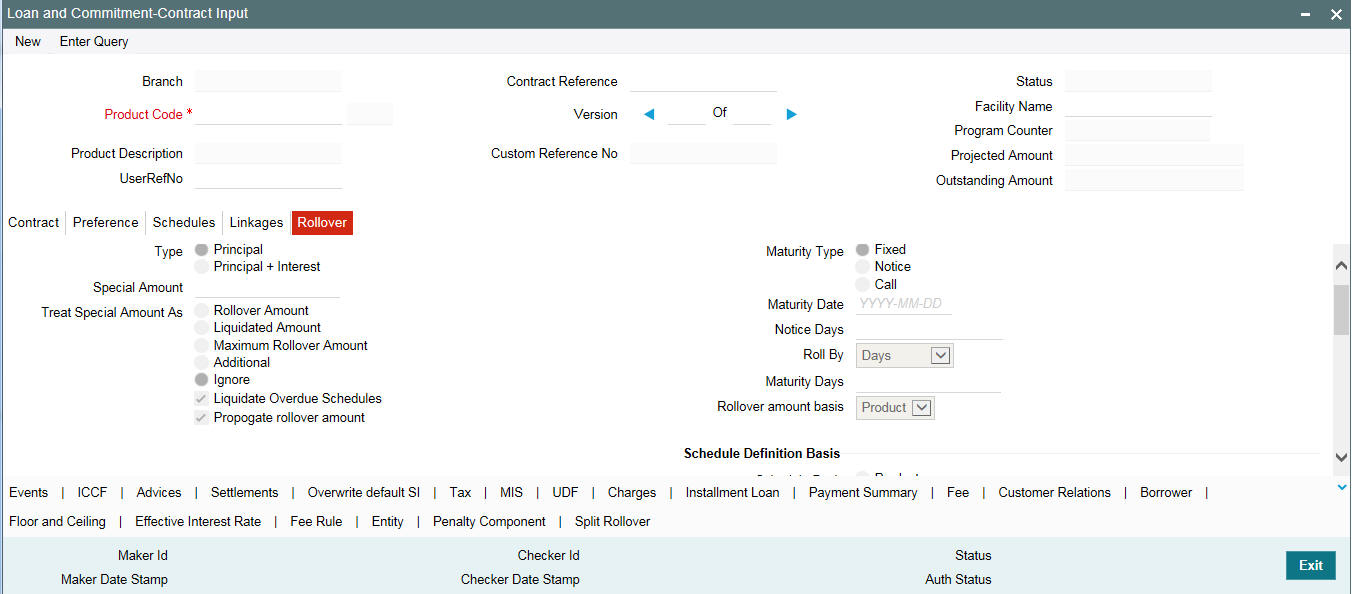

You can rollover a loan in the ‘Loans and Commitment – Contract Input’ screen. In the ‘Loans and Commitment – Contract Input’ screen, click ‘Rollover’ from menu.
At the time of contract creation, you can maintain/change the rollover instructions. Click ‘Rollover’ tab to rollover a contract maintain/change the rollover instructions. You can specify the rollover instructions for the rolled over contract. After specifying the rollover details, you need to save the contract.
When you rollover the contract, the system completes the rollover process with the specified rollover instructions and a new version is created for the event ROLL.
To authorize the rolled over contract, both the versions created during rollover have to be authorized simultaneously.
By default, a contract is rolledover with all the terms of the original contract. However, you can change certain terms by specifying them in the Rollover Details screen while creating and modifying a contract.
The following are the features of the contract rollover screen:

If you specified that the principal of the new loan is meant to be a special amount you also have to indicate the manner in which the special amount is to be treated. You can choose any one of the following options:
The amount that is rolled-over depends on the treatment that you specify. You can choose not to treat the special amount in a specific manner by choosing to ignore this option.
Rollover Amount
If the outstanding amount is 20,000 and the special amount is given as 25,000 the additional 5000 gets added to the loan.
If the outstanding amount is 30,000 and the special amount is given as 25,000 the additional 5000 gets liquidated.
Note
The Outstanding Amount is the sum of all the components put together.
Liquidation Amount
If the outstanding amount is 20,000 and the special amount is given as 25,000 you are not allowed to rollover.
If the outstanding amount is 30,000 and the special amount is given as 5,000 the additional 5000 gets liquidated and only 25,000 is rolled over
Additional Principal Amount
Additional Principal Amount option can be selected only if the rollover is by special amount.
Note
Individual components are liquidated in the liquidation order.
Maximum Rollover Amount
If the outstanding amount is 20,000 and the special amount is given as 25,000 you can rollover the entire outstanding amount.
If the outstanding amount is 30,000 and the special amount is given, as 25,000 only 25,000 will be rollover and the remaining 5000 is liquidated.

If you have chosen the rollover method as “Split”, then you must enter the corresponding details for the split, in the Split Rollover Details screen. Click ‘Spilt Rollover’ in the Contract Online screen to invoke this screen.
You can only split loan contracts:
You can specify the following general rollover details for rollover splits, just as you would for a normal loan contract (as explained in previous sections):
When you indicate the rollover method as “Split”, the system creates multiple draw down contracts out of the original draw down contract. For each rolled over contract, the system generates a split number.
You must indicate preferences for these rolled over contracts in the Split Rollover Details screen.
You must indicate the following details:
The refinance rate for the contract split rollover contract Each of the split contracts inherits the interest components defined for the original contract. All the rate details defined for these interest components, in the original contract, such as the rate type, rate code (for floating rate components) interest basis, margin and spread, interest rate rounding components are inherited by the split contract.
If you have chosen the rollover method as “Consolidation”, then you must enter the corresponding details for the consolidation, in the Consolidation Rollover screen.
You can invoke ‘Consolidation Rollover’ screen by typing ‘OLDCOROL’ in the field at the top right corner of the Application tool bar and clicking on the adjoining arrow button.
In this screen, you must specify the reference number of the loan contract (commitment) which you want to consolidate with other loan contracts, as part of the rollover operation.
You can only consolidate loan contracts:
When you select the loan reference number, the product code for the loan is displayed. You can select the other loan contracts to be consolidated.
You must specify the following details for the consolidated rolled-over contract:
Maturity Details
You can indicate whether the consolidated contract has a fixed maturity date, or matures at call or notice. For contracts maturing at notice, you can indicate the applicable notice days.
Note
For fixed maturity type contracts, you can specify the maturity date. For fixed maturity type contracts, you can specify the number of days to be added to the value date to arrive at the maturity date. You can select all the future dated maturity contracts greater than or equal to the value date. That is you can select future maturity contracts along with the matured contracts.
For the future date maturing contracts, the system liquidates the interest amount accrued till date and contract gets liquidated. Based on the amount settled till date, the interest amount is settled and future date schedules are deleted. In addition, ROLL event is fired and accounting entries are passed for ROLL event for different maturity contracts.
Schedule Basis
You can indicate whether the repayment schedules for the consolidated contract must be defaulted from the loan product or from the driver contract.
The Mode of Rollover
You can indicate whether the rollover consolidation must be initiated automatically for the selected contracts. The mode of rollover also depends on whether the mode of liquidation of the loan is automatic or manual. This preference can be set just as you would do for a normal rollover, as explained in previous sections.
Settlement Basis
You can indicate whether settlement details for the consolidated contract must be defaulted from the loan product, or the driver contract
MIS Basis
You can indicate whether MIS details for the consolidated contract must be defaulted from the loan product, or the driver contract,
UDF Basis
You can indicate whether user-defined fields for the consolidated contract must be defaulted from the loan product, or the driver contract.
Refinance Rate
You must indicate the refinance rate for the consolidated contract.
Holiday Treatment
You can indicate whether the system must check for maturity dates of the consolidated contract falling on holidays.
If the holiday check is indicated, you can also specify whether maturity dates falling on holidays must be moved forward to the next working day, or backward to the previous working day. You can also indicate whether the moved maturity date is allowed to cross over months.
Interest Components for the Consolidated Contract
You can define the interest components to be applicable for the consolidated contract.
The interest rate can be defaulted from either the loan product, or the driver contract, or a special rate can be entered. If a special rate is to be entered, you can specify the required rate in the Rate field.
Consolidation Preferences for Driver Contracts
As part of the preferences for the consolidation contract, you can identify contracts from which information such as settlement details, schedules, MIS details and so on, can be defaulted. These contracts are called driver contracts. You can select the contracts to be used as driver contracts, in the Participant Ref No field.
You must specify the following details for the driver contracts:
