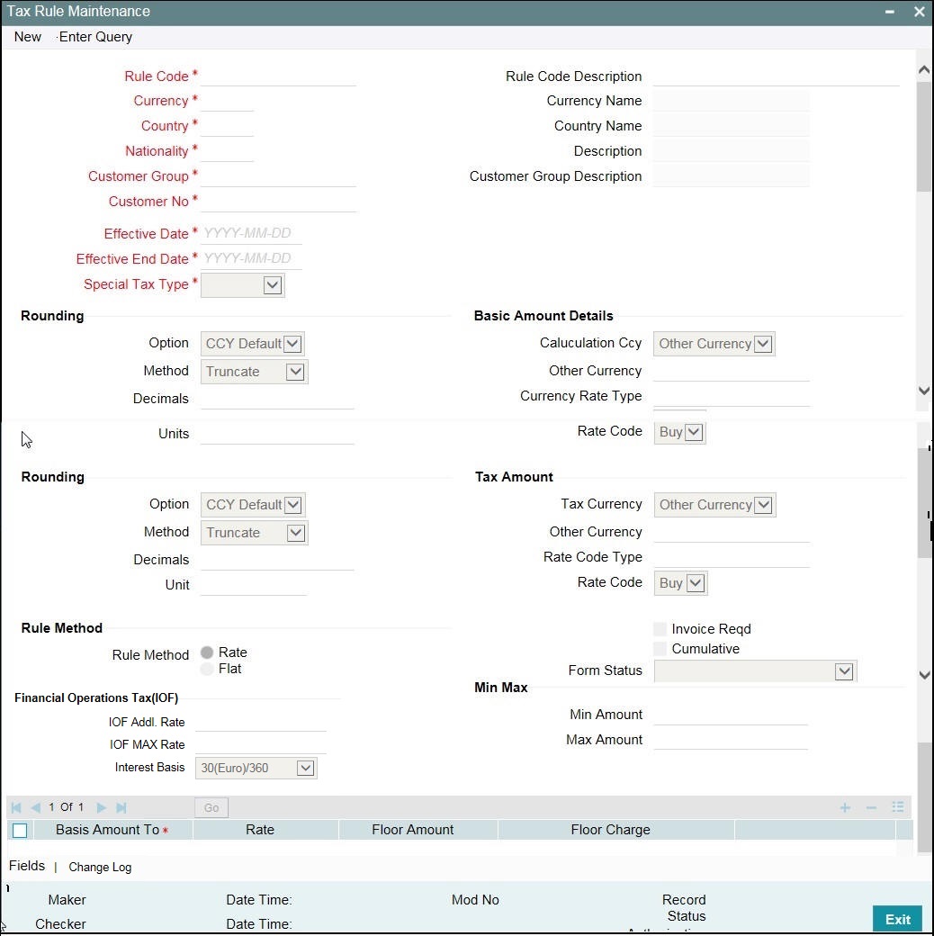

You can invoke the ‘Tax Rule Maintenance’ screen by typing ‘TXDRULES’ in the field at the top right corner of the Application tool bar and clicking the adjoining arrow button.
Rule Code
Specify the valid tax rule ID that you maintain in your bank. The adjoining option list displays the list of all rule IDs available in the system. You can select the appropriate one. These rule IDs are fetched from 'Rule Master Definition' screen.
The tax rule is maintained for a combination of Rule ID + Currency + Country +Nationality + Customer Group + Customer Number + Effective Date.
Rule Code Description
The ‘Rule Code Description’ appears based on the rule id.
Currency
The currency selected indicates the transaction currency. You also have the option to select ‘ALL’ to indicate that the rule is applicable to transactions in any currency. It is mandatory to specify the currency to save the Tax Rule.
Then define the attributes of the rule, such as the Effective Date, the Tax Currency and the application method.
Building a Tax Rule specific to a Customer Group
You have maintained Charge and Tax type of customer groups through the ‘Customer Group Maintenance’ screen and categorized customer’s into different Charge and Tax groups through the Customer Information Maintenance screen.
While building a tax rule, you can indicate whether the rule is to be made applicable on a charge type customer group or whether it is to be made applicable on a tax type of customer group.
If a transaction charge/tax is defined for a Charge/Tax type of customer group, the transactions involving customers in the group automatically acquire the charge/tax unless you choose to override it by creating a specific charge/tax set-up for the particular customer.
Customer numbers are maintained by your bank in the ‘Customer Information Maintenance’ screen. You can choose the customer for whom the tax rule is being defined. You could also choose to define the tax rule for all the customers of your branch.
Specifying the Effective Date for a Tax Rule
Every tax rule is associated with an ‘Effective Date’. On the specified Effective Date, the rule becomes applicable. When more than one rule is linked to a Tax Scheme, a rule is applied till the next rule for the same component, with a different Effective Date comes..

Special Tax Type
Select the special tax type from the drop-down list. The list displays the following values:
The basis amount refers to the taxable amount, that is, the amount on which tax is applicable. You have to maintain the following details for the calculation of the basis amount and the tax amount:
Calculation Currency
You have to indicate the currency in which you would like to express the basis amount.
The following options are available:
The basis amount can be calculated in either the currency of the contract (Deal Ccy) or you can express it in any other currency (Other Ccy) of your choice. If you choose the ‘Other Currency’ option, you have to specify the currency in the next field. All valid currencies of your bank are displayed in the option-list provided. Select the currency of your choice from this list.
When a rule for which the basis amount should be calculated in local currency, is applied on a contract involving a foreign currency, the local currency equivalent of the contract amount (in foreign currency) is considered. The exchange rate type and rate code maintained for the basis amount is used for the currency conversion.
Tax Currency
This is the currency in which the final tax amount is computed. The options available for the Calculation Currency are applicable to the Tax Currency also.
If the basis amount calculation currency is different from the tax currency, the system first computes the tax amount in the basis amount currency. The amount is then be converted to the tax currency by applying the exchange rate type and rate code maintained for the tax amount.
Rate Type and Rate Code
If you specify a Basis Amount/Tax Amount calculation currency that is different from the Contract Currency, you have to indicate the type of exchange rate that you would like to use for the currency conversion. The basis amount/taxable amount is first converted to the calculation currency and then tax is computed on it. Subsequently, the tax amount, which is now in the basis amount currency, is converted to the tax currency.
For example, you may have defined a ‘Central Bank Rate’, a ‘Standard Rate’, a ‘Cash Rate’, a ‘Travelers Check Rate’, and so on. In Oracle Lending, these rates are referred to as ‘Rate Types’.
For the rate types, you would have maintained different rate codes. The rate type should be used in conjunction with the rate code to determine the exchange rate. The following options are available:
Rounding Option
The following rounding options are available:
If you select the ‘Currency Default’ option, the subsequent rounding preferences (Method, Decimals, and Units) maintained for the basis amount calculation currency (in the Currency Definition screen) is applicable to the Tax Rule being defined.
You may select the ‘ Specific’ option, to maintain rounding preferences specifically for the Tax Rule that is being defined. If this option is selected, the subsequent rounding details should also be maintained.
Rounding Method
Rounding Method refers to the method to be followed for rounding off amounts expressed in this currency:
Truncate - The amount is truncated to the number of decimals specified for the currency.
Round Up to the Nearest Rounding Unit -The amount is rounded up based on the number of decimals and the nearest rounding unit.
Round Down to the Nearest Rounding Unit - The amount is rounded down based on the number of decimals and the nearest rounding unit.
Round Near - The amount is rounded either up or down to the specified number of decimal places and units, Depending on whether the next decimal place exceeds or is less than 5.
Rounding Units
If you have selected ‘Round Up to the Nearest Rounding Unit’ or ‘Round Down to the Nearest Rounding Unit’ in the Rounding Method field, indicate the nearest unit to which the rounding should take place. The number of units specified here should not be greater than the number of decimals allowed for the currency.
Example 1
| Amount before Rounding | Rounding Method | No. of Decimals | Rounding Unit | Amount after Rounding |
| 1234.678 | Truncate | 2 | - | 1234.67 |
| 1234.678 | Round up to the nearest rounding unit | 2 | .01 | 1234.68 |
| 1234.678 | Round down to the nearest rounding unit | 2 | .01 | 1234.67 |
Example 2
Decimals
The number of decimals allowed for any amount in the currency is entered here.
Note
If you have expressed the basis amount, the transaction amount and the tax amount in different currencies, the rounding preferences is applicable only after the currency conversion has taken place.
The following example shows the sequence that is followed.
Example
Assume that you have maintained the following:
The currency conversion rates and rounding options are applied in the following sequence:
Indicating whether Invoicing is required for Tax Rules
While building Tax Rules you can specify whether you would like to enable the invoicing feature by selecting the box positioned next to the ‘Invoicing Reqd’ field.
As a result, each time tax is deducted for contracts involving this rule, the system links the next available invoice number and current order number to the tax details. The invoice number and current order number are picked up from the current range maintained for your branch in the Invoice Range Maintenance screen.
Form Status
Select the form status from the predefined list provided here:
If 'Special Tax Type' is selected as 'Financial Operations Tax', then you need to maintain 'IOF Additional Rate', 'IOF Max Rate', and 'Interest Basis'.
A tax can be a percentage of the component that is to be taxed (such as the principal, brokerage, and so on.), or a flat amount. If you choose to calculate tax as a flat amount, choose the Flat option. If you choose to calculate tax as a percentage of the transaction amount, choose the Rate option. If tax is to be calculated as a flat amount, specify the flat amount.
Specifying the amount limits for a tax rate
If you have specified a percentage of tax for the rule, you should also specify the maximum and minimum amounts, in the local currency, within which the amount calculated using the tax rate should fall.
Example
For tax rule TX01, you have maintained the following details:
| Code | TX01 |
| Tax Currency | Local CCY |
| Tax (Type) | Rate |
| Rate | 1.5 |
| Min. Amount | 1,000 |
| Max. Amount | 10,000 |
This tax rule is applied on a securities deal. The deal currency is USD and the local currency is EUR. The exchange rate between the two currencies is 1.9 (where 1.9 units of USD are equal to 1 EUR). The amount involved in the deal is 90,000 USD and tax has to be paid in EUR. Assume that tax is levied on the deal amount in your country.
Before tax is applied on the deal, the minimum and maximum amounts are converted into the deal currency (USD) as follows:
The tax amount for this deal is calculated as follows:
90000 * 1.5/100 = USD 1, 350 (tax amount in deal CCY)
Tax amount in Local CCY = 1350/1.9 = 710.52 EUR
As this amount is less than the Minimum (Tax) Amount specified for this tax rule, a tax of 1000 EUR will be levied on the deal, instead of 710.52 EUR. On the other hand, if the tax calculated was more than the maximum tax amount, 10,000 EUR would be applied as tax, since that is the maximum possible tax that can be levied.
If you have specified a flat amount for the tax rule, then you need not specify the minimum and maximum amount limits.
Note
The minimum and maximum limits apply for specific rules linked to a Tax Scheme, and not for the entire scheme.
You can define the tax that you would like to apply to a contract, in terms of a tier or a slab structure.
Through this screen, first specify if the Basis Amount (on which tax is calculated) should be taken as a slab or a tier. Indicate ‘Cumulative’ (by selecting the check box), if the Basis Amount structure is a Tier. Leave it blank if the Basis Amount structure is a Slab.
The following example illustrates how this works:
Example
You have the following Amount Basis (cumulative) structure for a Tax Rule defined for tax on the deal amount:
| Amount | Rate |
| 0 to 250,000 | 1% |
| > 250,000 <= 1 Million | 2% |
| > 1 Million <= 3 Million | 2.5% |
| > 3 Million | 3% |
When this tax rule is applied on a deal of USD 1.5 million, the rate of tax is calculated depending on whether the Amount Basis has been defined as a slab or as a tier. The different methods are calculated as follows:
Tier basis
The first 250,000 is taxed at 1%
Amount from 250,001 to 1,000,000 at 2%
Amount from 1,000,001 to 1,500,000 at 2.5%
Slab basis
The entire USD 1.5M is taxed at 2.5%

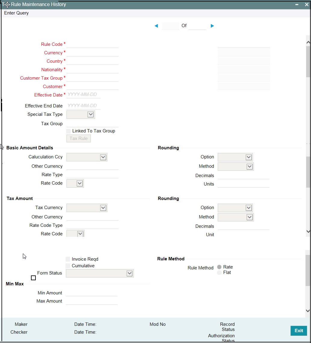

You can view the history of tax rule in the ‘Tax Rule Maintenance History’ screen.
You can invoke the ‘Tax Rule Maintenance History’ screen by typing ‘TXDRLHIS’ in the field at the top right corner of the Application tool bar and clicking the adjoining arrow button.

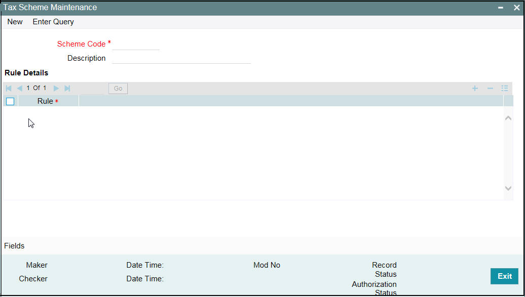

You can invoke the ‘Tax Scheme Maintenance’ screen by typing ‘TXDSCMNT’ in the field at the top right corner of the Application tool bar and clicking the adjoining arrow button.
Scheme Code
Specify the tax scheme that you are maintaining with a unique code. A scheme consists of several tax components (classes).
Description
Specify the description of tax scheme.
Rule ID
Specify the valid tax ‘Rule ID’ that you maintain in your bank. The adjoining option list displays the list of all rule IDs available in the system. You can select the appropriate one. These rule IDs are fetched from 'Rule Master Definition' screen.
A tax scheme is linked to a product, only if tax is applicable to the product. This linkage is established through the ’Tax Details’ sub-screen, of ’Loans and Deposits Product Definition’ screen. The tax scheme linked is applicable on a contract processed under the product by default. However, you have the option of waiving the application of tax, for a specific contract.
A tax rule represents the method in which a specific tax has to be applied. Thus, for a tax component to be levied on a contract, you should specify:
In addition, also specify the minimum and maximum amount of tax that can be applied for a specific rule.
A Tax Scheme can consist of a set of Tax Rules that can be applied to a product.
A Tax Rule defines the method in which tax has to be calculated. The amount based on which the tax has to be applied, is not specified for a Tax Rule. This definition is done when the Tax Scheme is linked to a product.
The system offers flexibility, in terms of specifying the method in which tax has to be calculated.
Example
In the LC product module, for one type of product, you could use a Tax Rule to apply tax on the commission earned from the customer while for another product, you can use the same rule, to apply tax on the LC amount.
A tax scheme is made applicable to a product when it is linked to the product. Once the tax scheme is specified for linkage, indicate:
Click ‘Tax’ from the ‘Loans and Commitment Product Definition’ (OLDPRMNT) screen to link a tax scheme to a product.
A tax scheme is linked to syndication loans products through the ‘Tax Details’ sub-screen, of ‘Loans Syndication - Facility Product Definition’, ‘Loans Syndication - Borrower Product Definition’ and ‘Participant Product Definition’ screens. The tax scheme linked is applicable on a contract processed under the product, only if tax is applicable to the product, which is captured in ‘Preferences’ sub-screen. However, you have the option of waiving the application of tax, for a specific contract.
Tax rules for the respective component have to be mapped in the 'LB OL Product & Component Mapping' screen ('LBDPCMAP' ) for seamless propagation of the tax component to the Bilateral Loans side

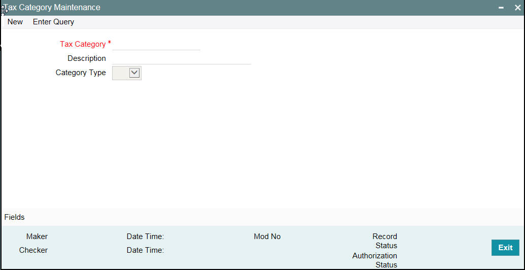

Specifying the Tax Category
You can specify tax category for each tax rule that is linked to a tax scheme. To do this, select the Tax category from the drop-down list against each Tax rule.
However, while processing a contract, you can waive the application only for those tax rules for which you have setup tax categories.

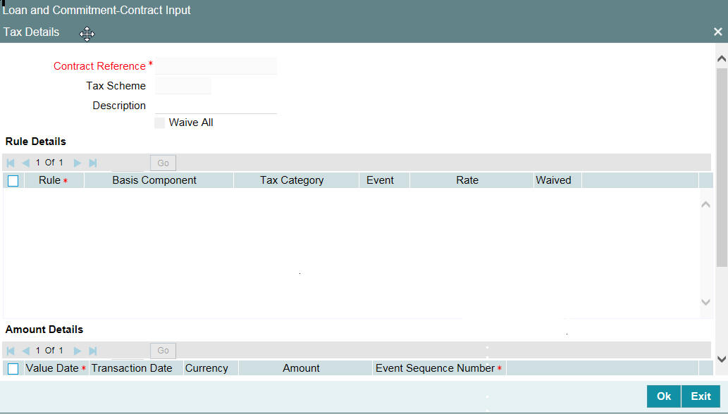

You can invoke the ‘Tax Details’ sub-screen from the ‘Loan and Commitment-Contract Input’ screen (OLDTRONL) while you are processing a contract.
You have a choice of waiving tax due to all the Tax Rule(s) linked to the Tax Scheme applicable to the product (and hence the contract) or that which is only due to specific Tax Rule(s).
Note
Only the tax that has not yet been liquidated can be waived.
While processing the contract, the system picks the waiver details from ‘Customer Tax Category Maintenance’ screen and Tax category details from ‘Tax Category Maintenance’ screen. Similarly the customer and customer tax category details are picked from Deal and Customer maintenance respectively. The value date specified in the deal is taken as the date for waiver check.
In Oracle Lending, the waiver information for Customer Tax Category, Tax Category, customer and effective date combination is searched in the following order:

Tax categories, along with a brief description of the category can be maintained through the ‘Tax Category Maintenance’ screen.
You can invoke the ‘Tax Category Maintenance’ screen by typing ‘TXDCATMT’ in the field at the top right corner of the Application tool bar and clicking the adjoining arrow button.
Specifying the Tax category
You can capture a unique code to identify the tax category.
Note
While maintaining product details and associating a tax category, a list of all the valid tax categories you have maintained in this screen are available in the option list for the Tax category field. You can select the appropriate code.
Assigning a brief description with the tax category
You can also associate a brief description with the tax category. This description is for information purposes only and not be printed on any customer correspondence.
Category Type
Here you can classify each tax category under Tax or IC. If the tax category is maintained under Tax, the categories are available at the product level for selection. However, the tax category maintained under IC are available only at the IC rule definition level. You need to calculate the tax on customer account balances.

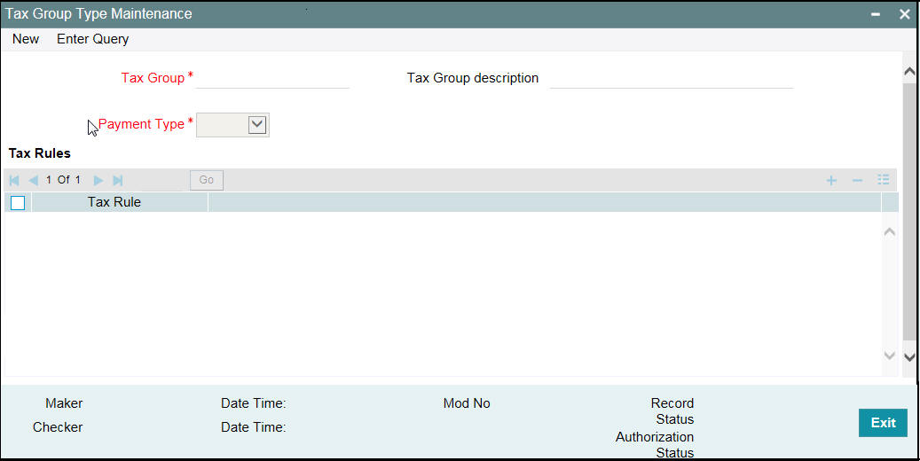

You can use the ‘Tax Group Type Maintenance’ screen to map the tax rule to tax group and payment type.You can perform the following operations in this screen:
You can invoke the ‘Tax Group Type Maintenance’ screen by typing ‘TXDTXGRP’ in the field at the top right corner of the Application tool bar and clicking the adjoining arrow button.
Tax Group
Specify the tax group to which the tax rule is to be mapped.
Payment Type
Select the payment type from the adjoining drop-down list. The list displays the following values:
Tax Rule
Specify the tax rule which is to be linked to the tax group. The adjoining option list displays all valid tax rules maintained in the system. You can select the appropriate one.
