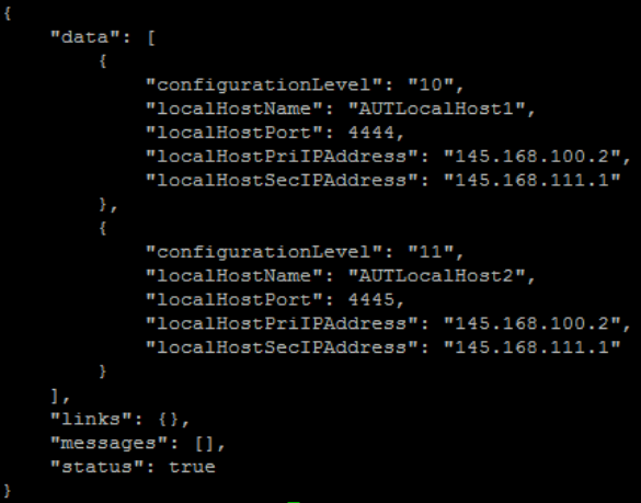

- To verify the vSTP MP Local nodes info:
- Log in to the SOAM VIP Server console as admusr.
- Run the following command
[admusr@SOAM1 ~]$ mmiclient.py /vstp/localhosts
- Verify the output similar to the below output.
Figure 4-1 Output

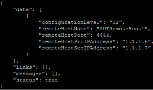

- To verify the vSTP MP Remote nodes info:
- Log in to the SOAM VIP server console as admusr.
- Run the following
command:
[admusr@SOAM1 ~]$ mmiclient.py /vstp/remotehosts
- Verify the output similar to the below output:
Figure 4-2 Output

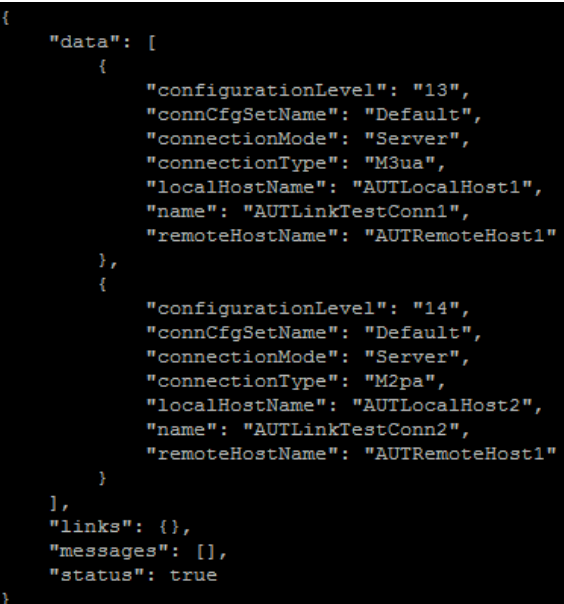

- To verify the vSTP MP Connections info:
- Run the following
command:
[admusr@SOAM1 ~]$ mmiclient.py /vstp/connections
Figure 4-3 Output
Figure 4-4 Output
- Run the following
command:
Figure 4-5 Output
- Run the following
command:
Figure 4-6 Output
Figure 4-7 Output
- Run the following
command:
- Run the following
command:
Figure 4-9 Output
Figure 4-10 Output
Figure 4-11 Output
Figure 4-12 Output
