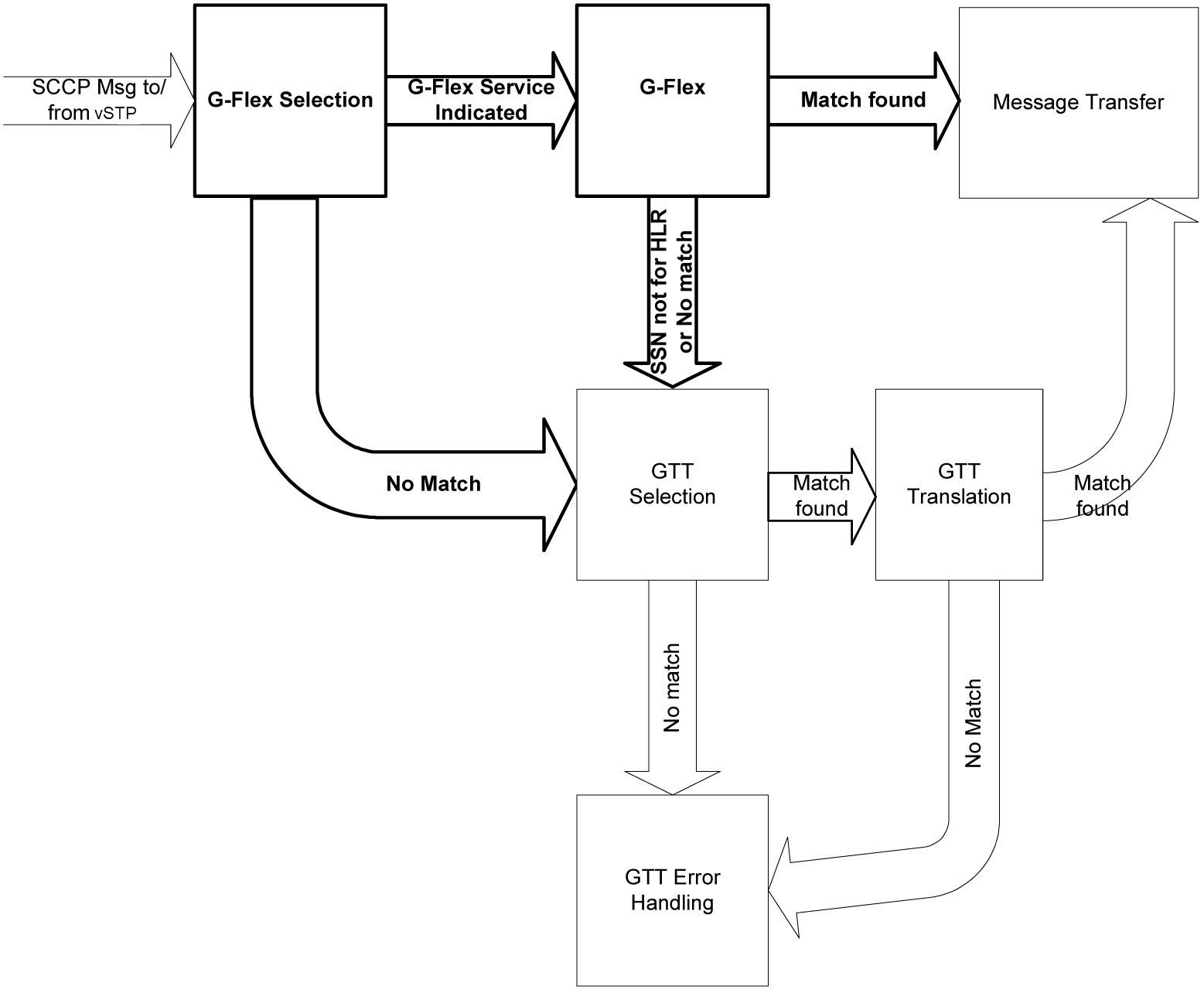

The following figure shows the basic functioning of SCCP, with the parts for G-Flex in bold:
Figure 6-3 G-Flex in SCCP
In order to keep the diagram simple, the only error conditions shown are the no-match cases for G-Flex and GTT selectors and translations. G-Flex has its own error handling for some cases that issues measurements and peg measurements appropriately before letting the MSU fall through to GTT translation. Also, there are error conditions in GTT selection, GTT translation, and message transfer that are handled by GTT error handling.
G-Flex Relay is performed in the following stages.
The message arrives at vSTP Route-on-GT. The vSTP decodes the SCCP portion and uses the data to perform G-Flex selection based on the CdPA GT fields other than the ES and GTAI. The result of this selection provides two pieces of data, identification of the NP and NAI for G-Flex and a G-Flex Service Indicator. The Service Indicator is G-Flex if G-Flex Relay is required. If a G-Flex selector does not match the incoming GT fields, then GTT selection is attempted. It is possible that G-Flex and GTT selectors will not match the incoming GT fields. In this case, GTT error handling is used.
If stage 1 indicates that G-Flex Relay is required and if the message is not a UDTS-generated by the vSTP, the vSTP performs SSN-based discrimination. If the G-Flex service state is ONLINE, then step 3 is performed. Otherwise, G-Flex SCCP Service Re-Route is performed.
The conditioned number is looked up in the GDB.
If the number is found, the translation data for the number is used to alter and route the message.
If G-Flex Relay is not required, or the number is not found in the GDB, the set of GTT translations is used for translation.
