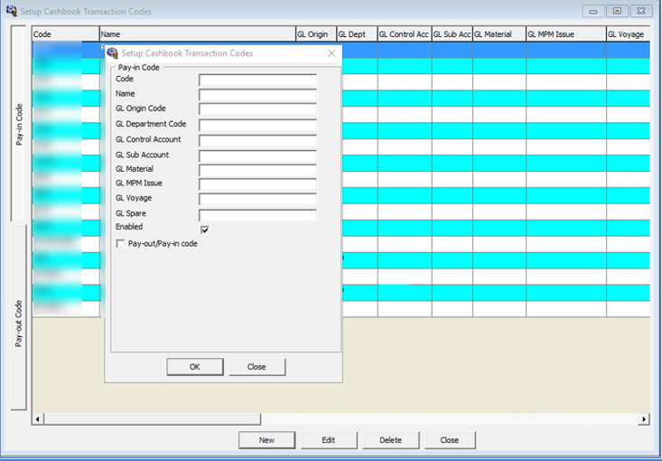

Transaction Codes Setup
Pay_in — Receiving Codes.
Pay_out — Expenses Codes.
