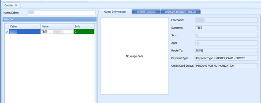

- At the Name/Cabin field, enter a name or cabin number and select the account from the search results.
- Go to the Guest Information tab to view the general information of the guest.

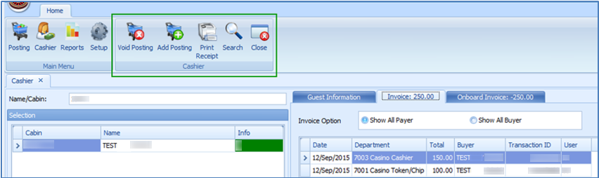

- Click the Invoice tab to view the Casino’s posting of the guest. This also enables the Cashier button at the ribbon bar, allowing you to perform posting from this.
- To view other postings of the guest, go to Onboard Invoice tab.
