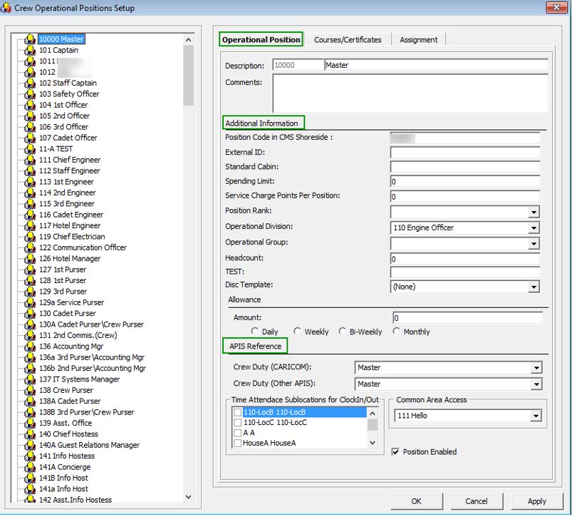

Operational Position Setup
An Operational Position is required in the Advanced Passenger Information System (APIS) for references and reporting, which is set up in the Administration module.
Figure 2-1 Crew Operational Position Setup
Log in to Administration module and select Crew Setup, Operational Position from the drop-down list.
Right-click and select Add to create a new Operational Position or select from the existing list.
Navigate to the Operational Position tab and enter the Position code, description and comment.
Under the Additional Information section, select the Operational Division from the drop-down list.
Define the Crew Duty (CARICOM) position
Define the Crew Duty (Other APIS) position
Click OK to save.

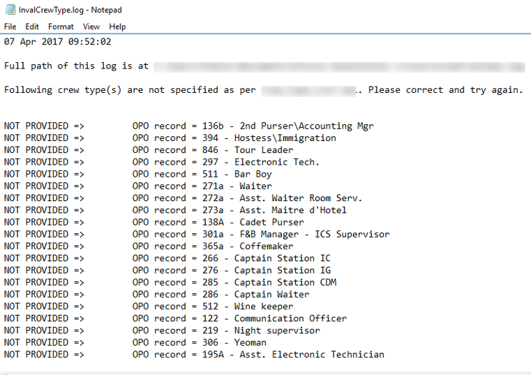

The system prompts an error message when opening the eBorderUK setup if a mismatch is found in the position or crew type maintained in the Administration module and the Crew Type.XML
file.
Ensure all the required Operational Position is in the XML file before generating the report. Click OK to continue.
Review and correct all the invalid data listed in the log file.
Figure 2-2 Sample Invalid Crew Record

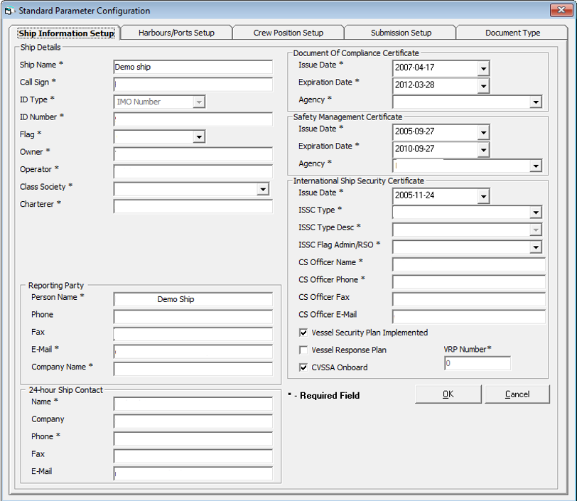

Ship Information Setup
To generate a report, you must first setup the Ship information in the EBorder UK application.
Figure 2-3 Standard Parameter Configuration Window
Run the EBORDER UK.exe.
Select EBORDER UK Setup from the EBORDER UK Transfer.
At the Ship Information Setup tab, enter the ship’s information.
Click OK to save.

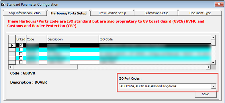

Port Setup
The Port Setup is differentiated by the symbols used and stored in the XML files. For example, the ISO Port Code for Dover has “#” and “<”. This means the ISO Port is shown in the Standard Parameter Configuration, Harbours/Ports Setup, ISO Port Codes and eNOAD Port. See the following table and figures for symbol use in the port setup.
Figure 2-4 Harbours/Ports Setup
Table 2-2 APIS Port Type and Symbols
Port Type | Symbol |
CARICOM Port |
eNOAD Port |
Panama Canal ADR Port |
eBorder UK Port |

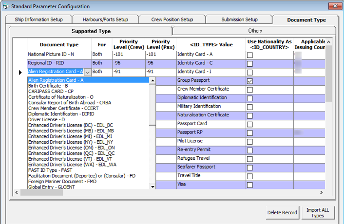

Document Type Setup
You must map the Document Types accepted in SPMS with a correct EBORDER UK code.
Log in to the Administration module.
Select Administration, System Codes and the Document Types from the menu option.
Select the document and in the APIS <ID_TYPE> Mapping field, enter the system coded document type. See Table A-1 for more information.
Click OK to save.
Document Type Layout
Figure 2-5 Document Type Layout
Table 2-3 Document Type Field Definition
Field Name | Description |
Document Type |
The type of document required by e-Border. |
For |
Select “Both” if the document type is applicable to crew and guest, or individually if it applies to only one type of passenger. |
Priority Level (Crew/Pax) |
Define the Priority level of the document if there is more than one type of document. The smallest number has the highest priority. |
<ID TYPE> Value |
Defines the value to default in the Manifest for the selected document type. |
Use Nationality As <ID_COUNTRY> |
Defaults the nationality country into |
Applicable Issuing Country |
The system checks the document against the issuing country and defines the country code for the document type. If it matches, if will then default the document details onto the manifest. Otherwise, it will be blank. |
At the Standard Parameter Configuration screen, select the Document Type tab.
Define the type of document required by E-Border by selecting the last row marked with a Aasterisk (*).
Select the Document Type from the drop-down list.
Click on the field to edit the row information if required. If the Nationality code is use as a Country ID, check the corresponding check box.
To remove a record, select the desired row and then click Delete Record.
